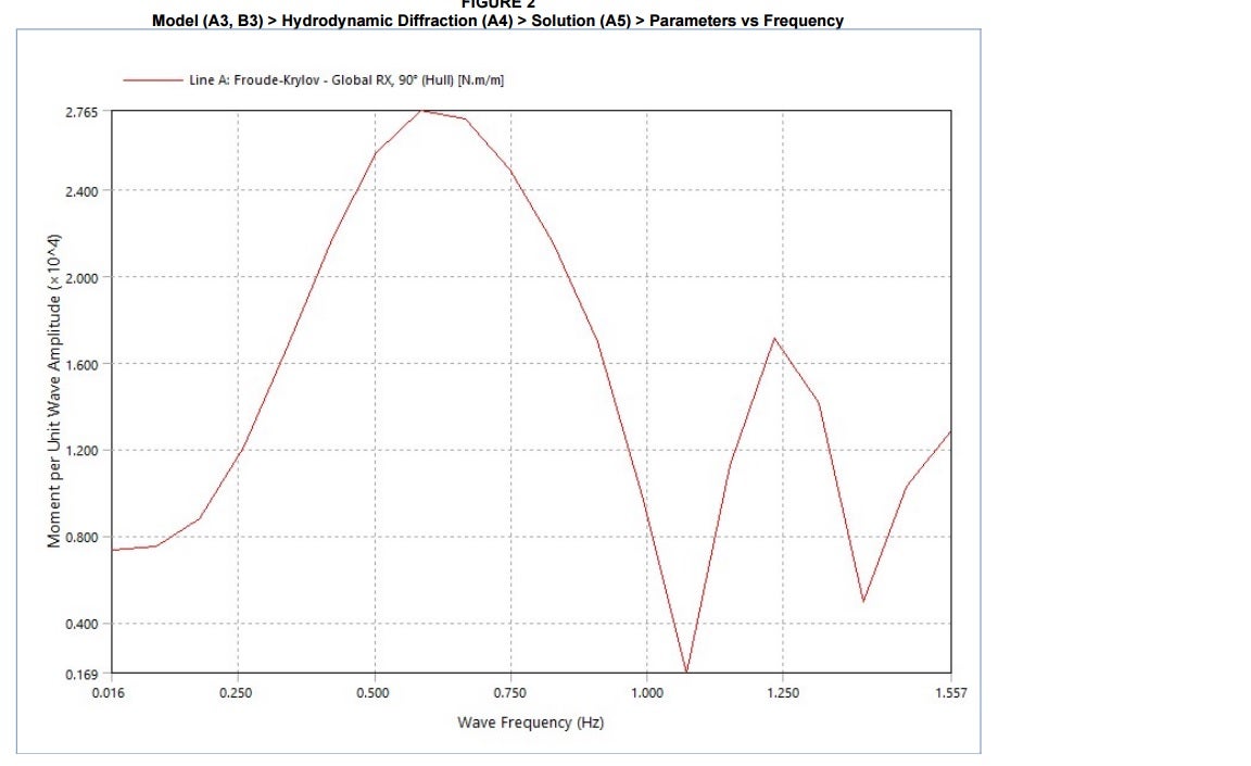

Ansys EmployeeThe ordinate title of the graph indicates that it is the amplitude of the moment (of the Froude-Krylov wave about x-axis in the wave direction 90 degrees) per unit incident wave amplitude.

SubscriberMany thanks for reply @sxdu
Okay, Do you know how to obtain only the froude-krylov moment? in case I don't know the incident wave amplitude -

Ansys EmployeeCan you explain what you want to have? The above graph gives the amplitude of the Froude-Krylov moment about x-axis due to the incident wave with the amplitude of 1 meter at the incident wave direction of 90 degrees for each incident wave direction.

SubscriberThanks for reply @sxdu
I just want to have froude-Krylov moment (N.m) not FK moment per unit amplitude (N.m/m) -

Ansys EmployeeAs the incident wave parameters (such as wave amplitude, wave direction and wave frequency) are known when you do the analysis, the Froude-Krylov moment (N.m) is the Froude-Frylov moment RAO (in the unit of N.m/m shown in your graph) timing the known incident wave amplitude.

SubscriberThe graph is obtained from hydrodynamic diffraction analysis, not hydrodynamic response, so there's no wave amplitude input.Â
Anyway, could you provide the equation used in calculating the Froude-Krylov moment in Ansys? -

Ansys EmployeeFor a time domain hydrodynamic response in irrgular waves, the irrgular waves are represented by the summation of the large number of wave components (including wave amplitude, frequency, direction, phase, see Aqwa Theory Manual, Section 2.1.2). The wave exciting force (summation of the Froude-Krylov force and the diffraction force) is given in the Aqwa thoery manual, equation 13.28
The amplitude of
in the above eqaution is the amplitude of Froude-Krylov foroce/moment RAO displayed in your graph. The phase of Froude-Krylov force/moment RAO will also be used in the above equation.Â
