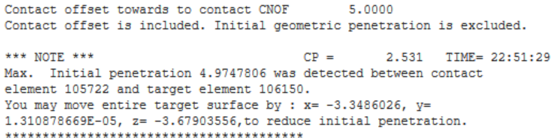

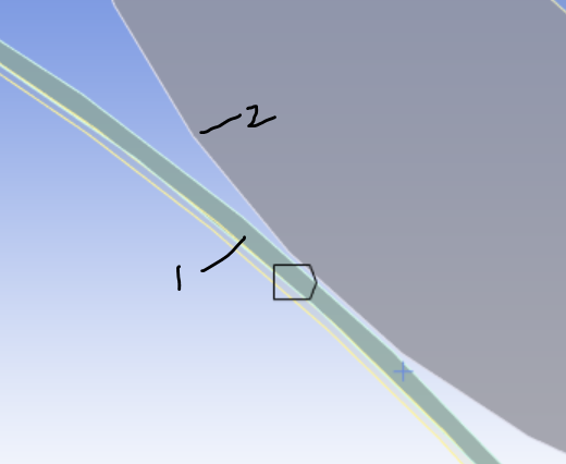

Subscriberhi, I have these two parts (1: Contact Body, 2: Target Body), with frictional contact between them. Partial view is shown below.
At the moment, I am able to simulate in transient ansys such that they 'adjust to touch'. Can I seek advise on how to simulate assuming part 1 penetrates/interferes with part 2 by 5-10 um.Â

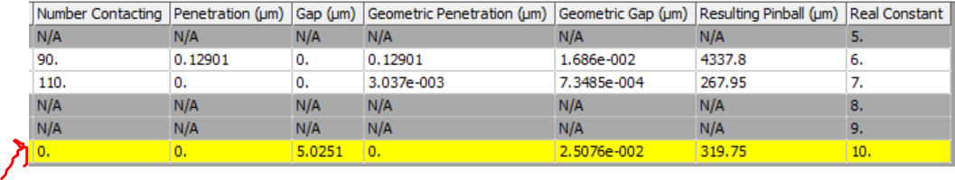

I tried to apply -5 um offset under interface treatment of frictional contact ( offset only, no ramping option). However, the contact status shows a gap instead of penetration as shown below.Â
Thanks for your help.
January 25, 2025 at 7:14 pm
peteroznewman
SubscriberInstead of -5 um of offset which opened up the gap, try using +5 um of offset to cause some interference.
January 26, 2025 at 2:49 pm
January 26, 2025 at 3:22 pm
peteroznewman
SubscriberThe solver only cares about Penetrations and Gaps which are measured using nodes and elements. Don't pay attention to Geometric Gap values. Add a Contact Tool to the Solution branch and measure the Pressure, Penetration and Gap with that tool. When there is an actual gap, it is reported with a negative sign. I don't know why the developers used this sign convention, just be aware that it is the opposite of what most people expect.

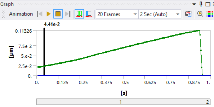

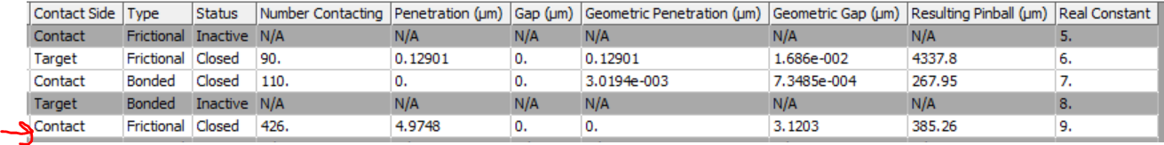

The penetration measured from solution branch is max 0.1123 um only though, that too at the end of load step. Shouldn’t it be 4.9748 um, that too at the beginning of load step, since the contact status (from initial information) shows that.Â
Even the solver information shows below msg
January 27, 2025 at 2:27 am
peteroznewman
SubscriberThe initial contact status reports the penetration that exists before the solver starts to search for equilibrium of the forces on the node and elements with closed contact contact status. The solver performs iterations, moving nodes around until it converges on equilibrium. Then it writes that converged substep into the result file. During convergence iterations, the penetration is going to be driven down to a very small value by defoming the material on either side of the contact pair. Ideally, there is zero penetration when convergence has been achieved. One contact formulation (Pure Lagrange) delivers zero penetration but the other contact formulations leaves a tiny amount of penetration which can be adjusted by editing the Normal Stiffness of the contact.

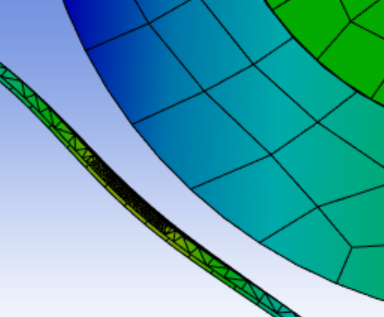

Also, i simulated with 10 um offset, the visual for deformation exhibits a gap at 0.5x scale as you may see below. The gap for contact status under solution doesn't show any gap too. Any way to rectify this?
January 29, 2025 at 12:04 pm
peteroznewman
SubscriberThe contact algorithm resolves an initial penetration detected in the initial state of the parts to drive it practically to zero when the offset value is set to 0.
Contact elements are skinned over the structural elements at the surface of the parts. Offset is used to move the contact elements on one side of the contact pair away from the structural elements. You entered a 10 um offset, so that is where the contact elements are placed and where the penetration is driven to zero and you see the 10 um gap between the structural elements that you requested by moving the contact elements out by 10 um. If you leave offset at 0 then you won't see a gap.
A use case that makes sense for using an offset value is in the example of the pin in the hole. Let's say that in CAD, the pin and hole solid bodies are both drawn at a 10 mm diameter. Rather than editing the diameter of the pin to be 10.02 mm before bringing it in to mesh, just bring them in with no geometric interference, create the contact pair and type in the radial offset of 0.01 mm and the contact algorithm will compress the pin and stretch the hole and you will see a 0.01 mm gap between the pin surface and the hole surface. The stress in the parts will be almost the same as if you had edited the pin diameter in the CAD system to be 10.02 mm.Â
