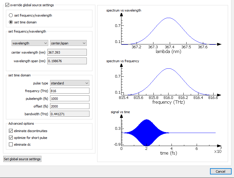

      Hi, I am simulating a simple fdtd simulation with a plane wave with no incidence angle and amplitude of 10^8 in free space.
      Then I visualize the results on a "frequency-domain field and power monitor" that is parallel to the axis of propagation.
      What should I expect to see?

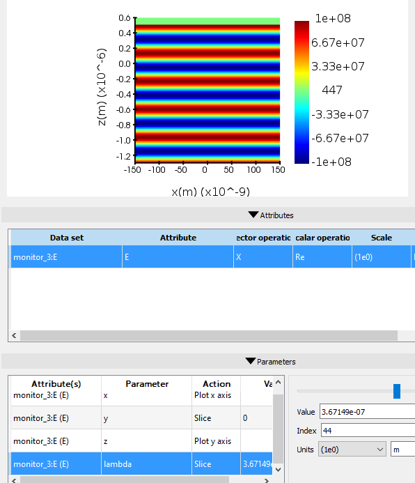

      I expect a plane wave when I look only at the wavelength of 367 nm but I have different results on the monitor:
      Why does a plane wave appear with wavelength of 317 nm, that has also an higher amplitude than the injected one?

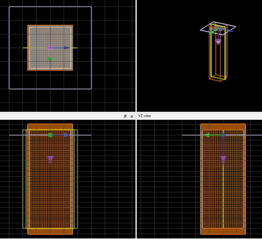

      Setup:
      Thank you

      What you expect is the amplitude but what you visualize is the real part.
      so you can visualize the amplitude, eg, choose Abs instead of Re.

      thank you for your answer but the problem is the same. I see an high amplitude also in the wavelength where no plane wave should exist, as you can see in the third picture. Why?
    • Guilin Sun
      I am not sure what do you mean "the problem is the same". I do not believe the Abs (absolute value) and the Re (real part) give the same result.
      As for " high amplitude also in the wavelength where no plane wave should exist", it is normal. Please check the source spectrum: when there is a pulse, it has much broader spectrum than what you specified in bandwidth. The latter is to ensure the intensity within the specified bandwidth is large enough to lead to accurate normalized result: Understanding frequency domain CW normalization
      Your result once again shows that we should only record and get the result within the source bandwidth, not outside of it. When the source intensity is small, dividing a small number can lead to large error.
