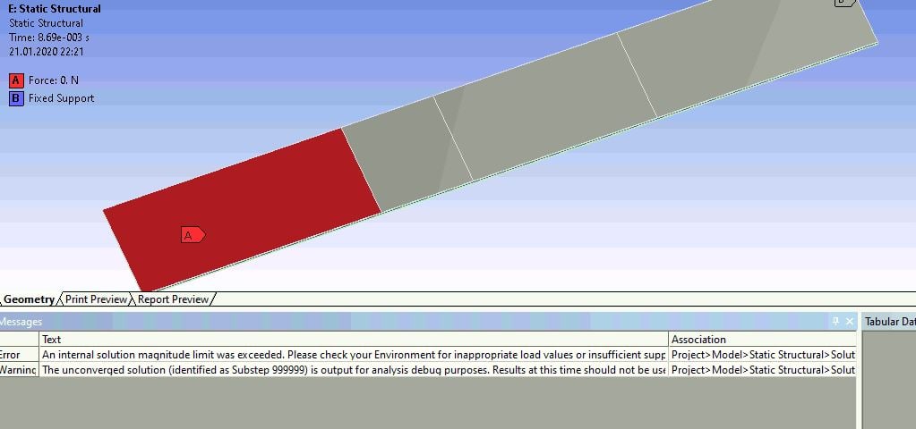

      ERROR: An internal solution magnitude limit was exceeded. Please check your Environment for inappropriate load values or insufficient supports.  You may select the offending object and/or geometry via RMB on this warning in the Message window.  Please see the Troubleshooting section of the Help System for more information.

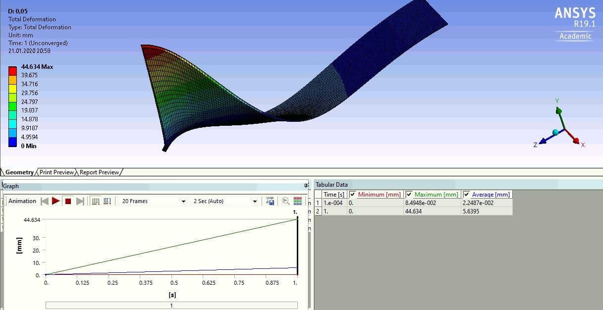

       Static analysis showed the error
      In Workbench, File, Archive to create a .wbpz file.  Attach that file to your post above.
      You should have a working Static Structural and Modal analysis before you spend time in Transient Structural.
    • Nurs134
      This is a link to download the archive
      https://drive.google.com/file/d/1R8VSAyjcni5_rJIRGFDefDEs3ptMxt_C/view?usp=sharing
      The problem with static structural was poor quality elements in the mesh and a force that was 100 times too high.

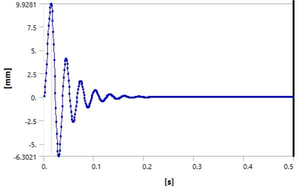

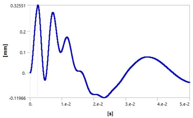

      Actually, the research is effect of changing the thickness of damping material. At the end of transient analysis, I need the result of the attenuation of displacement as in the picture. Then I will compare the duration of damped vibration for each thickness of the material. How to make such an analysis in transient solver?

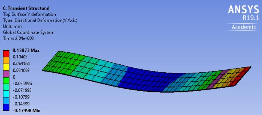

      Why mode 2? The graph you are showing looks like mode 1. Mode 2 is at 213 Hz while mode 1 is at 35 Hz so you will have to look for mode 2 within the oscillations of mode 1.
      Anytime you apply a hammer strike, it tends to excite all frequencies, so you will get mode 1 and mode 2 and higher modes all mixed together. It is difficult to excite only mode 2, you have to hit the beam with just the right combination of up and down force so as to cause it to deform into the mode 2 shape exactly.  It is easy to excite mode 1, because a tip load causes the beam to deform into the mode 1 shape.

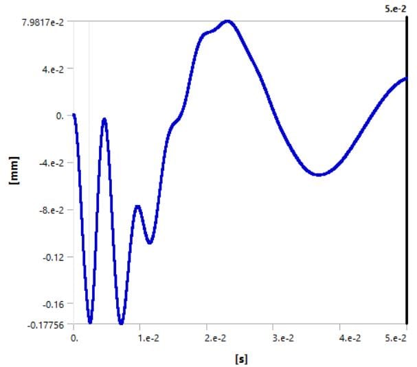

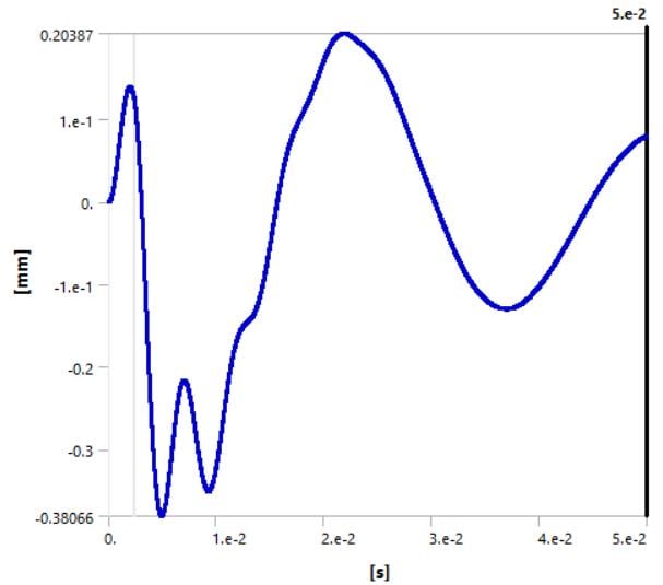

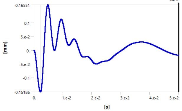

      In any case, I applied an up and down force at the middle and tip to get some mode 2 shape. The green/purple intersection is zero. I would use more tip force to get more of mode 2 in the response on the next try.
      Here is the graph of the tip Y deformation.
      Here is the graph of the center Y deformation.
      Notice that in the first few cycles, the tip goes up, while the center goes down (mode 2) but very quickly, mode 1 takes over and they start to go up and down together.
      I doubled the tip force and got much more of mode 2.
      Tip Displacement
      Center Displacement

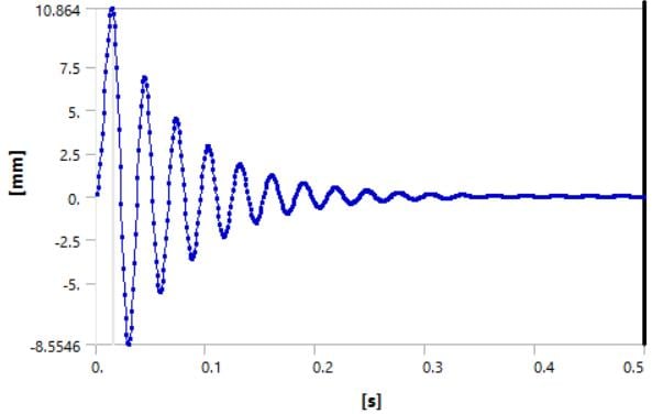

      Does it mean that I can see damped vibration after a hammer hit? I expected to see at the end of the graph the straight line which is at the calm condition. Or I should run simulation in a wider range of such as 3-5seconds?
      Yes, you can see the calm condition if you simulate, but it will be mode 1 vibration that lasts more than a few cycles.
      This plot has a damping ratio of 0.2
      This plot has a damping ratio of 0.1

      I used mode 2 due to I mixed up the hummer hit with harmonic vibrations. It is obvious that with hammer hit we can only excite 1mode. When I try to do analysis by inserting damping ratio value, simulation crashes
      Can you please upload a file with 0.2 and 0.1 dampings on the 1mode?
      There is only one file, I changed the Damping Ratio in the Engineering Data and did an Update on the Project page to get a second graph.
