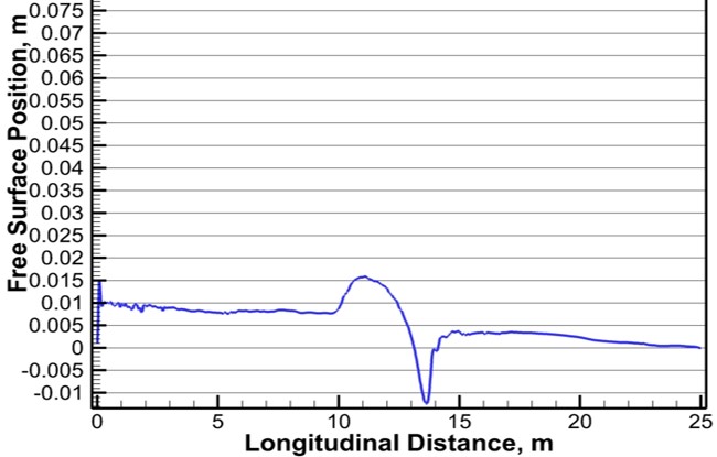

      We are using VOF model to simulate a river water flow over the water bed and also with a small
      pit (fish nest) in the middle of the no-slip bottom wall. Our flow domain has a very small tilt, with a
      3rd or a 4th decimal numbered slope.
      The boundary conditions are as shown in the schematic. Mass flow inlet or velocity profile inlet pressure outlet (hydrostatic pressure profile), bottom No-slip wall and the top boundary is symmetry.
      For such a simulation case, we are observing a few millimeters to centimeters unphysical jumps and
      oscillations in the free surface near the inlet above the water depth we specified. These
      jumps/oscillations gradually settle down further downstream. Below is a free surface plot, for a
      domain with a pit on the water bed from 10 to 14 horizontal distance.  This issue is there for either
      mass flow inlet or velocity profile inlet boundary conditions.  Note that the open channel flow
      model doesn't work for our case as we are investigating the effect of slope and other parameters
      effect but FLUENT open channel flow model enforces the gravity is always normal to the free
      surface.

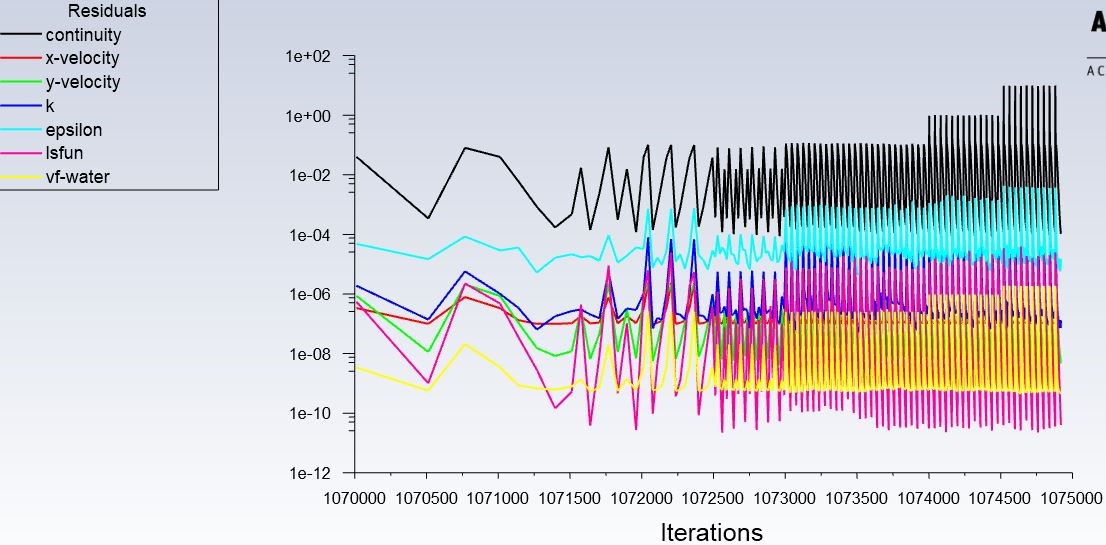

      The final residuals are shown in the figure below.   As for solver settings: we are using VOF-2 phase (surface tension = 0.072 N/m); realizable k-epsilon, SIMPLE or SIMPLEC scheme, 2nd order upwind scheme.     -Best,  Tao

      So, you have cycled the flow approximately 4 times through your computational domain. Interesting. And you simulation seems to be converging every time-step, which is good.

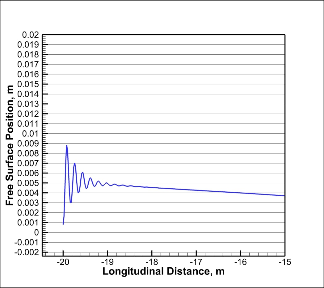

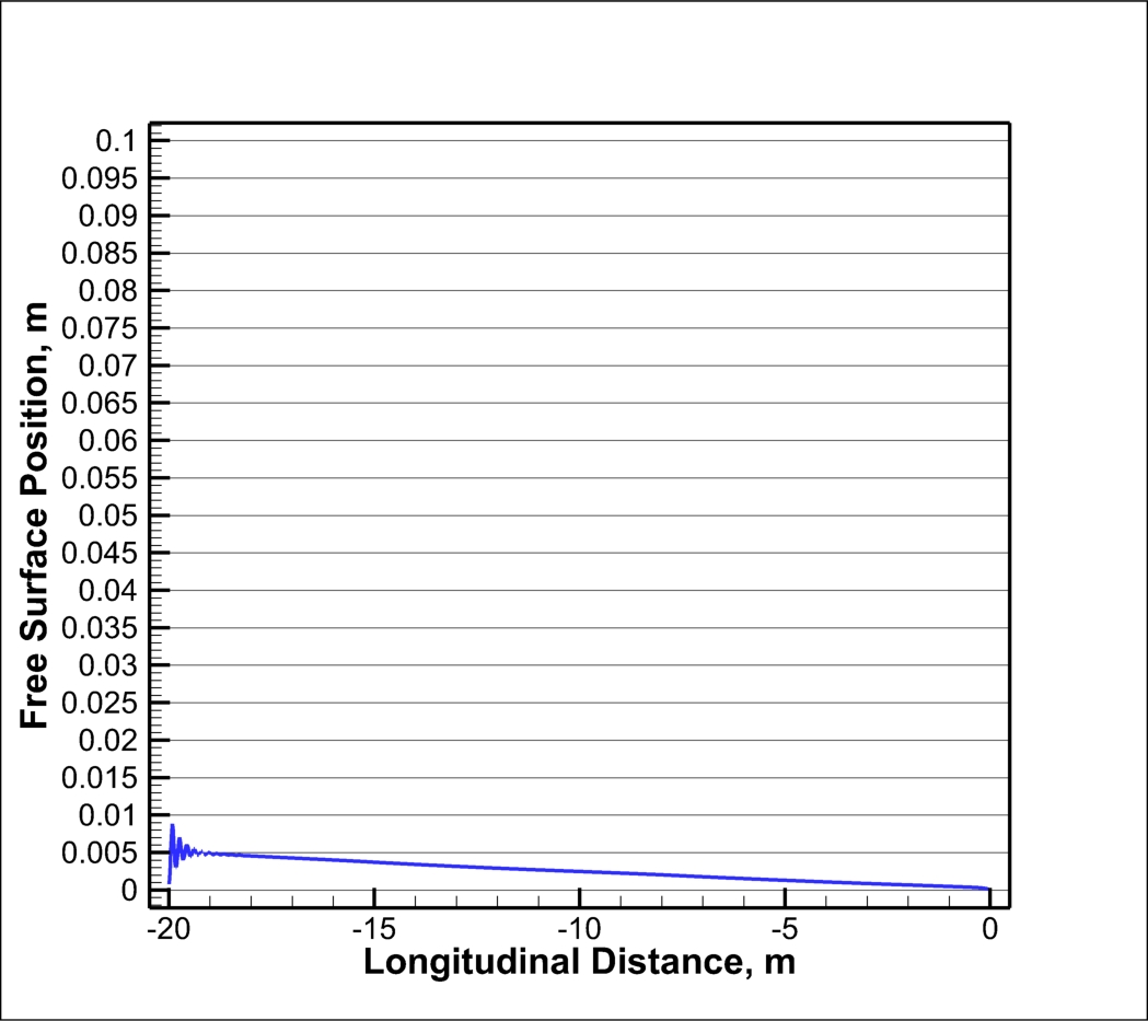

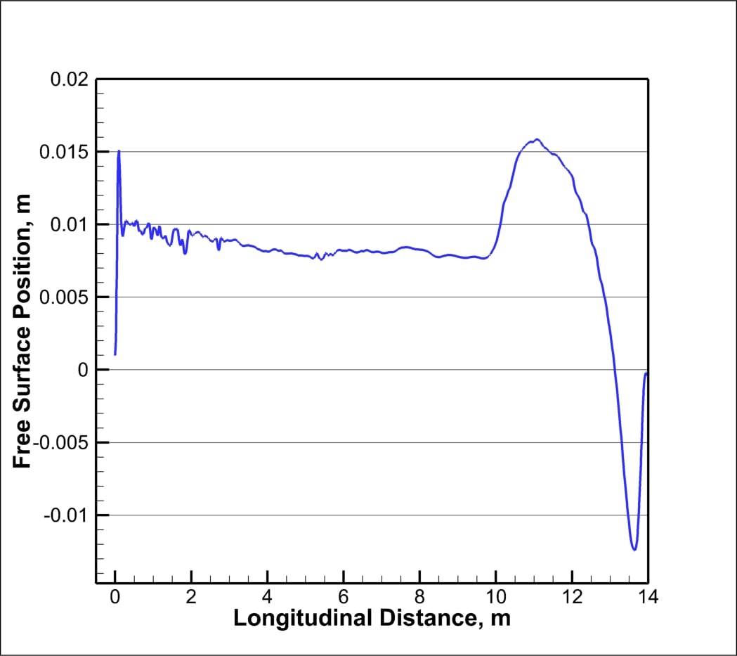

      The wave propagation is seen upto a few meters away from the inlet. I am attaching both with Redd (OR with Pit) and without Redd simulation results. Without Redd results shows clearer propagation effects whereas with Redd shows free surface fluctuations. Our question here is, "why is there a free elevation seen near the inlet (for both simulations) when we specify the free surface to be at Y= 0 at the inlet boundary?" (Note that the domain is tilted with an small angle).
      Without Redd full length
      Without Redd zoomed
      with Redd full length
      With Redd zoomed
      - We are applying mass flow water inlet [density*velocity*(Area = depth (2-D case))]. Same is used for the air inlet above the free surface inlet boundary. There are irregular spikes for Redd case as seen in the free surface plot.
      We are using Tecplot to obtain the free surface. In Tecplot, we can extract volume fraction = 0.5, that gives a periodic coordinates of the free surface across the length. Do they damp with time? - Like in the previous reply, this result is obtained from about 180 seconds of simulation time and the residuals looks like in the previous reply. The one without redd is from steady-state simulation after complete convergence.
      -Implicit Volume Fraction discretization is used.
    • Konstantin
      What are you using for pressure, PRESTO or body-force weighted? I'd suggest PRESTO if you are not using it already, it helps to eliminate spurious checker-boarding of the solution in multiphase problems. Another thought is the inlet is at a slight angle to the gravitational vector. Have you tried aligning it with g, i. e. if the inclination angle of the domain is zero, would you see the same spikes? If you let us know a representative velocity then it would be quick for us to check this in a 2D case.
