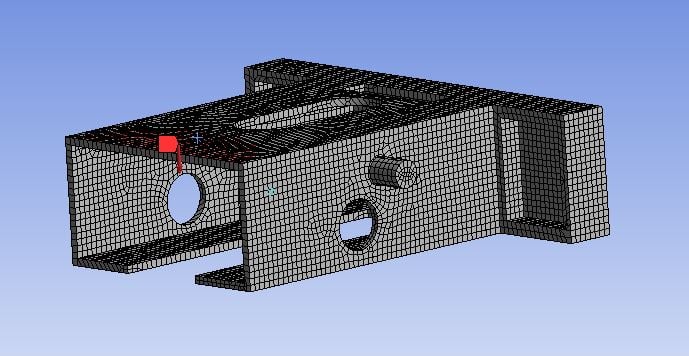

    • lrahimi
      Here is the maximum principal plot for the location of the welding of round bar to the wall. Should I report the maximum stress locations as the possible crack locations? or I should do a fracture analysis?
      Irahimi,
      Please show the supports and the loads on this model. Describe how the load changes during operation of that part in the machine.
      I can imagine two different machines. Machine "Z" uses that round bar to support a weight at its end, and that weight is applied and removed. Therefore the stress range is from zero to the value you show. There is no need to duplicate the model in this case. If the weight is never removed, then there is no fatigue possible unless there is some vibration.
      Machine "R" uses that round bar to support a force that goes to the right and then reverses and goes to the left. If the image above is for the force going to the right, you would duplicate the model and make the force go to the left.  Look at the location on the weld where the maximum of the Maximum Principal Stress was found in the force-to-the-right model and measure at that same location the minimum of the Minimum Principal Stress in the force-to-the-left model. The difference between those two values at that point is the stress range.

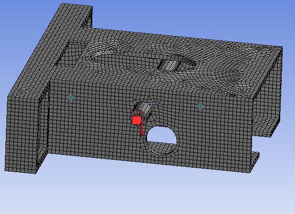

      So The way the loads are is that there is a downward force as shown in the following picture. And then there are two downward forces applied to the surface at the end of round bar (on both sides). This second force is cyclic. It can be present or not depending on the performance of the machine.

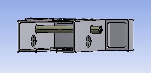

      Please show a screen snapshot of your geometry, including the Geometry branch in the outline, expanded so I can see how many bodies there are, and the mesh connection group.  Maybe it is deactivated because you only have one body?
    • lrahimi
    • lrahimi
      After you told me about how to build the weld bead I designed it in separate parts to be able to separate the weld and round bar from the rest of the body.
      Still it does not let me connect their mesh elements. I don't know why this option in not activated.
    • lrahimi
    • lrahimi
      I added shared topology in geometry and it is connecting mesh elements automatically now. I don't know what is the use of Mesh connection if I could have a shared topology do that for me. Maybe it's used for body-surface connections.
