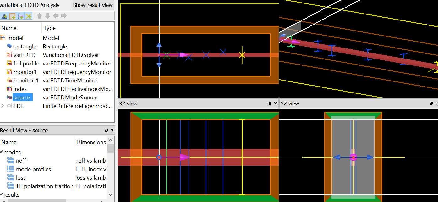

      I am trying to convert the four wave mixing example https://support.lumerical.com/hc/en-us/articles/360041718794
      into a straight waveguide to observe third harmonic generation and four wave mixing effects. However the simulation is not working when I analyze the transmission. The linear analysis seems fine. The nonlinear part of adjusting the source is the problem.
    • Guilin Sun
      I am not sure what exactly is wrong. I guess it is the enter wavelength? you can first set the wavelength in frequency domain, then set the parameters in time domain. Actually a simple way to do this is to directly copy the two sources from MODE to FDTD, by simply selecting them, then use Ctrl-C in MODE and in FDTD use Ctrl-V. Please try.
