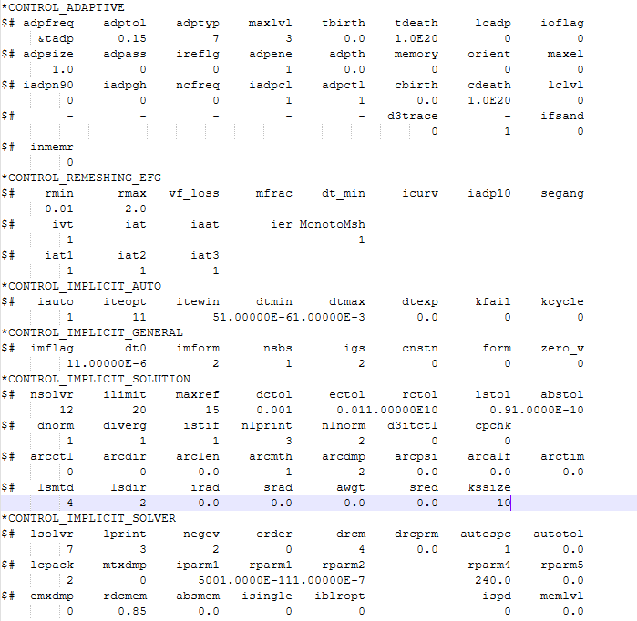

      Hello, I am running a cold forging simulation in LS-DYNA using the implicit solver, and I am experiencing a sudden solver termination before the end time.
      The workpiece is modeled using the EFG (Element-Free Galerkin) formulation (elform 42). At a certain stage of the forming stroke the solver stops abruptly due to negative volume error. I would like advice on which aspects of my model setup should be improved or reconsidered in order to solve the issue. I can post here some of the keywords I use:

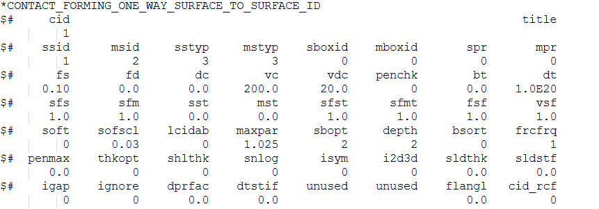

          Thanks for the information. Do you see any weird response at the contact interface? What type of contact are you using? Have you tried *CONTACT_FORMING_SURFACE_TO_SURFACE_MORTAR?
          Moreover, Are there any specific reasons you set IAT1-3 to 1 in *CONTROL_REMESHING_EFG? These are higher than the recommended values in the manual. Lower values may help prevent mesh distortion and negative element volume error.

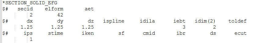

          Please also share a screenshot of your SECTION_SOLID_EFG card.

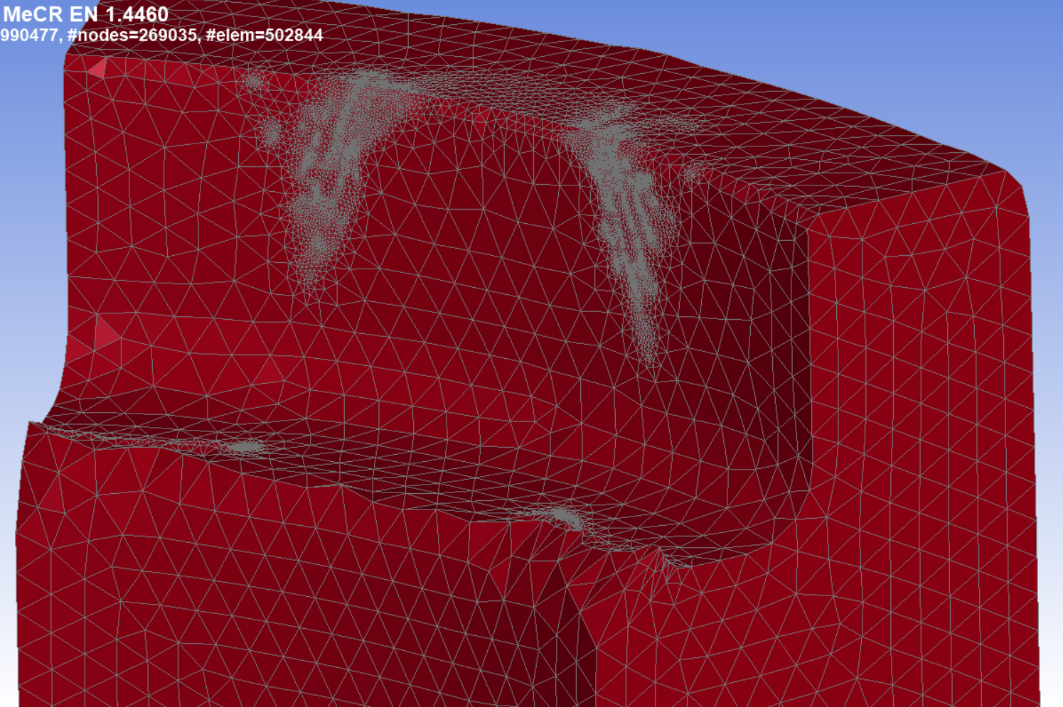

          At the contact between the tool and the billet I see some distorted elements, which do not remesh. Here is a picture
          Here a screen shot of the contact card.
          I also tried the MORTAR option with no luck.
          and here the section card
          Regarding the IAT values, I found an old example from LSTC where they used IAT=1. I will try with lower values. Thanks.
