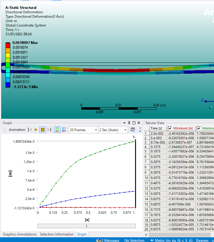

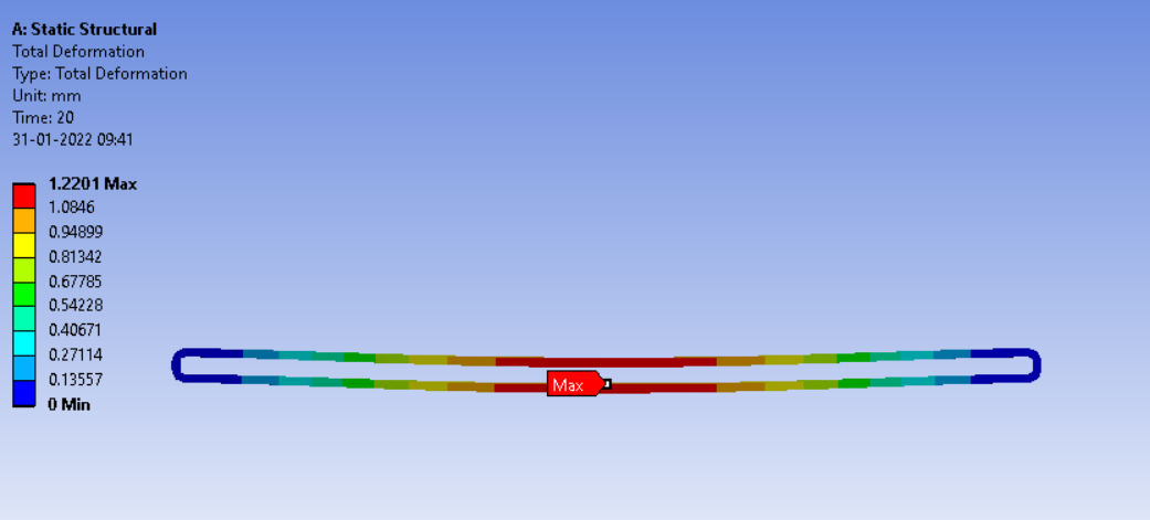

      I have a doubt regarding force transfer and resulting stress calculations. I have setup the simulation as per below images (The geometry is a single part). In the results, the final deformation is more than the initial gap between the 2 surfaces. Yet I couldn't see any stress on the 2nd surface (In the 4th image the stress is in MPa). 1st surface is actually penetraring the 2nd but still there is no force transfer.
      Is there any setting for that. Please help.

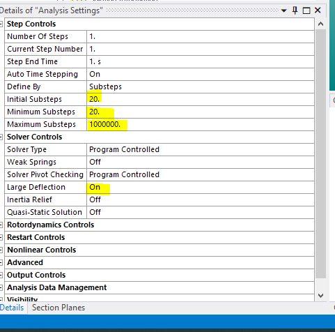

      Finally add many substeps in the analysis settings to properly capture the contact.
      (Use also large deflections/deformations).)

    • saumitramj
      Hello Erik Thank you so much for the answer! I tried your suggestions to define a contact between the 2 surfaces. I did a simulation using each type to see which one suits my requirement. For rough, frictional and frictionless contact, it still does not transfer any force (pinball radius is more than the initial gap). For no separation and bonded contact, 1st surface moves with the 2nd right from the start (as per below image). Also, I want to apply a contant force on the surface but as per suggestion I tried applying it in 20 steps. Do I need to add more steps?
      How do I define a condition where the force starts getting transferred right after the 1st surface touches the second surface due to deformation.
      I look forward to your guidance.
      Thank you.

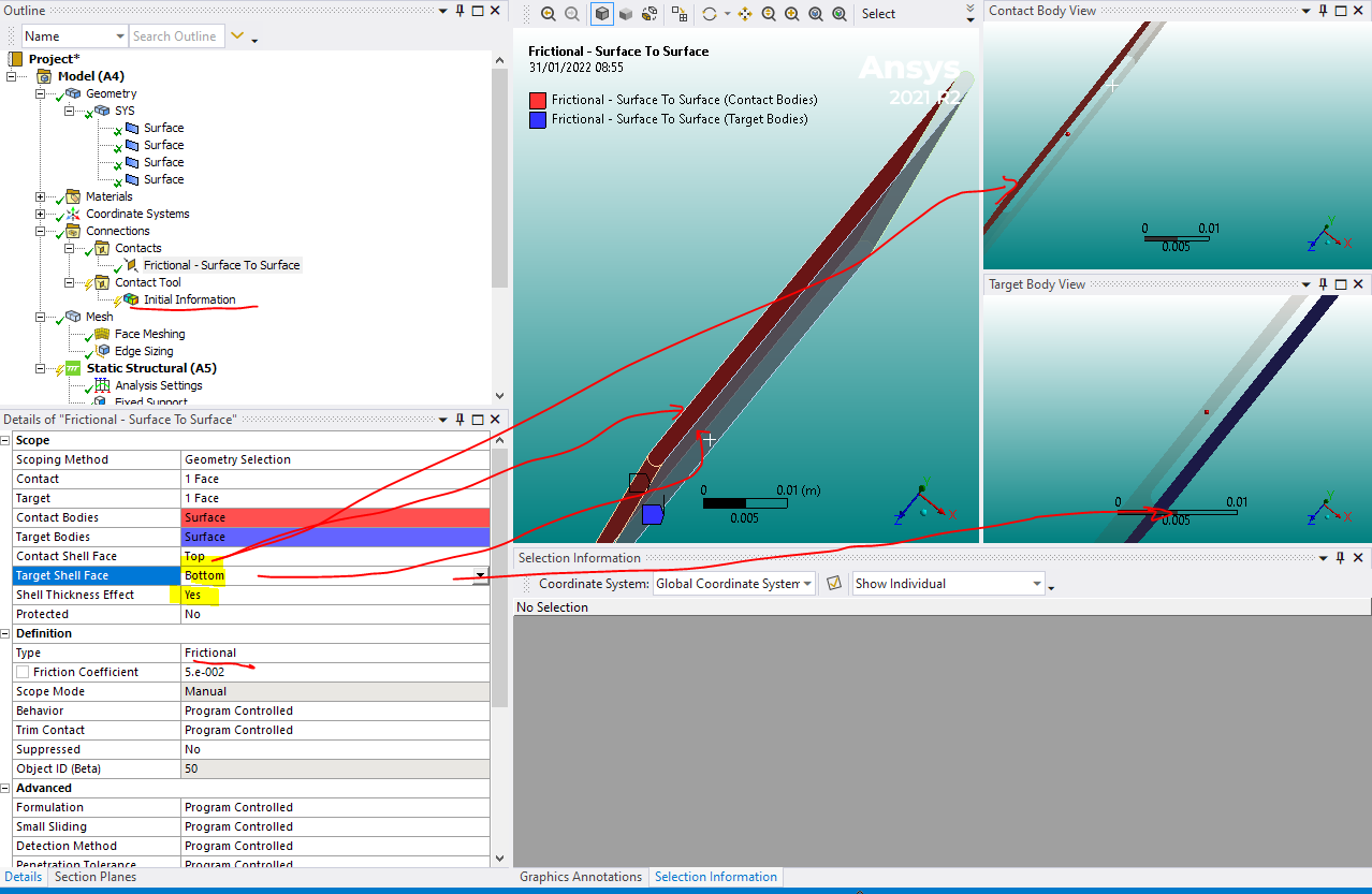

    • ErKo
      Hi
      As we said first go through the courses in contact as we suggested.
      Once you have understood the contacts settings (for frictional or frictionless contact), then use these below settings for the frictional contact between upper and lower plate faces which seems to work (especially important is the contact/target shell face option on the shell faces - they need to point towards each other, and you might need to change these settings compared to below, but they should point towards each other as shown - see below - the other settings are program controlled).

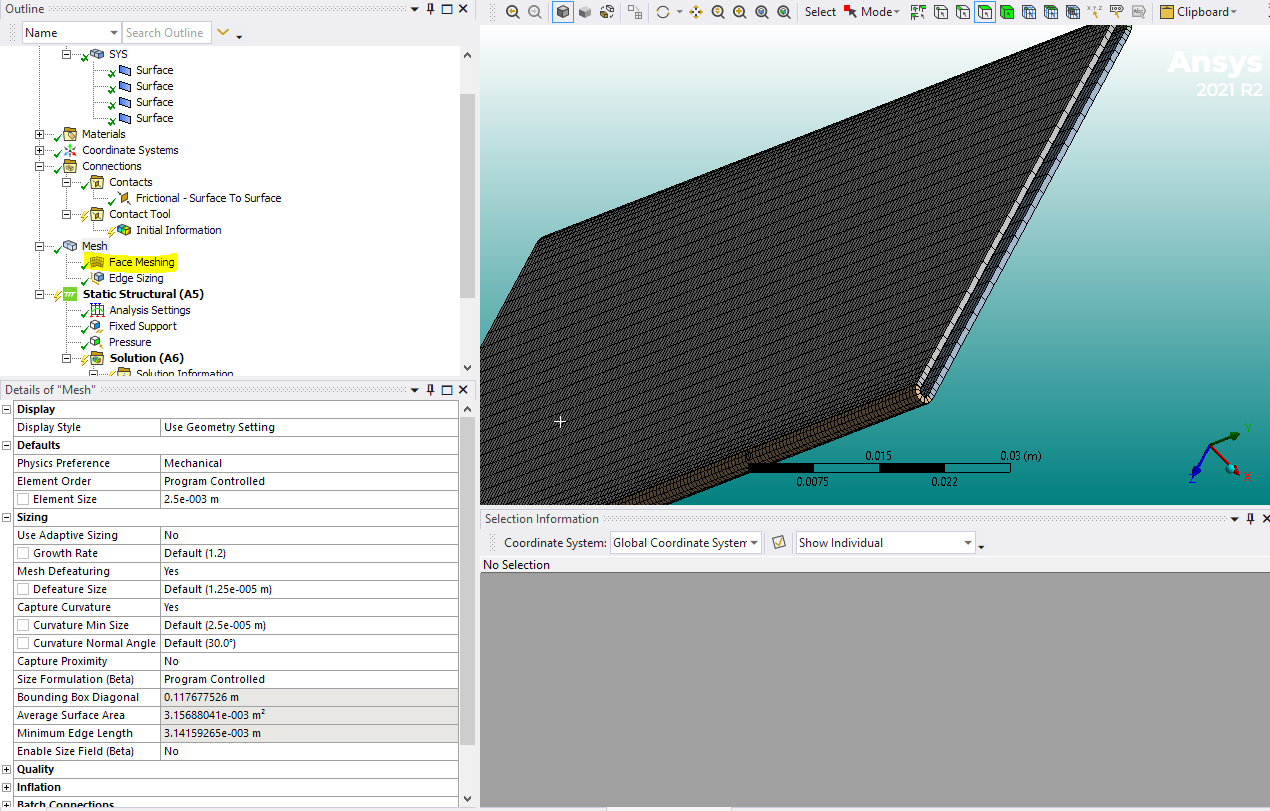

      Mesh is good to be structured if possible (use face meshing on the two faces coming in to contact with each other):
      Finally
      As for the solver settings:
      With these considerations it should solve well.
      (Ansys employees are not able to provide a model, see rules of these forum, but with the above considerations it should solve)
