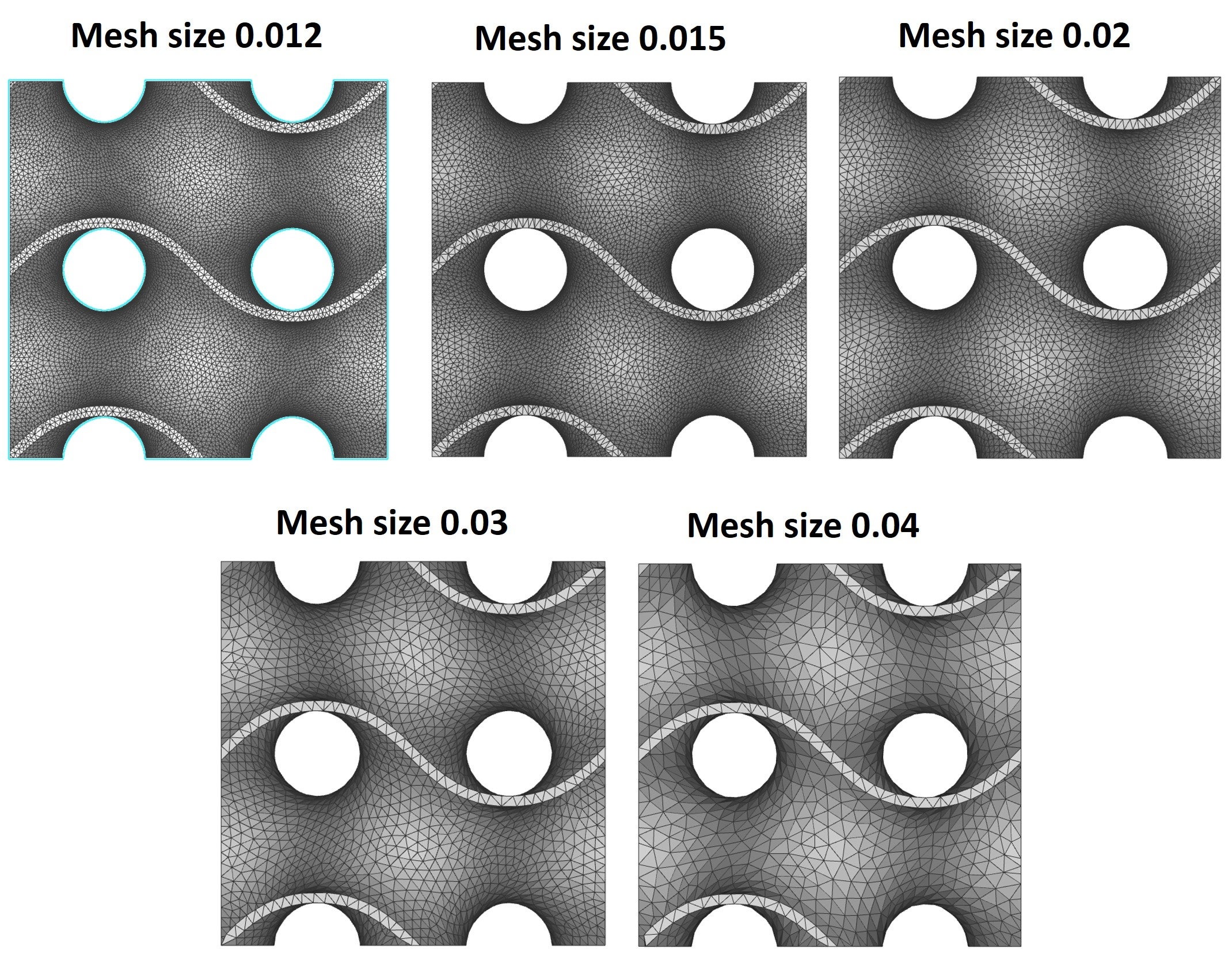

SubscriberDear all, I have a problem with mesh sensitivity analysis

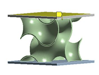

I am doing a Quasi-static analysis for one unit cell of Gyroid. the size of the unit cell is 1*1*1 and i want to compress it up to 0.1 mm . bottom plate is fixed.
February 3, 2022 at 1:21 pmpeteroznewman
SubscriberDear For the issue of plotting a force vs displacement curve, if you plot the displacement of the plate, it doesn't matter that some parts of the sample lift off the plate, both the top and bottom plates have this effect. One approach for tracking the displacement of the part is to make a Named Selection of elements that are very close to the top plate. Then you can plot the Minimum Z Directional Deformation. That value would capture the elements that are still touching the plate. The elements in that Named Selection that lifted off the plate would be measured by the Maximum Z Directional Deformation.
The mesh sensitivity study shows a good trend. What is the thickness of the wall? How many elements are across the thickness at a mesh size of 0.01 mm? Linear Tet elements are known to be overly stiff in bending, so 1 element through the thickness must never be used, 2 elements through the thickness is unacceptable, 4 elements through the thickness is barely acceptable, 8 elements is great.
That guidance is for linear tet elements, and doesn't apply to quadratic tet elements, but those are not available in Explicit Dynamics.
Linear Hex elements perform better than linear Tet elements. If you could generate a gyroid surface, mesh that with quad elements, then extrude those into hex elements, like two layers on each side, that would be four hex elements through the thickness and would give you a better ability to increase the number of elements through the thickness without creating a huge number of nodes.
You will find that the Force-Displacement curve converges with element size faster than the Stress-Strain curve.

Thank you very much for the answer. For the first paragraph, I should check your criteria. But I think the problem is very serious than that at first, I should bring my mesh from another program which means my mesh is not editable at all and I could not define to give me exactly 4 elements in the thickness I put the image below to show you how was the element for all 5 mesh sizes, at best, for mesh size of 0.012, you can find it in the below image:
thickness is 0.04 mm. and the whole dimension of unit cell is 1*1*1 mm

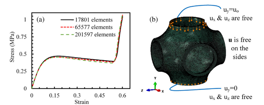

, for the final mesh size of 0.012, the simulation takes 4 days !!!! and I used mass scale as well but the performance of my PC does not work especially when I am using other programs during doing simulation. But the result of mesh sensitivity does not satisfy, How much should make the elements be smaller???? for example for one paper that I found, for a simple unit cell of Primitive they found the mesh sensitivity with 3 values: BUT for me, it does not work, I think something is wrong with my model, maybe I should change the unit cell to sth like this paper and try again with my own material
yes thank you for mentioning that to me I am aware that I should use linear elements. I did not try quad mesh and I do not know the software can create that type for this structure tr not, I can try it, but I do not think that it works.

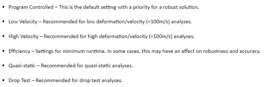

In the " Analysis setting" there are several options like :
using " Custom " type and manually use a mass scale setting to speed up a simulation
or
"Quasi-static " type and use the mass scale?
What is the difference between these two option? Do they give us the same result under the same boundary conditions and end time value? I found this explanation in help ansys.

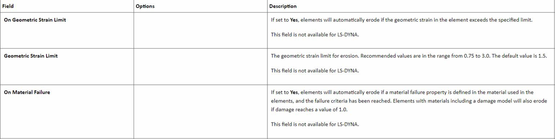

and my other question is related to failure criteria:
If I want to use "strain limit" as failure criteria: ( we have tensile test data and we have failure 10% strain, which one would I define for my failure criteria?
should I define it in "analyst setting " as " geometric strain limit " parameter" OR in the "engineering data for material"?
What's the difference between them?
In ansys help, they wrote a recommendation for geometric strain limit. why do they recommend it as 0.75 to 3? I got confused !!

SubscriberDear I expect the difference between Custom and Quasi-static settings in Explicit Dynamics is that the Quasi-static setting automatically chooses values for you, while for Custom you have to figure it out yourself. If you use the same values in Custom that were chosen in Quasi-static, then you will get the same result.
For Geometric Strain limit, there is no problem using 0.1 as the Geometric Strain limit. There is a default value of 1.5 so that solutions continue when no failure data has been entered by the analyst. I don't know why they have a lower limit on the recommended range. If the element gets too distorted, it can cause the solution to stop, so it makes sense to have an upper limit on this field.
In the Explicit Dynamics Theory Guide, the equation to calculate Geometric Strain is given as Equation 5-25. 5.3.4. Erosion Controls (ansys.com)
For On Material Failure feature of Erosion controls, see this page of the Autodyn User's Manual 22.6.3. Failure Models (ansys.com)
In section 22.6.3.1, it shows Material Stress and/or Strain Failure is created to handle composite materials that have a fiber direction 11, a matrix direction 22, an interlaminar direction 33 and a tensile failure limit in each of those directions is required along with other data.
So I would conclude that you would not get the identical result when using a strain value of 0.1 for the Geometric Strain Limit compared with using On Material Failure and using 0.1 for each of the three directions due to different equations being used.
