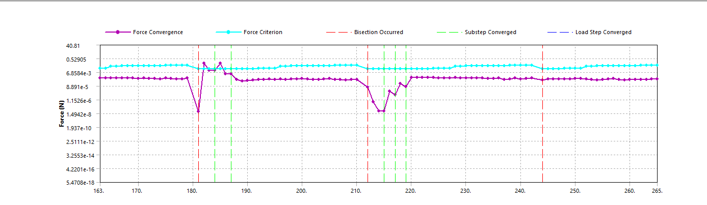

      In my problem, this is the Force Convergence plot which im getting, I understand that the Force Convergence < Force Criterion for the equlibrium iteration. But in the below attached graph, @ many places even when Force Convergence< Force criterion,i'm not getting "substep converged" result !. Help is appreciated;
      The solver checks many more metrics than Force before it converges on a substep. You need to look in the Solution Output file and read the messages to know what to do to fix the problem.

      It seems the contact point status change need to be zero along with satisfying the Force convergence & Displacment convergence criterion.
      Is there any way i see contact point status change as a plot in the solution output?
      Edit the Contact, in the Details window is a Normal Stiffness, change that to Factor and enter a 0.1 value. A value less that 1.0 will soften the contact and reduce the "chatter" that is occuring on your contact, which is probably too stiff.  You can try a value of 0.01 if necessary.
      There is another setting which is to Update Stiffness, set that to Each Iteration.

        Thanks for the info. However i'm going with the Normal Largrange formulation for the simulation. I have got my simulation get converged. Adjusted the time increment size, now it worked, but as expected took lot of iteration & time.
