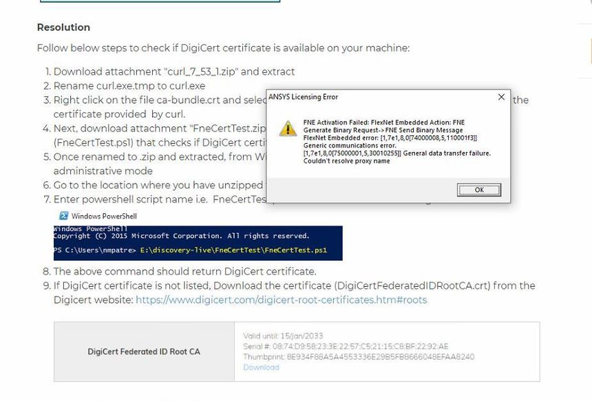

SubscriberHi Support, We have a customer who has downloaded 2021 SpaceClaim.  Can't load the software due to a FNE activation error see image below.  We have followed all the steps that try to resolve this error from this page - FNE Activation Failed. Peer certificate cannot be authenticated with given CA certificates  Still nothing works.  Any help would be much appreciated.

In a few of the earlier queries, it was found that this could be due to firewall settings. Please follow the Firewall settings as listed in Discovery License Activation Troubleshooting. If that does not resolve the issue, please let me know.
