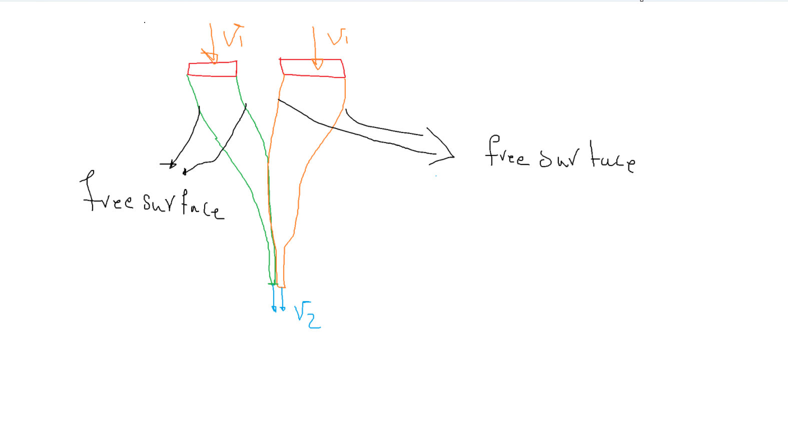

      As shown in the figure, the fluid enters the domain through two separate sections. The two regions are not initially in contact, but they come into contact further downstream. I would like to account for the effect of this contact in the model.
      I understand that this can be considered in a transient simulation, as the contact develops during the evolution of the solution. However, my main concern is the computational cost. Since the final objective is to obtain a steady-state result, I was wondering whether there is a way to include the effect of fluid/fluid contact within a steady-state setup, without having to simulate the full transient process.
