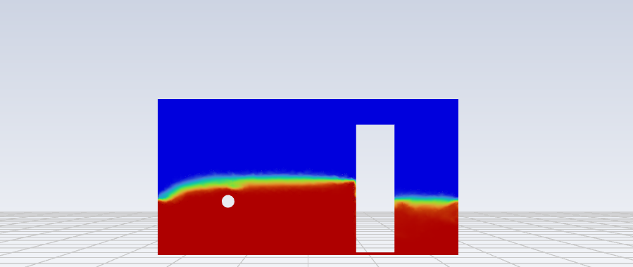

Ansys EmployeeYou can use a Dynamic Mesh to move the sphere. You can either set a defined motion or let the movement of the sphere be dictated by the forces of the flow (Six DOF model).
12.6. Using Dynamic Meshes (ansys.com)
Chapter 14: Using Overset and Dynamic Meshes (ansys.com)
What are your modeling objectives once the sphere reaches the building?
