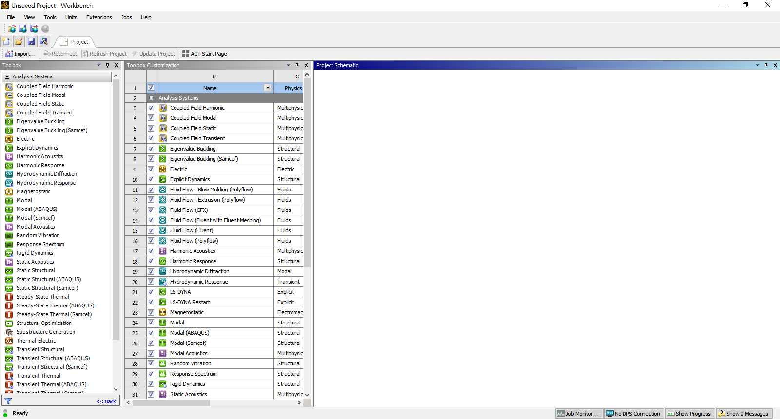

      Hi all,
      I have install the Ansys student R1 version.
      but the the toolbox didn't show the fluid flow system (11-16).
      How can I fix this problem?
      Thank you.
    • Matt Madore
      Please try running C:\Program Files\ANSYS Inc\Ansys Student\v221\commonfiles\configs\winx64\config\AnsConfigFLUENT.exe

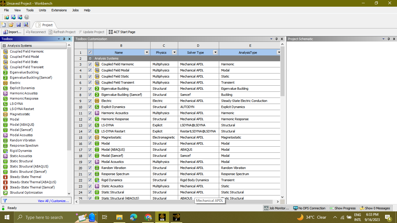

    • Ammar Abbas Shah
      Hi! I cannot see any Fluid related system in my toolbox. Moreover, I had to open Fluent from the folders, it didn't had any shortcut on workbench. Please tell me what to do
