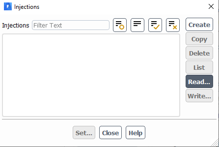

Forum ModeratorPlease can you post an image of the injection panel? n -
March 16, 2021 at 5:43 pm
jack_townsend
SubscriberHi Rob,nI've written a Matlab script which is writing to a file (as ideally I will be generating many points beyond reasonable manual input), I've experimented a bit with whitespace and linebreaks but not had any luck. I've also pasted the text as I wrote in the initial post back into a blank text doc to mimic what I imagine you did.nAre you also testing on 2020-R2? If gwqsz is running into the same issues could this be a problem specific to the version?nBelow is an image of my Discrete Phase panel and injections panel (of course, the injections panel is empty as the error is in reading the file, so no injections are created):n
