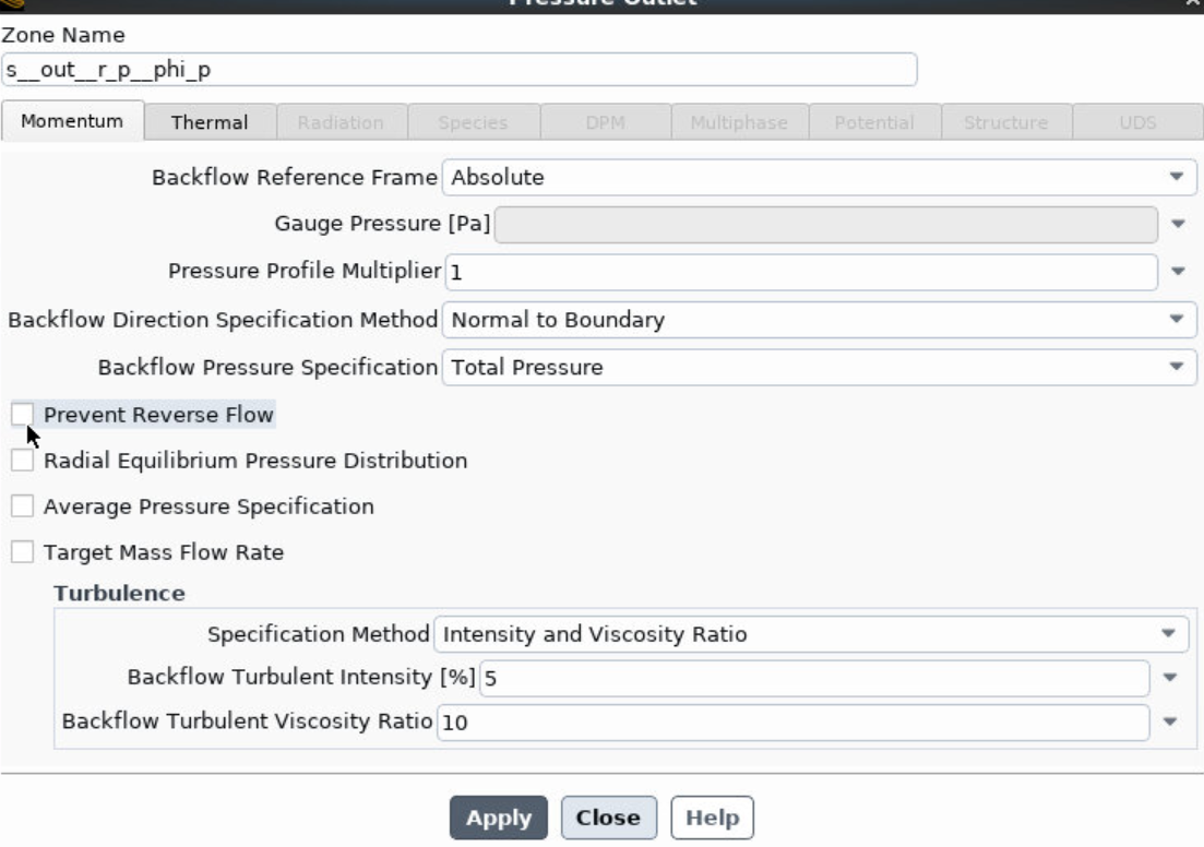

      I am using Ansys FLuent Solution 2021 R2 and I cannot find a TUI command for checking "Prevent Reverse Flow" when defining a pressure outlet boundary condition. I tried searching on the respective TUI manual, and there is no reference to it. So, is there no way to check such option through TUI?

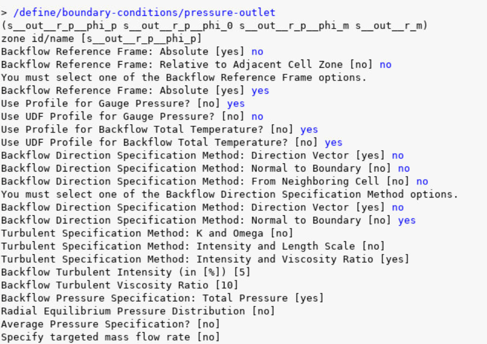

      Try this out: 'define/boundary-conditions/set/pressure-outlet/'
      Once you select zone(s), you will find this: 'prevent-reverse-flow?'
    • Élio Pereira
      Thanks Nikhil.
      I can indeed confirm that such command works.
      The trick is to use that “set” before “/pressure-outlet”, that is,
      /define/boundary-conditions/set/pressure-outlet
      instead of
      /define/boundary-conditions/pressure-outlet
