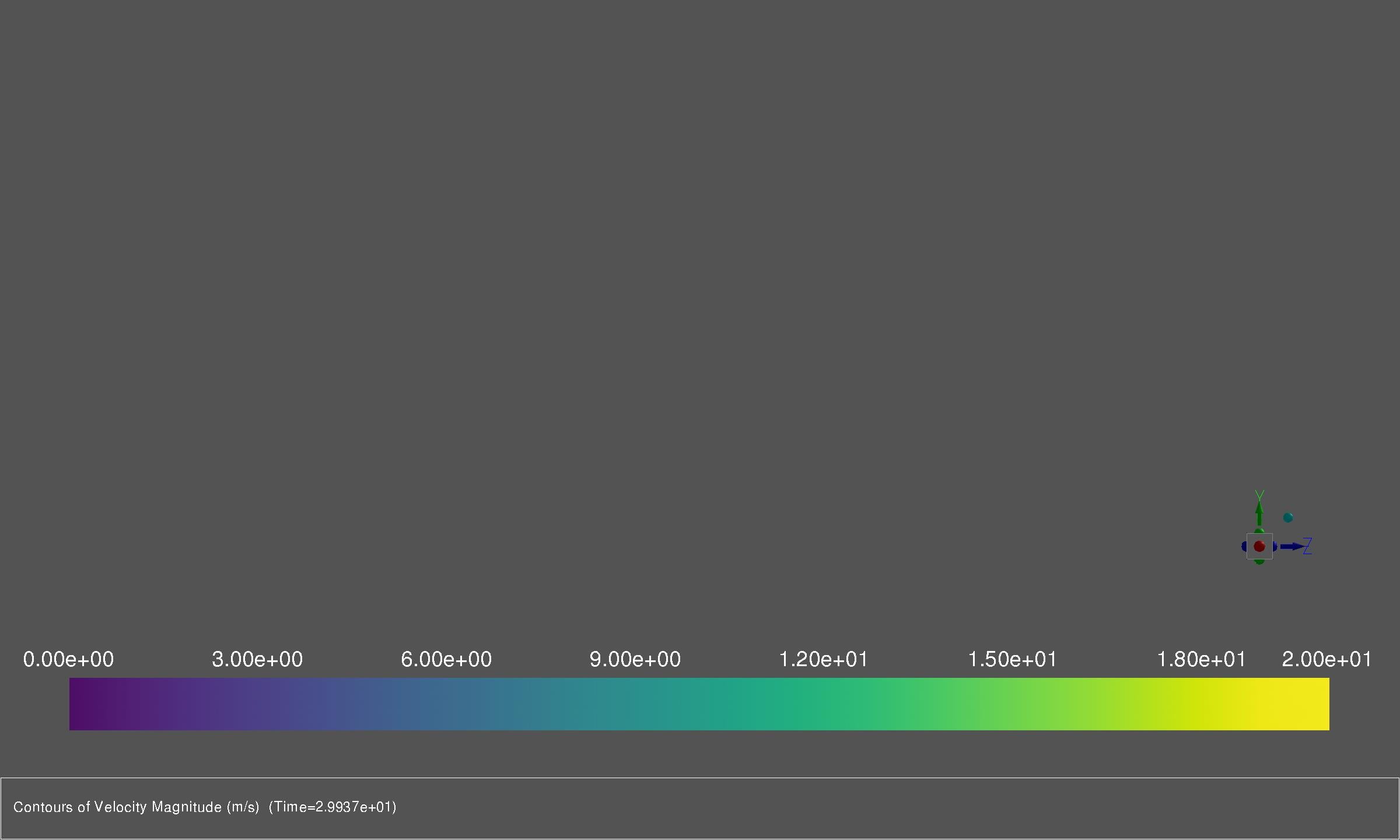

      So I'm attempting to create a "screen-shot" of a contour every timestep of a SBES simulation. However, the some images will render part-way through adjusting the view of the image.
      See images in this imgur album: https://imgur.com/a/t6BH3ba Each image is a successive timestep. You can see that the timestep 427859 is taken at some odd angle. Below is the journal file, where every timestep the view is adjusted to make sure it is in the right position.

      Other symptoms are that sometimes fluent will simply output plots without the actual contour with it (it'll save a png with the color bar and text, but no domain contour).
    • JamesWright
      I've updated the topic title to better reflect the pressing issue. I'm currently getting inconsistent behavior running this journal file.
      The consistent part: I'm running the same journal file with the same case/data file on the same hardware (in some cases, the same exact computer) using ANSYS 19.0. The code runs perfectly fine, exits without errors, and always outputs images.
      The inconsistent part: The images will sometimes not have the actual geometry in them.
      I've combined results from three different runs: two unsuccessful, one successful. They're designated by their job numbers. They contain journal scripts, transcripts and images from the runs.
      6634049 (Drive link here) is from the original posting. The first two images are perfect, but the third is rendered at an odd angle. This was run using "-gu" and "-driver null" flags for fluent
      6641572 (Drive link here) is a completely successful example. This has more images than the first, utilizes the "save-view" function in the Fluent TUI, and has the axes. This was done using "-gu" and "-driver x11". The driver was changed as a colleague using the exact same hardware is able to get correct plots using similar methods.
      6641591 (Drive link here) is a complete failure. The only difference between this and the previous run (6641572) is a change to taking images every other timestep. This also has the axes shown.
      Focusing on 6641591, Note that the "[variable]0.png" images were not taken using the "every timestep" sequence of commands, while the rest were. Notice that the axes in "[variable]0.png" are in the correct position (negative x axis pointing at camera) while all others are not in the correct position (positive z axis pointing at camera). This says to me that the view-state is not being updated correctly for some reason.
      Note that these (inconsistent) results have been reproduced dozens of times in both batch mode (no DISPLAY variable set, purely scripted on remote compute nodes) and interactive modes (DISPLAY variable set, fully scripted on interactive virtual machines on remote nodes).

      The one's called "Failure: ___" are from the 6641591 run described before. The first one is taken before the calculation is started, the second is after. An example of a successful image is shown by the first two images.

      Sorry for the delay. Below are the images with relevant descriptions.
      6634049: Taken before calculation
      ^^ 6634049.0 taken before calculation was started (this is the desired view)
      6634049: taken during calculation after 1 timestep
      ^^ 6634049.1 taken after 1 timestep of calculation (this is also the desired view)
      6634049: taken after 2 timesteps of calculation
      ^^ 6634049.2 taken after 2 timestep of calculation (this is not the desired view)
      6641591: taken before calculation
      ^^ 6641591.0 taken before calculation. Notice from axes we are looking at the "negative X" axis, which is what is desired.
      6641591: taken after 1 timestep
      ^^ 6641591.1 taken after 1 timestep. Now we're looking at the positive Z axis, which means the "save-view" command didn't stick for some unknown reason.
      You've got a scale & titles so the correct window is being displayed. If save-view failed there would be an error in the TUI window or transcript if present. Are we looking across the plane (ie the image is on the y=constant plane)? Otherwise, is the velocity between 0 & 20m/s: if clip to range is on and it's not there will be nothing to see.

      The only error that comes up in the transcript is for the "/display/set/picture/use-window-resolution? no" command. Otherwise, the script runs error free.
      The contour lies on the ZY plane, so in 6641591.0 we should be looking straight at it. For 6641591.1 we're looking across the plane.
      The velocity magnitude is between 0 and 20 m/s. All the images start with the same initial conditions, so all the images taken at the 0th, 1st, 2nd, etc. timestep should look exactly the same. In the case of 6634049 and 6641572*, the look exactly the same for the 0th and 1st timestep (though they obviously differ for the 2nd timestep due to the rotation in 6634049.2
      * Note that 6641572 images are explicitly shown, but they also look exactly like 6634049 excluding the odd rotation in 6634049.2
