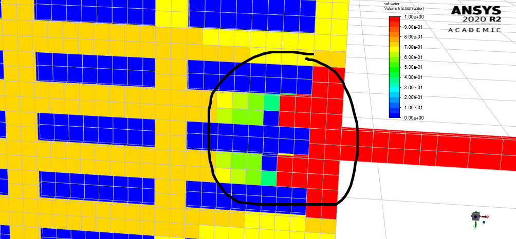

      The code works in serial however I must investigate physics in more detail to check plausibility of the results. Serial simulation is very slow, so I wanted to start a parallel calculation. I parallelize my UDF’s, and the mesh is partitioned. But at some point, the calculation gives incorrect results. At a partition interface the volume fraction of water vanishes ahead of the fully water-filled area. Before there was a significant VOF of water. Additionally, a high negative static pressure evolves at the partition interface (see pictures). In serial mode there is no problem at this point.
      Does anybody faced such a problem in the past and may explain the reason for these 'artefact' and how I remove it? So far, I think there is a problem in communication between the node processes or with the water surface at the partition interface. The problem occurs even if I deactivate all my UDF's. When changing the partiton method the problem occurs at a different location due to changed location of the partition interface.

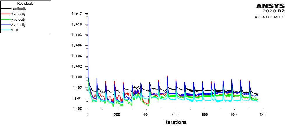

      I am using superficial velocity. And I try to perform the simulation without porous media model. However, convergence issues occur when disabling pororus media. I think this is due to absent permeability of the medium. Therefore my calculatiuon settings etc. are not sufficient anymore.
      Regards
    • naibaf
      For a first look, the calculation is very unstable without porous media. But it seems that the problem remains.
      Fig 1 Vanishing volume fraction of water in the area of partition interface, ahead of the fully water-filled part.
      Fig 2 Residuals showing poor convergence of the simulation without porous media model.

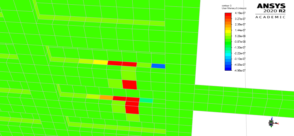

      At the beginning of the calculation the UDM values for the source term are nearly identical in both cases. Slightliy differences at the partition boundary are visible. With increasing simulation duration the error between the UDM values at the partiton interface increases (see Figures below). The calculated minimum mass source (outflow) is the same in both cases. But there is a significant maximum mass source (inflow) in the parallel case.
      But I am wondering since the issue remains even if I unhook and unload all the UDF's . As expected the UDMs without UDFs are zero everywhere. So no source should be applied, but the issue with the vanishing volume fraction of water remains.
      Fig 1 UDM value for mass source in parallel case.
      Fig 2 UDM value for mass source in single node case.
      Thank you in advance!

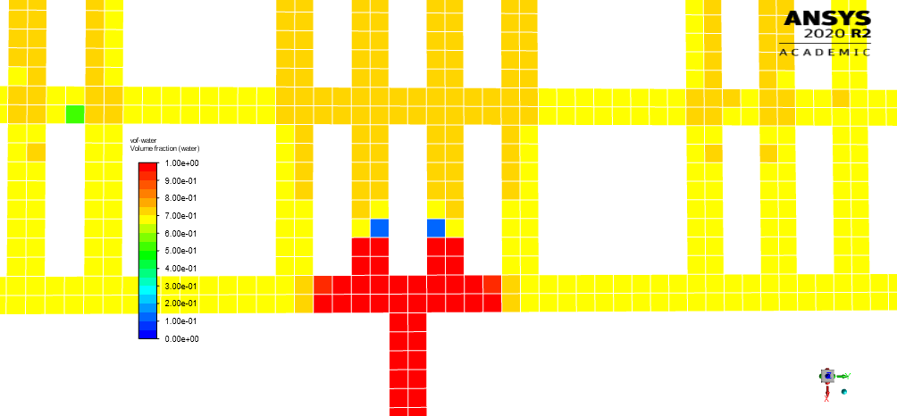

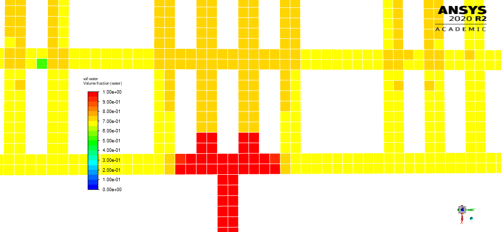

      3/I hope these are the figures you expected.

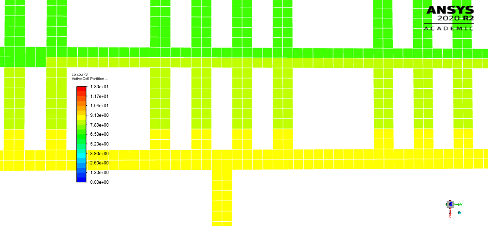

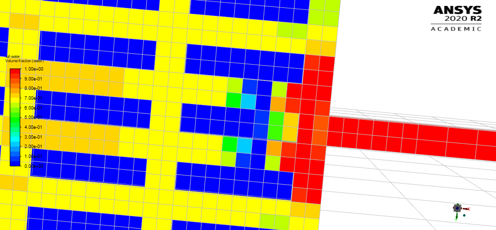

      The Figures show the VOF for water in the underground rooms and drifts as plane view. In Fig 1 for the parallel case the vof drops, right at the partition interface. If the simulation runs further the spatial distribution of the decreasein the vof becomes larger. In Fig 2 for single node the VOF do not drop. If the calculation on the single node is continued, the chambers are getting filled with water more and more. For the parallel case, the water does not flow further. Both figures are saved after fluid-time = 221146.63 s after 40 time steps are calculated. I use adaptive time advancement to gradually increase the time step. The time advancement settings are the same in both cases.
      Fig 1 Volume fraction of water for the parallel case at t = 221146.63 s after 40 time steps.
      Fig 2 Volume fraction of water for the single node case at t = 221146.63 s after 40 time steps.
      Fig. 3 Distribution of partitions.
      Thank you very much for your help and time!
      Repartition onto a different number of nodes or with y-direction so the partition is in a different place. What happens? What is the flow field like?
    • naibaf
      Dear Rob for my first test with the default METIS-partitioning-method. The issue was occuring on a different location but also at the partition. So I changed the partitioning method to X-Cartesian and the issue occured at a different time at the new partition locations.
    • naibaf
      So from my point of view, the fluid flow is ok until it reaches the partition interfaces.
      OK, so we have a gradient issue with a very coarse mesh at the parallel partition. Please refine the mesh and see what happens.

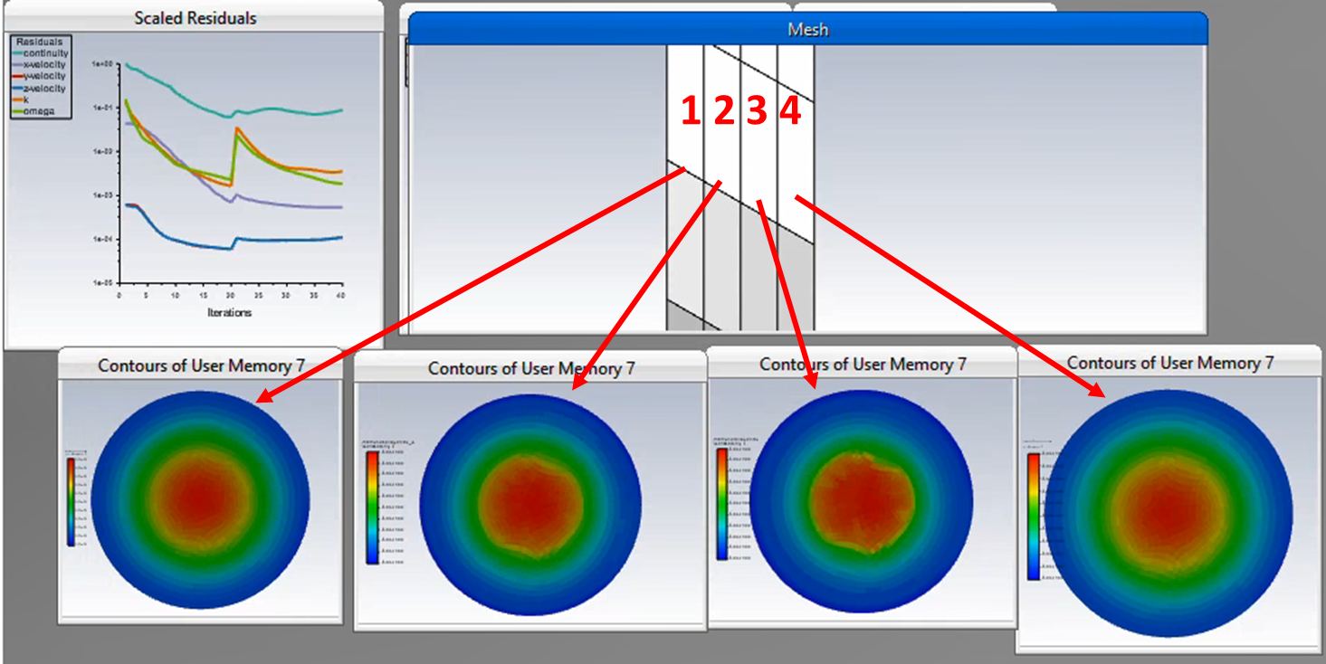

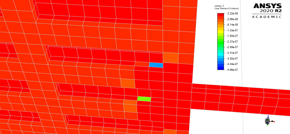

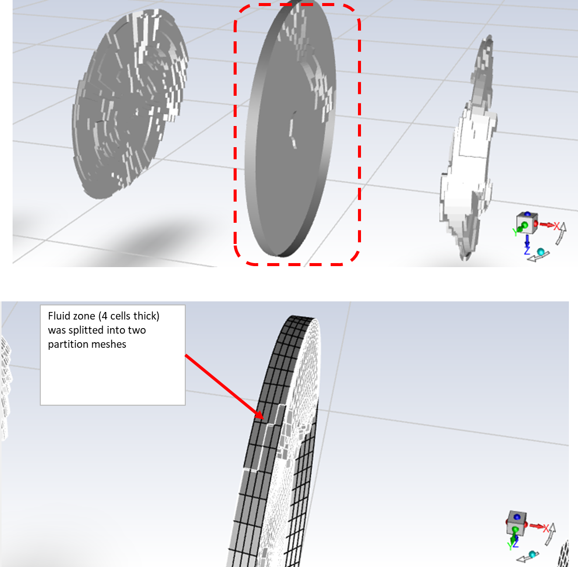

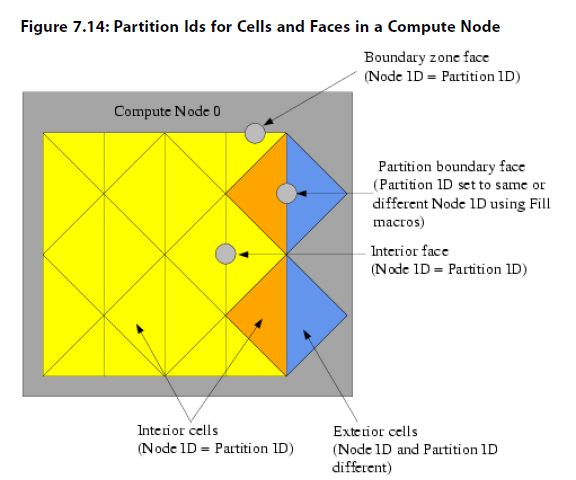

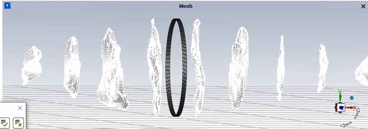

    • Mohammad Haikal Md Fouzi
      Hi Rob, I've facing similar issue as naibaf where i'm trying to access c_udmi value in the exterior cell of a partition. My intention is to calculate the average value of C_UDMI for a cell_t c at thread t based on the neighboring cell (if the given cell_t c has 6 faces, that means it has 6 neighboring cells). The averaging function works if the cell zone was in the same partition, but will give the wrong value if the cell zone have more than one partition.
      Below images is the correct contour of user defined memory as the cell zone is not separated by any partition.
      Below is the wrong contour (wrong averaging calculation) as the cell zone was splitted into two different partition.
      Is there a way to access user defined memory on the exterior cell of a partition mesh so that i could get the averaging calculation right.
