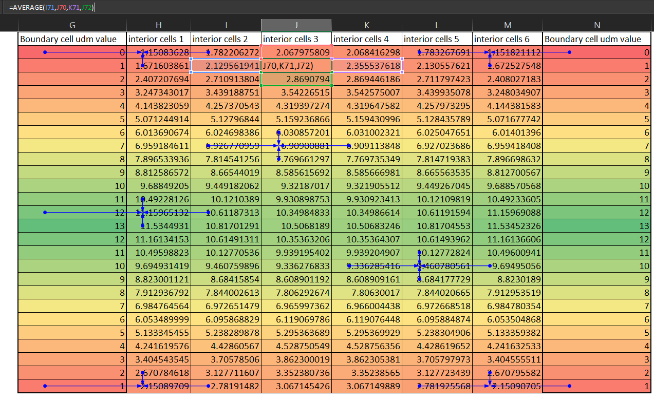

      the averaging order will not influence the result in the interior cells as the calculation is based on the pre-calculated UDM value in the boundary cells.
      Below is the visualization of the averaging of interior cells based on udm value at 2 boundaries. As you can see the contour across the interior cells is pretty similar with the boundary cells.
