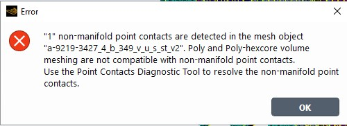

SubscriberHi all, I am trying to auto-mesh something in Fluent but am given this error in the image attached, telling me to use the Point Contacts Diagnostics Tool. Where do I find this tool and how do I use it? I can't seem to find it anywhere.

Ansys EmployeeSelect Mesh Object. Then right click. There you can find Diagnostics - Connectivity and Quality option. nPlease check different criterias like self intersection etc. nFor more information please check help manual with following link. nRegards,nKeyurnGuidelines for Posting on Ansys Learning ForumnHow to access ANSYS help linksAugust 12, 2020 at 1:13 pmnineone
SubscriberI just tried that, and there are 5 free faces that I can't seem to remove. Do you have any ideas on how to deal with those?.Thank you!nAugust 13, 2020 at 6:01 amKeyur Kanade
Ansys Employeedisplay free faces using gui option. n
nselect face filter. n
nyou can do it using gui or use ctrl + f. nthen select those free faces. nthen delete using gui or using ctrl + w. n
nRegards,nKeyurnGuidelines for Posting on Ansys Learning ForumnHow to access ANSYS help linksnn
