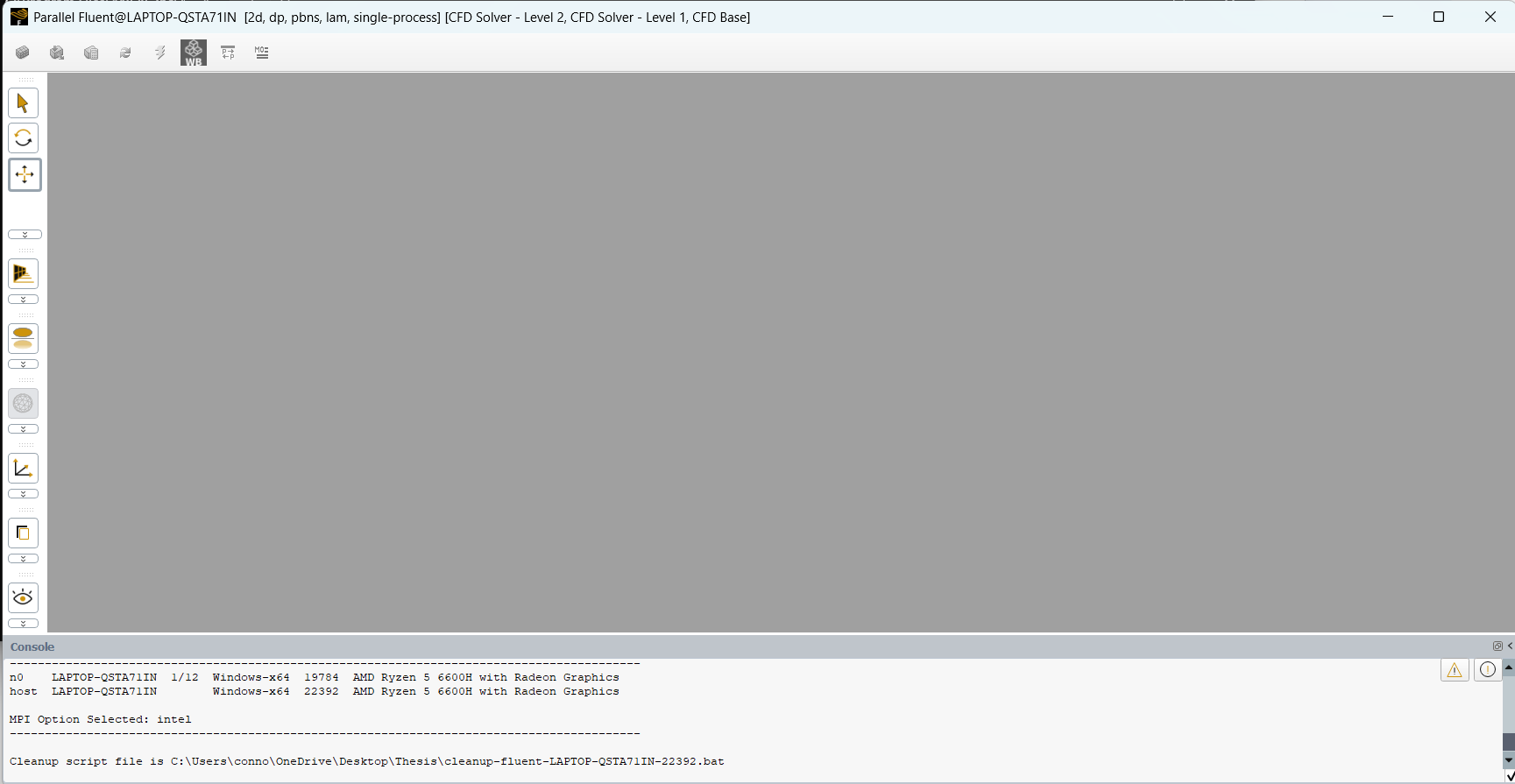

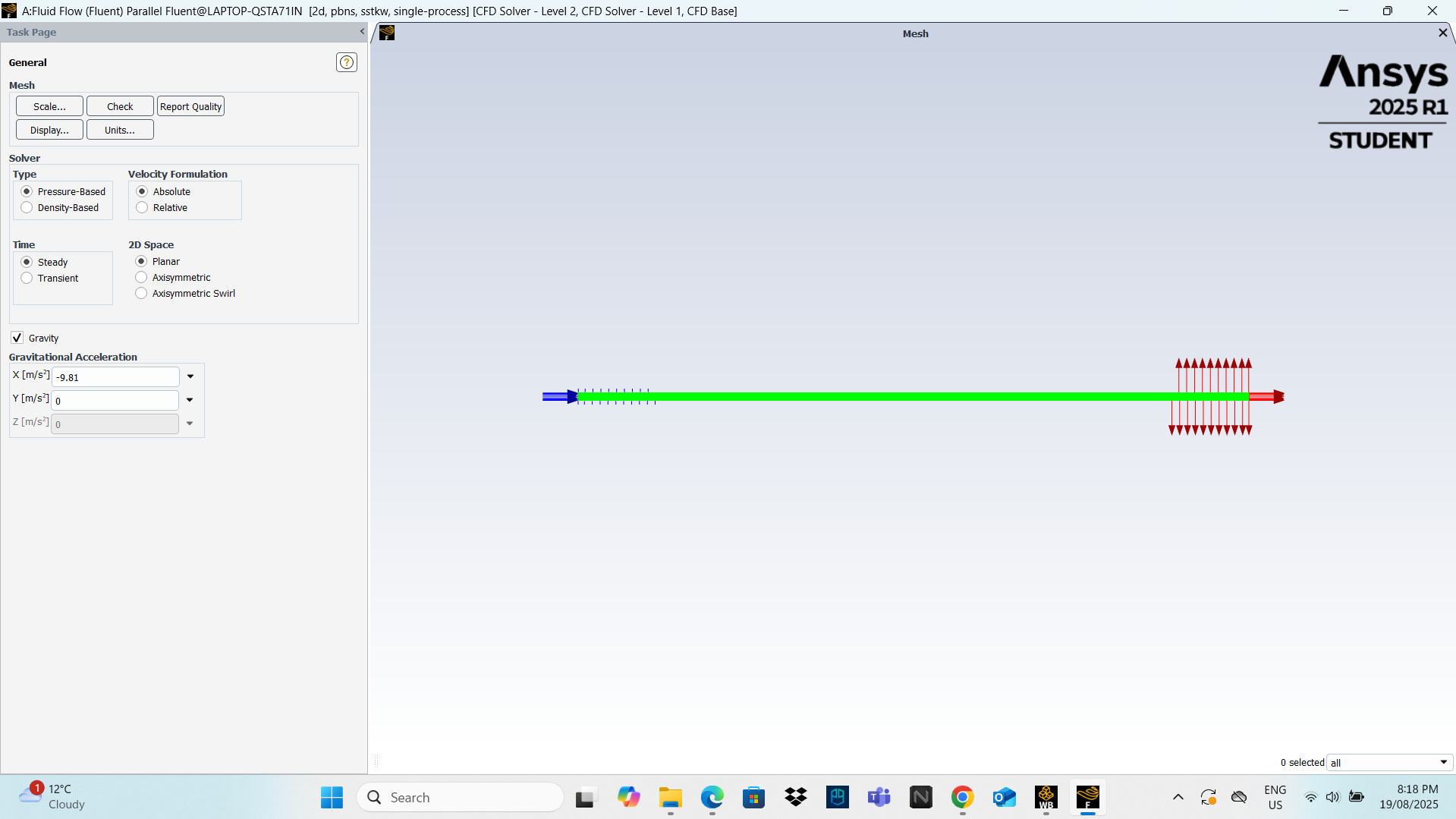

SubscriberWhen I launch ANSYS Fluent (2025 R1 Student) from Workbench (Setup → Edit), the interface only shows the Task Page. The usual navigation tree (General, Models, Materials, Boundary Conditions, etc.), the console window and the top ribbon are all missing. The console briefly appears on startup, then disappears. This happens both when launching Fluent through Workbench and when launching it standalone.

Also should note, there is no problem importing geometry or mesh, the software is even recognising the inlet and outlet (as shown in pic).

Forum ModeratorHave a look at the lower left corner of the graphics, there's a set of grey dots. Can you click on those? Otherwise check the perimeter of the window for tabs.Â

SubscriberHi,
The dots in the lower left hand corner only allow me to move the window around. Unfortunately no tabs around the perimeter, the windows I am missing just seem to be fully non existent.
