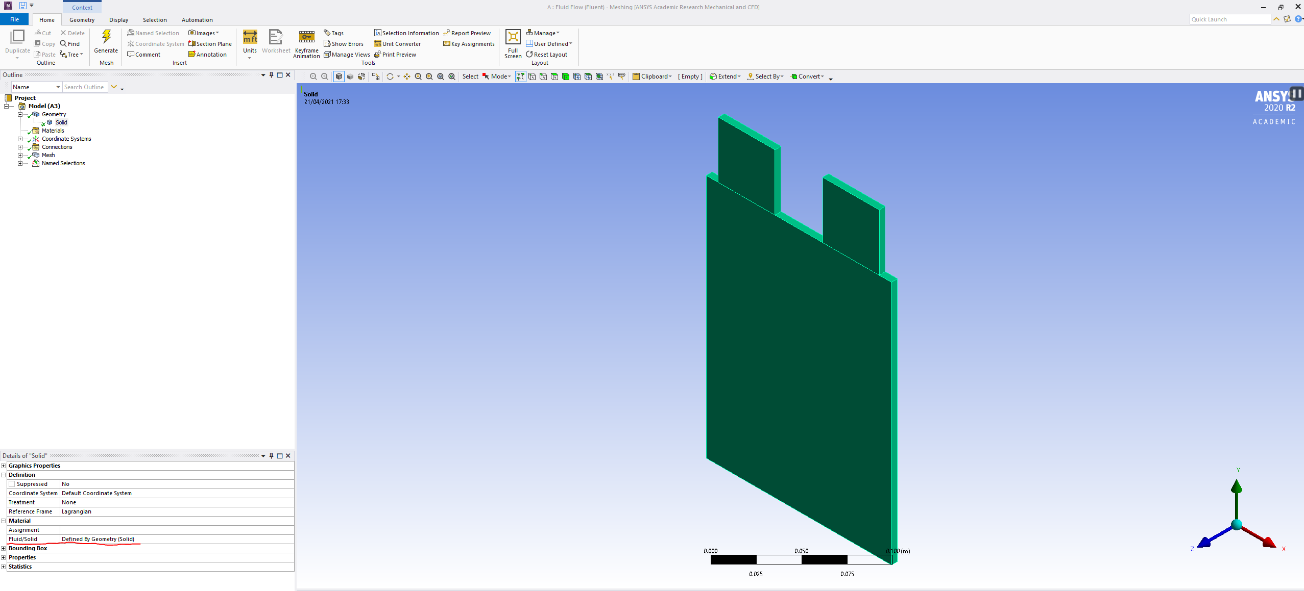

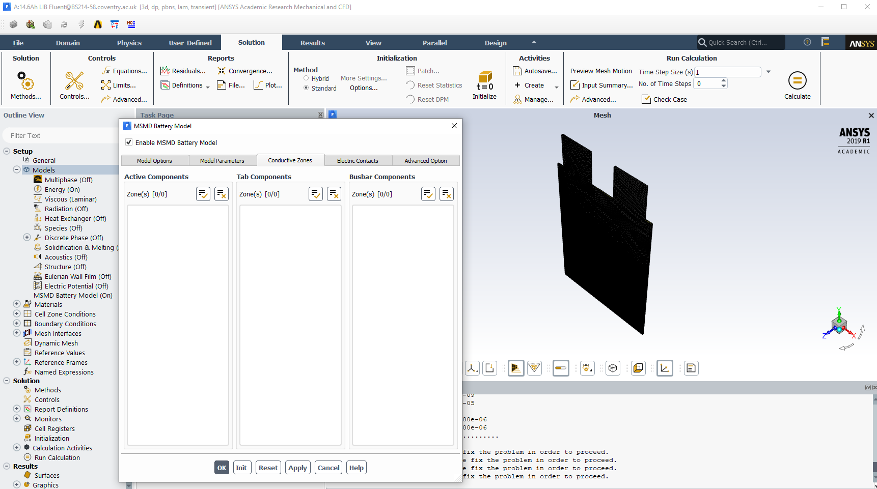

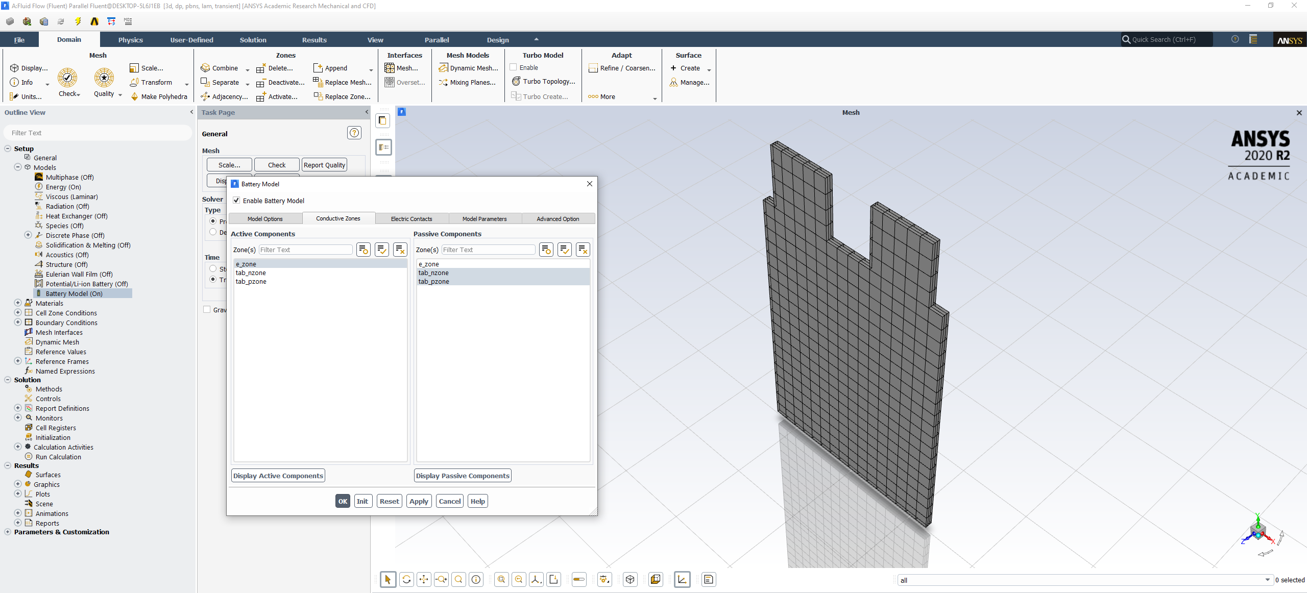

SubscriberHi, I followed the tutorial given by Ansys for learning the MSMD model. Although there were a number of differences in the version I am using the parameter mentioned in the tutorial, I managed to get the tutorial done and was getting the same plots mentioned in the tutorial pdf. Below is the image of when setting up the conductive zones in the tutorial.n

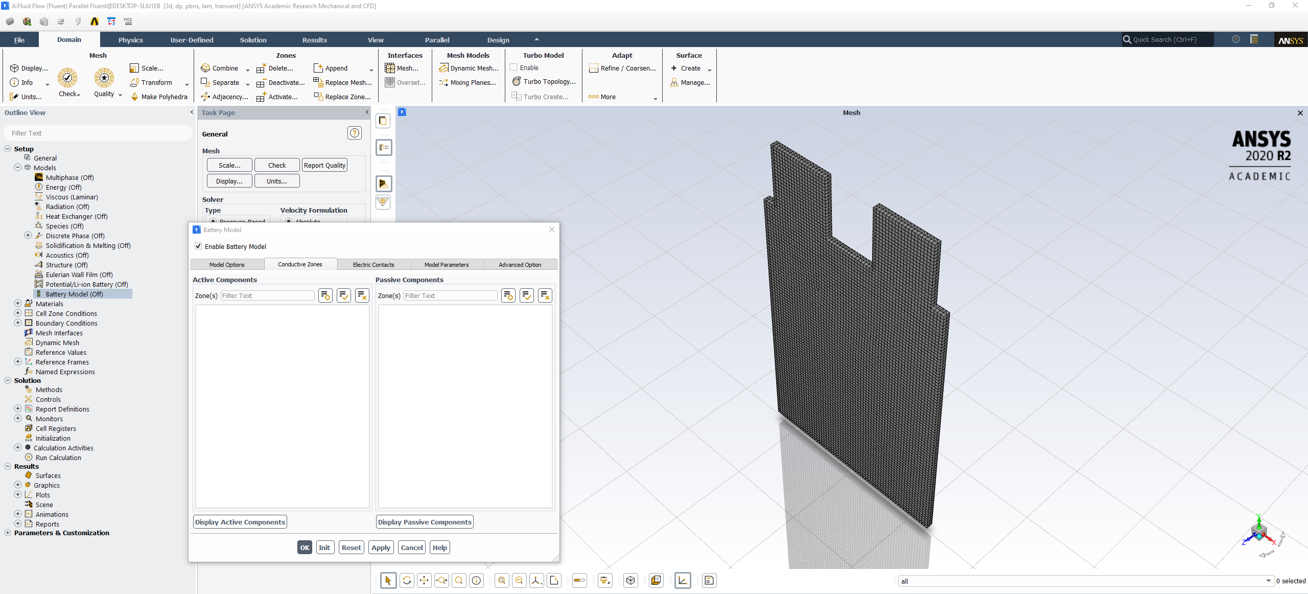

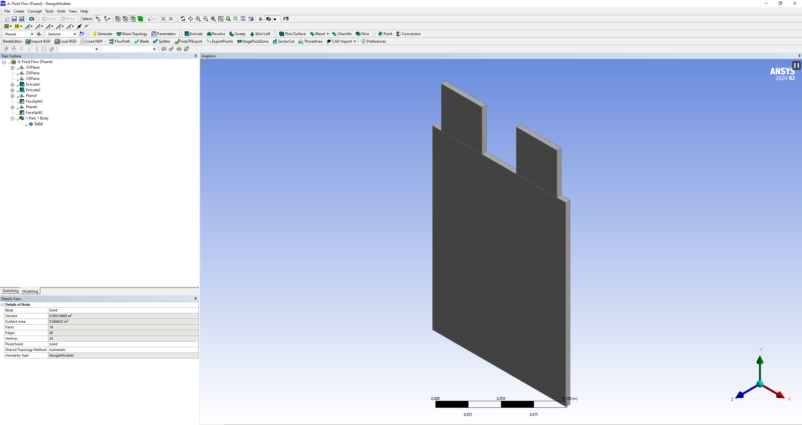

nI wanted to move on and create my own geometry and run the MSMD model again. However, in the tutorial you are given a .msh file which you load into fluent and start setting up the MSMD model parameters. When I create my own geometry, nothing shows up in the conductive zones (as seen in the image). Ive setup my own geometry and the given .msh file to be as similar as possible. I cannot open the .msh file in the fluent meshing software either and the tutorial makes no mention of how the mesh/geometry was setup. The image below is when I create my own geometry and try to setup the MSMD model parameters.n

Ansys EmployeeHello, nYou have probably set the zones as fluid. Make sure you have set the zones as solid. You might have to close and start fluent again after the change. n -

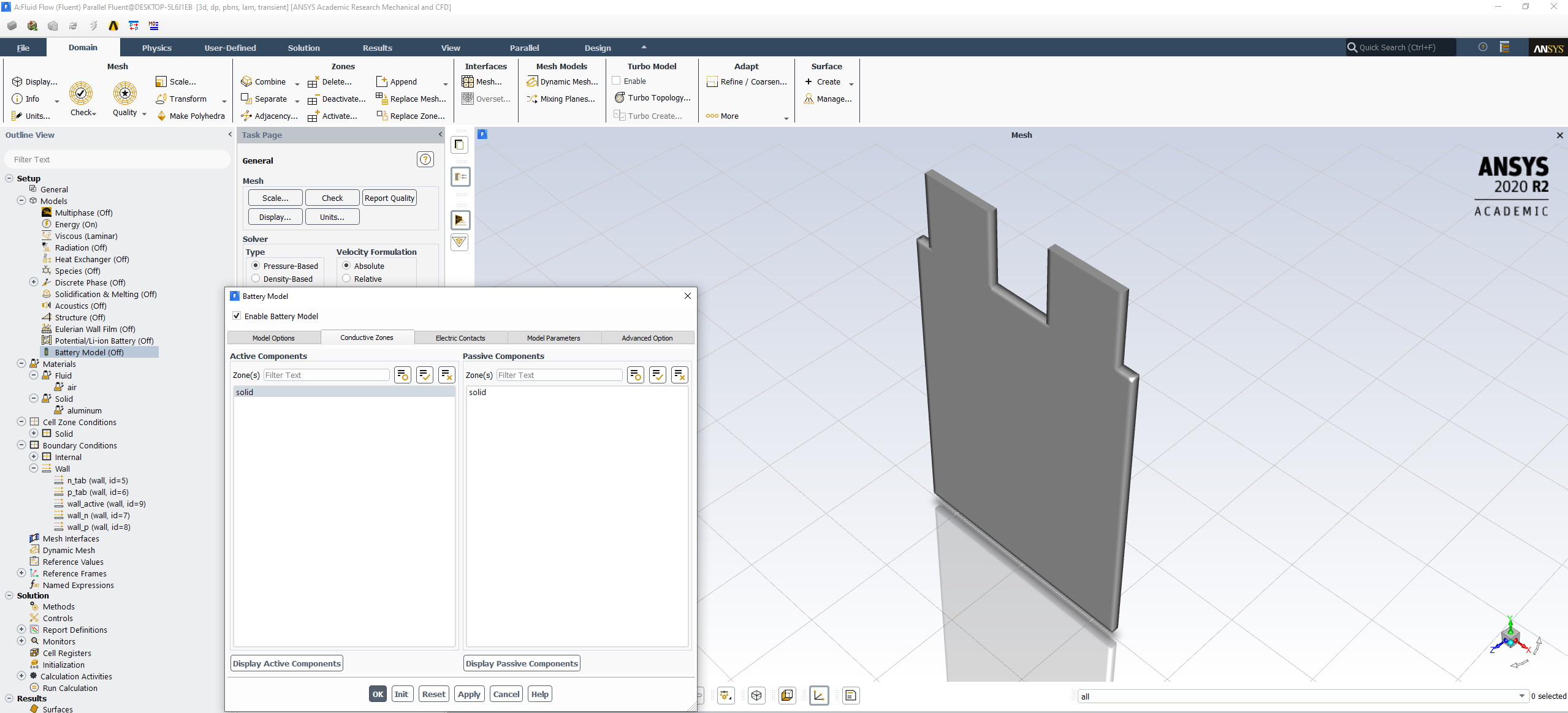

Ansys EmployeeWhat about in Fluent?n -
April 22, 2021 at 12:12 am
a.saeed.1
SubscriberHi RK,nChanging the Zone to solid in Fluent fixed an issue. An item does show up in the conductive zones but it does not show any walls which I have pre-defined in the mesher. The conductive zones just simply shows solid rather than something like wall_active, wall_n, etc. I have tried restarting fluent as suggested but that did not work.n
Is there something else I still have to do?n

SubscriberGo to the cell zone condition and converts fluid zone into solid
