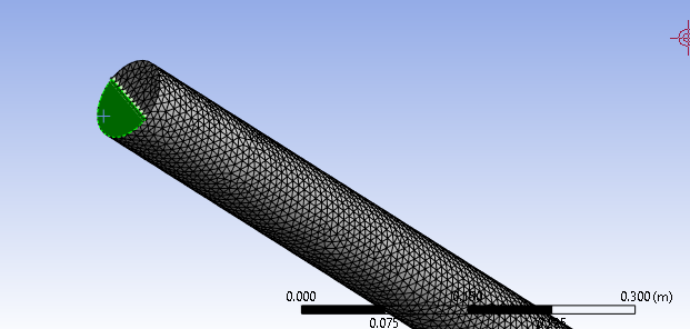

Ansys EmployeeSweep works for single source and single target. In your case you have 2 source faces. You will need to use multizone. In multizone please select 2 faces at inlet and 1 face at outlet under source.Â
Please go through help manual for more detailsÂ

SubscriberHi Sir,
That did not work. It is showing multizone block decomposition failed

Ansys EmployeeHow many faces there on outlet?Â
Please check multizone tutorial in Ansys Meshing.Â

SubscriberHi There is one face on outlet and 2 faces on inlet.

Ansys EmployeeIs there any other geometry connected to this geometry? Are you able to use multizone for a simple cylinder with one face at each end?Â

SubscriberHi, No there are no other geometry but this geometry is a bit long, 5m. Yes i am able to use multizone on a simple small cylinder.
Also does tetra mesh and hexa mesh produce a lot of diff in fluid flow results?

Ansys EmployeeIf there is no geometry attached, you can slice the geometry in SpaceClaim or Design Modeler to make it 2 half cylinders and then use Sweep method. Depending on applicaton tet and hex may play a role. But if you are working on a simple single phase flow through pipe, it should not make much difference.Â
