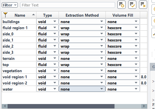

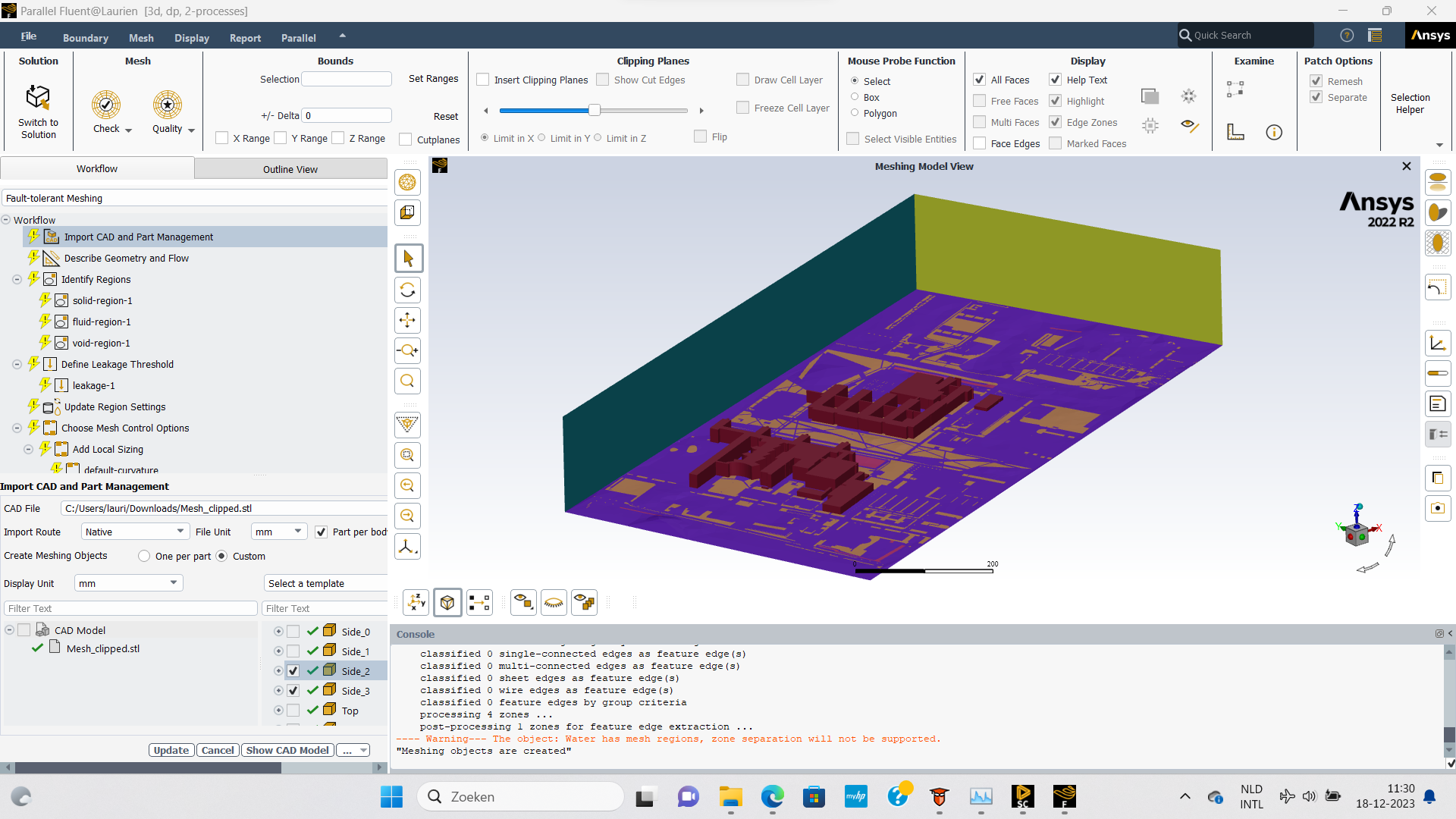

SubscriberThank you for directing me to the fault tolerant meshing workflow. However, I can not seem to generate a volume mesh since there are "Error: Empty face and/or edge zones.", my stl file describes a geometry of a part of a city consisting the water, vegetation, terrain, top and 4 sides surfaces (which form together a closed surface) and the buildings (which forms a closed surface without the other surfaces). A picture of the geometry is uploaded below (with two sides and the top hidden).
I defined the fluid region by the "Centeriod of objects" and I selected all objects for that. Am i doing something wrong in defining the fluid regions or other regions? Or is it not possible to mesh the geometry with this .stl file?

Ansys EmployeeDid you get the surface mesh?Â
The error in volume meshing suggests that few zones are not captured well. So you may redefine fine sizes to capture different zones.Â
Also please check extract edge zone option.Â

SubscriberYes I did get the surface mesh:
aAnd I used the extract edge feature "feature angle" and "sharp angle". However, I am now getting the following error, when trying to generate the volume mesh:
Error: CAR: invalid argument [1]: wrong type [not a pair]
Error Object: ()

Ansys EmployeeYou will need to work on sizing.Â
Please check : https://ansyshelp.ansys.com/account/secured?returnurl=/Views/Secured/corp/v221/en/flu_ug/tgd_user_workflow_guided_tasks_setup_mesh_controls.html?q=curvature%20sizing
