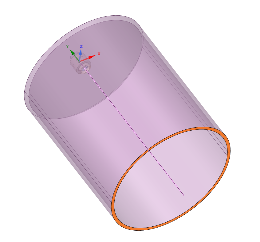

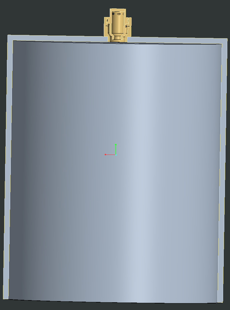

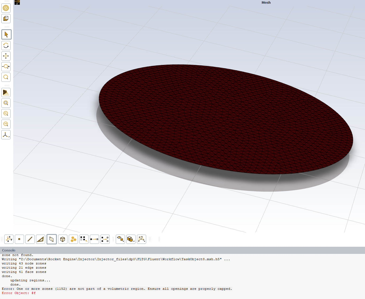

SubscriberI am getting an error when trying to extract the fluid region of a solid assembly. It is specific to this geometry only, a simple tube I was able to extract the geometry. The error message is: Error: One or more zones (1152) are not part of a volumetric region. Ensure all openings are properly capped.
Below is the cross section of the geometry:

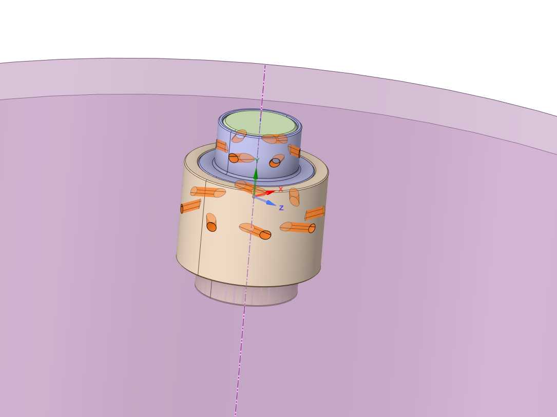

SubscriberHello,
I think capping the bigger hole (at the bottom) is pretty straightforward. The planer surface surrounding the hole will work (which you have highlighted).
I am keen to know about the top small holes. Can you please highlight the reference surface that you are considering to cap the top small holes?

SubscriberThe inlet hole fills were created by selecting all the holes inner surfaces (shown below).
This was the only method I could actually fill them. I tried using the outer edges of each hole, but it would not let me use those selections as a fill area. I also tried selecting the round outer surface where the holes are on thinking it would behave similar to selecting the flat surface of a tube and filling in the area open, but that did not work either.
I reviewed the video you linked, and that is indeed the same method of how I have been trying to create this mesh. Although their geometry is much simpler and does not contain filling a rounded inlet.

SubscriberHello,
In cases where no planer surface is surrounding the hole, you can patch those holes manually. Select one of edges of a hole (using edge selection filter) and press F5 to open a patching dialog box. Select appropriate settings and create a patch. You can patch all the other small holes similarly. I hope this helps.

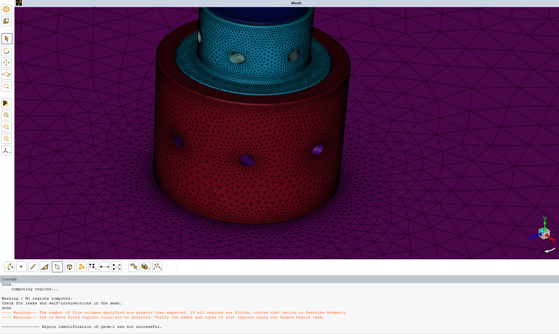

SubscriberThanks for the tip! I went ahead and capped the inlet holes using an edge and F5. Same error occurs when trying to create regions.
I tried instead doing the F5 cap method for all the zones and that gives a new set of errors. Here's a screenshot of the errors:
When I create regions after putting in the caps, it does not detect any fluid region at all in the part. Additionally, after pressing create regions, the caps I placed on the holes vanish, no idea how to get them back.
At this point, wouldn't it be easier if I upload the file so you can see if anything will work for it?
May 18, 2022 at 11:21 pmOzen
SubscriberFound a work around. Since fluent meshing refuses to work correctly with geometry that isn't just a tube... I was able to extract and mesh the fluid geometry using SpaceClaims extract volume feature. However, OFC while doing so ANSYS bricked and crashed my computer and now fluent won't even open that geometry. I swear this software was coded by toddlers with how often errors happen for the simplest of simulations...
Anyways, for anyone who comes to this thread with a similar error that I had, just use SpaceClaims extract volume feature and save yourself a migraine.

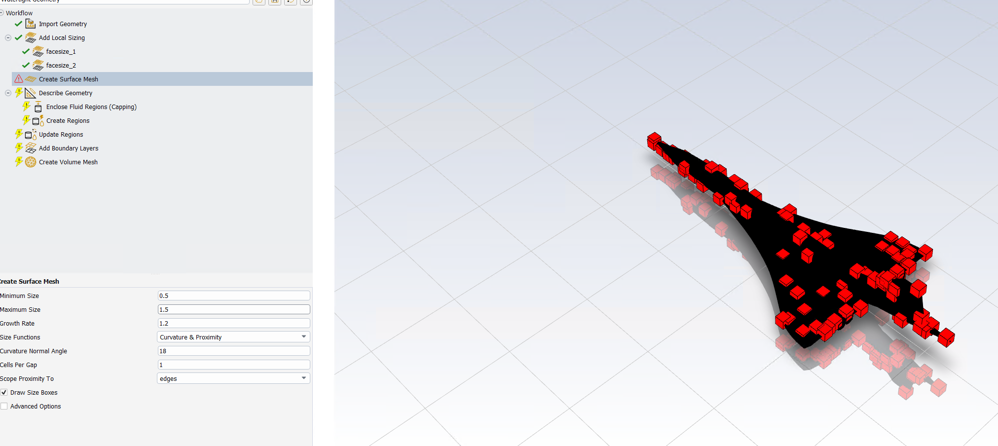

SubscriberHello I am trying to make a watertight mesh using fluent meshing but when I get to that part it is giving me a  error: 608 self-intersecting triangles exist in the model, which is above the limit for automatic smoothing ( 10 ). error object: #f error message. The model is one solid part so I am not sure how to proceed I am very new to ansys the images are below of how I set my model up in the fluent mesh I selected no to the add local Sizing for this try
