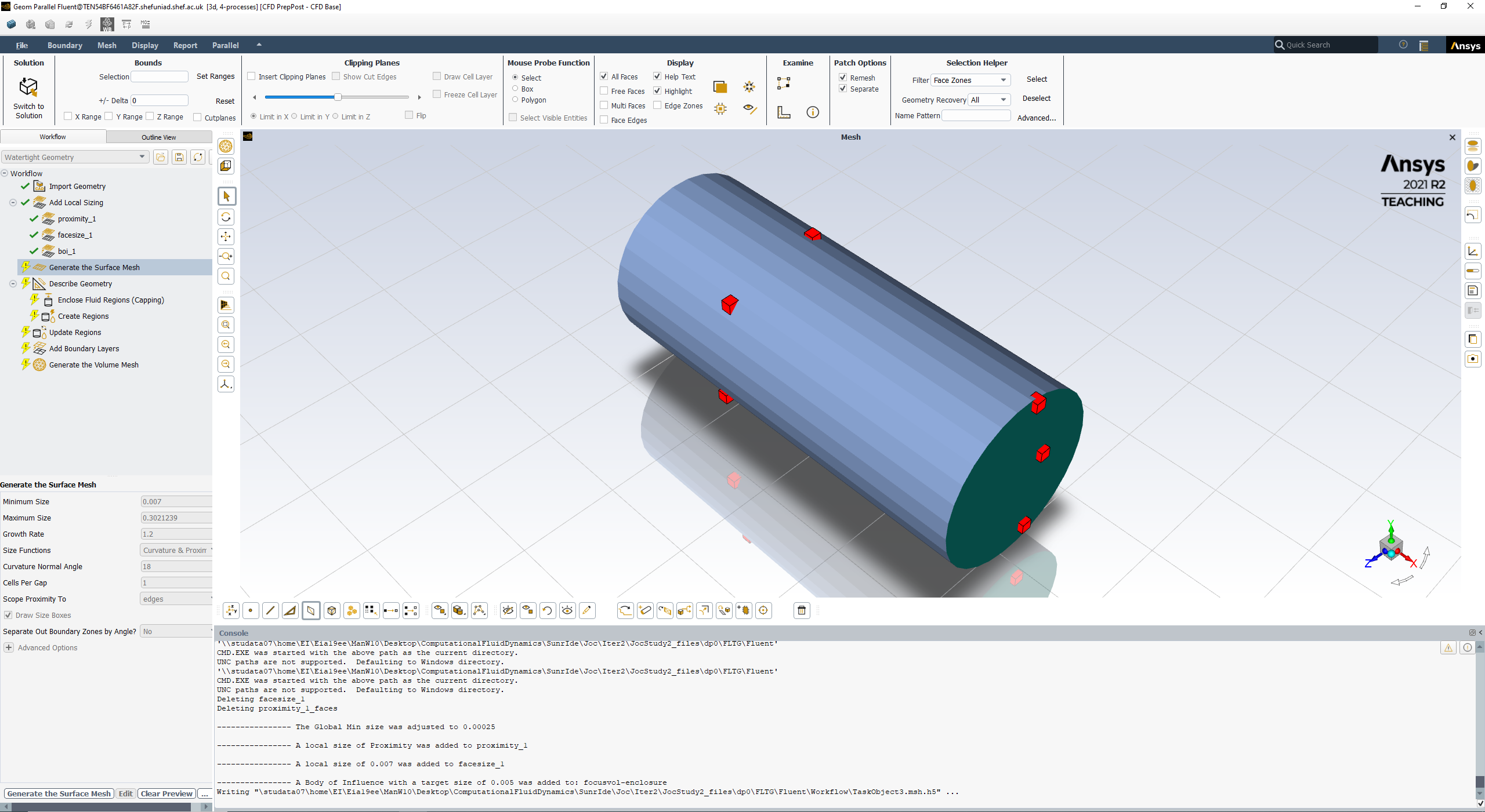

      I'm trying to perform CFD on a rocket body. I've checked the model geometry in Ansys Spaceclaim using their function with no errors. However, whenever I try to generate the surface mesh, it gets stuck with the message 'Writing "\studata07\home\EI\Eia19ee\ManW10\Desktop\ComputationalFluidDynamics\SunrIde\Joc\Iter2\JocStudy2_files\dp0\FLTG\Fluent\Workflow\TaskObject3.msh.h5" ...' as shown below in the console. Could it be problems with the min and max mesh sizes I've set?
      Any help or recommendations would be much appreciated.

    • Keyur Kanade
      Please use smaller path for working directory like D:\Project.
      Please make sure that you do not use any special characters or spaces in the path or file name.
      Also please check if you have sufficient space on you drive for working directory as well as temp directory.
      Try to use latest 2023R1 version and test.
