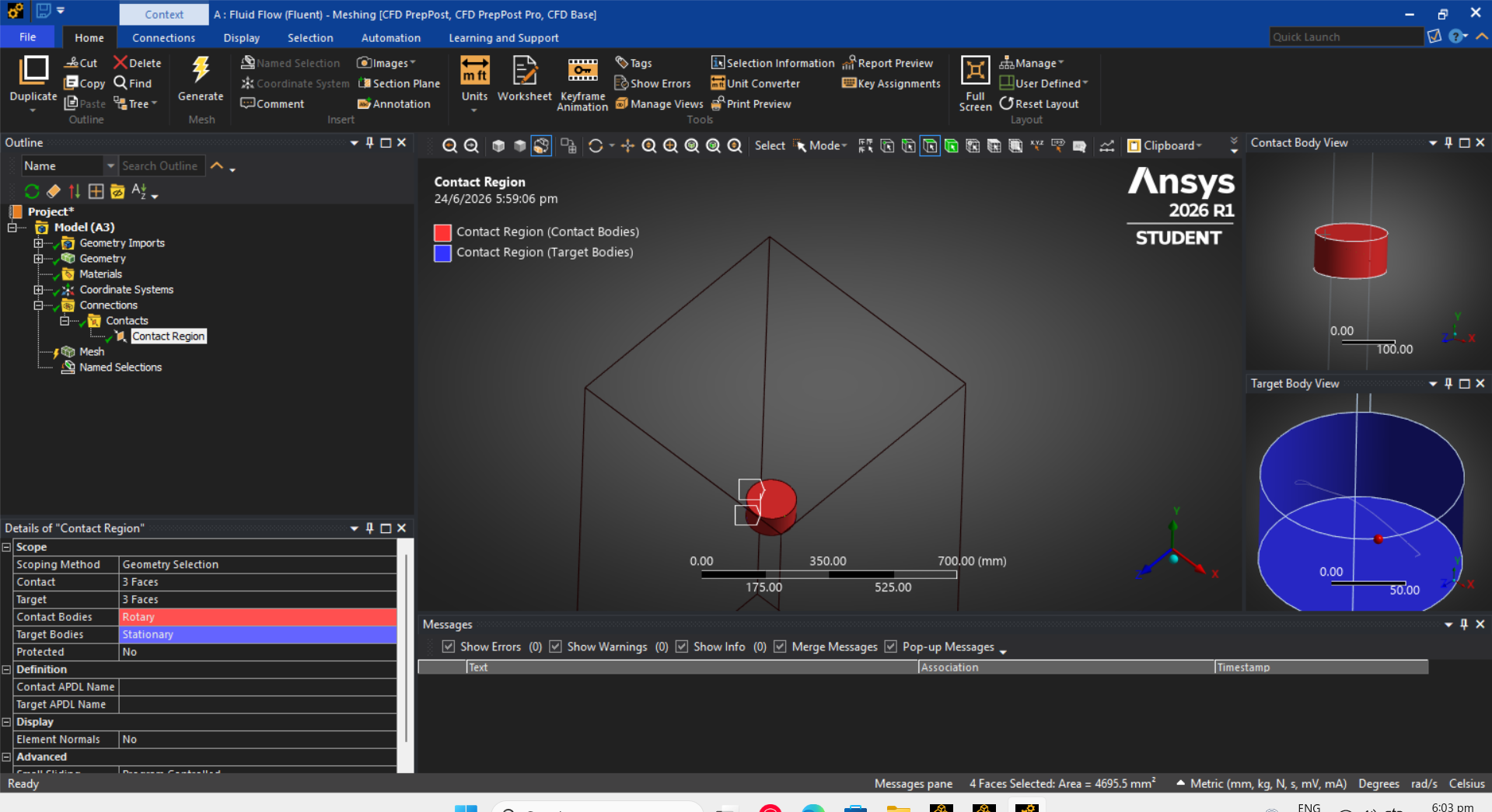

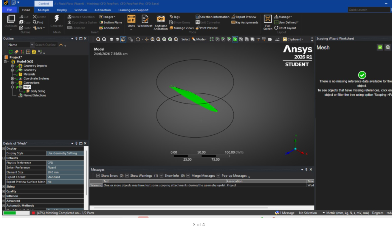

        SCreenshots:
      Have a look in Connections and see if it's picked up the upper and lower surfaces as being a contact pair. Assuming it has, delete the Contact in Connections. There's a function to help Mech users (they need it! ;P )  that causes a few issues with surfaces in close proximity (airfoils) because the profile thickness is small relative to the domain.
      • r.sakthidharan
        This is what is under contact regions, tried deleting it and then meshing, mesh still fails at the trailing edge profile.
      They're correct.
      How many bodies have you got - ie can you check the blade is a void? Also look at the sizing options, are you resolving the blade?
