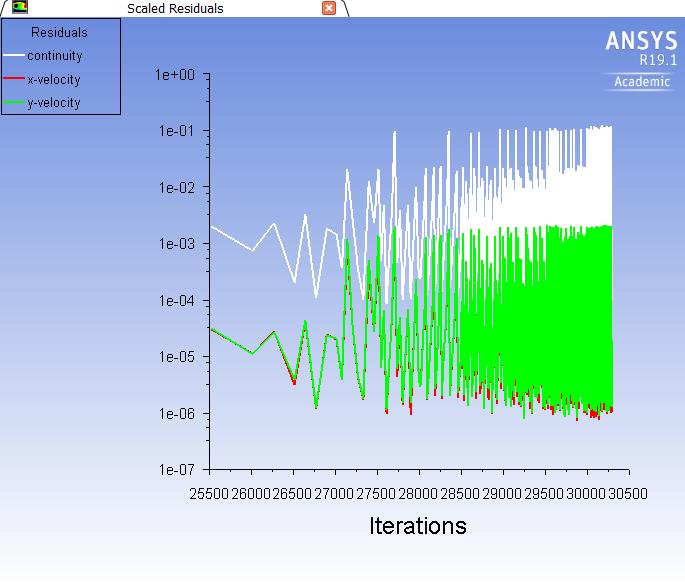

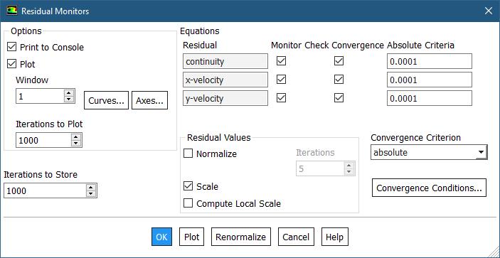

March 6, 2019 at 4:25 pm
Rob
Forum ModeratorWhich solver are you using? Also, how good is convergence with each time step?
