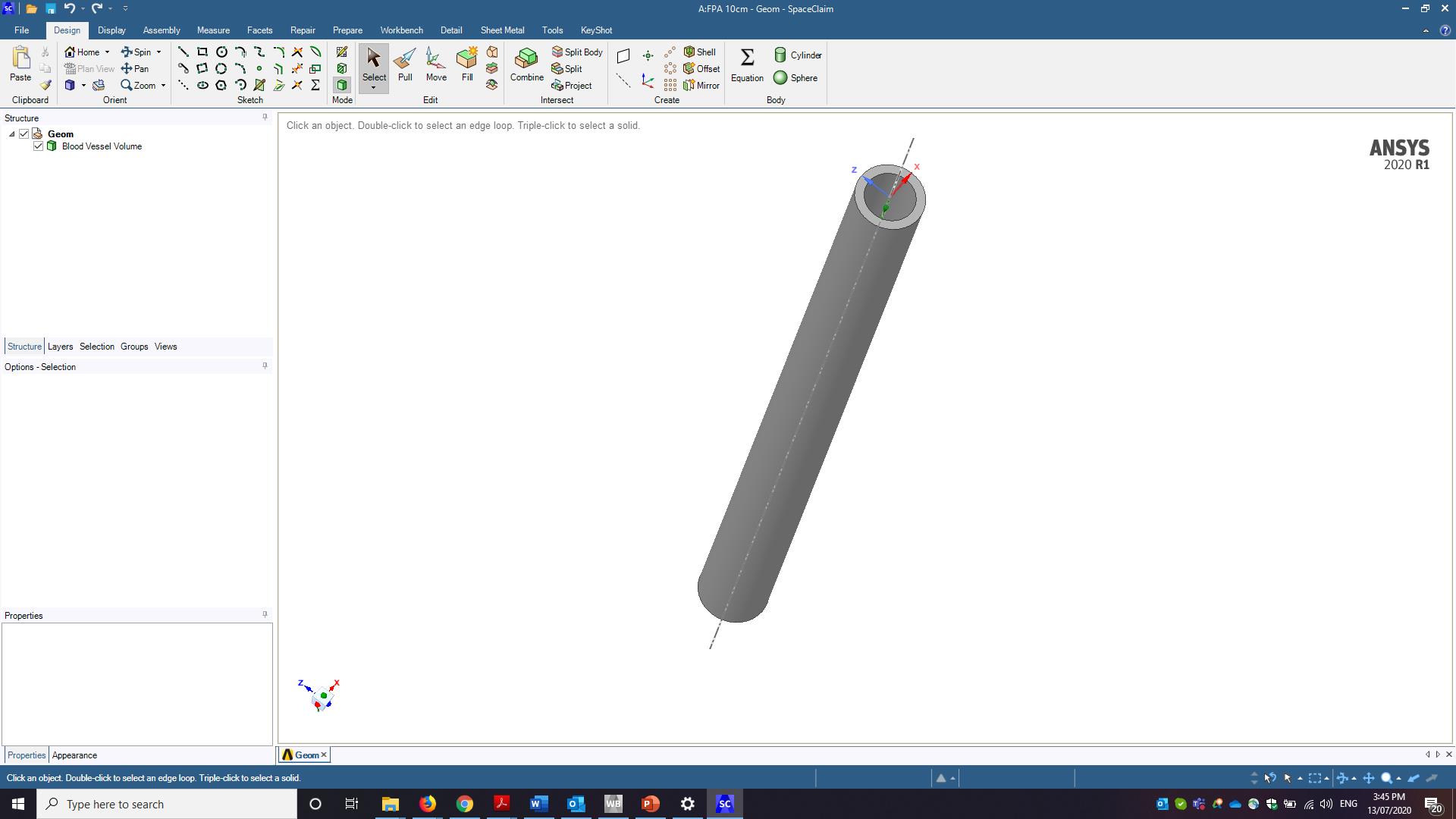

      Weirdly enough, all other software on my laptop look great at 150% and much too small on 100%. Including other Ansys modules which look best at 150% (SpaceClaim for example).
       vs 100%
