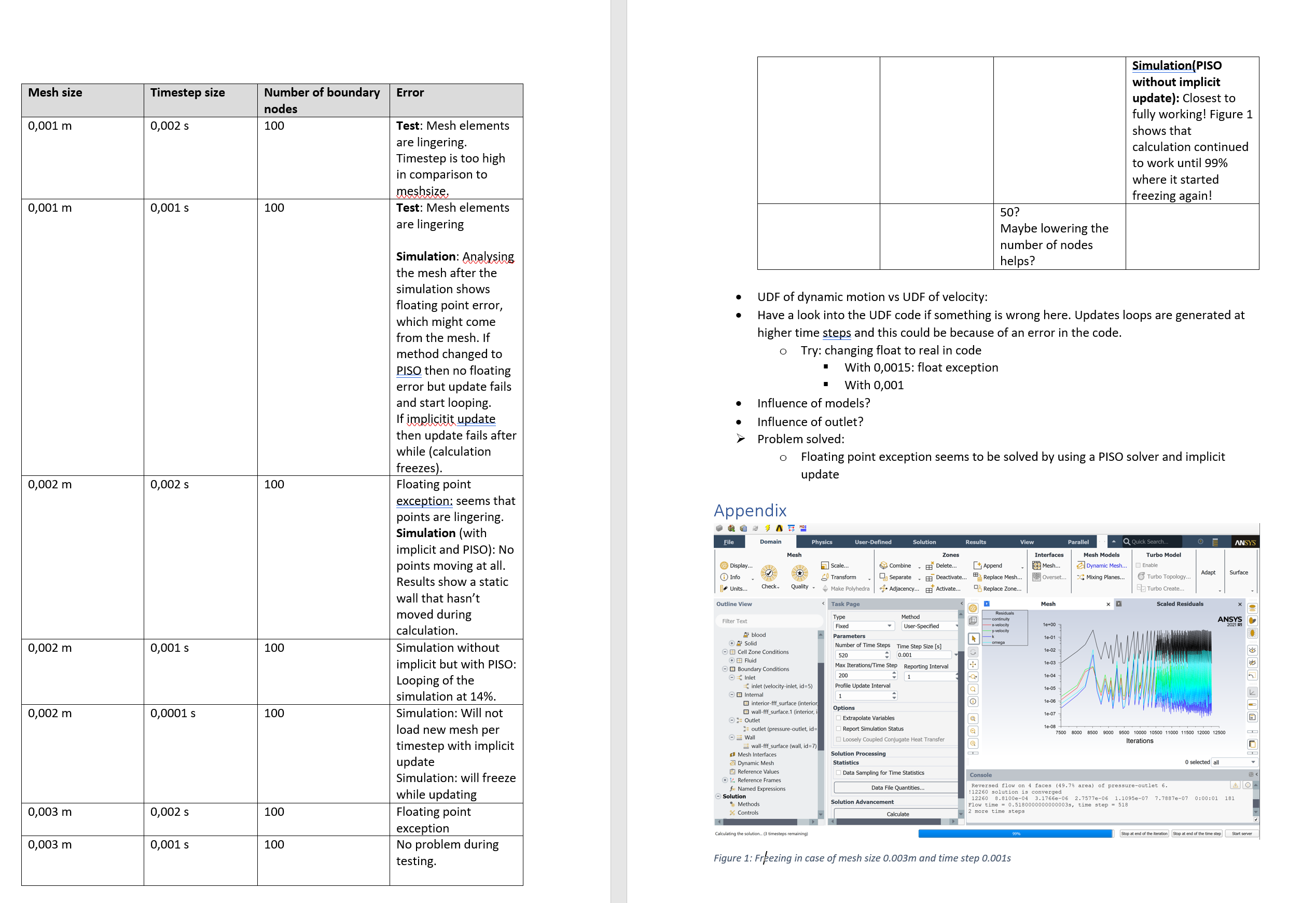

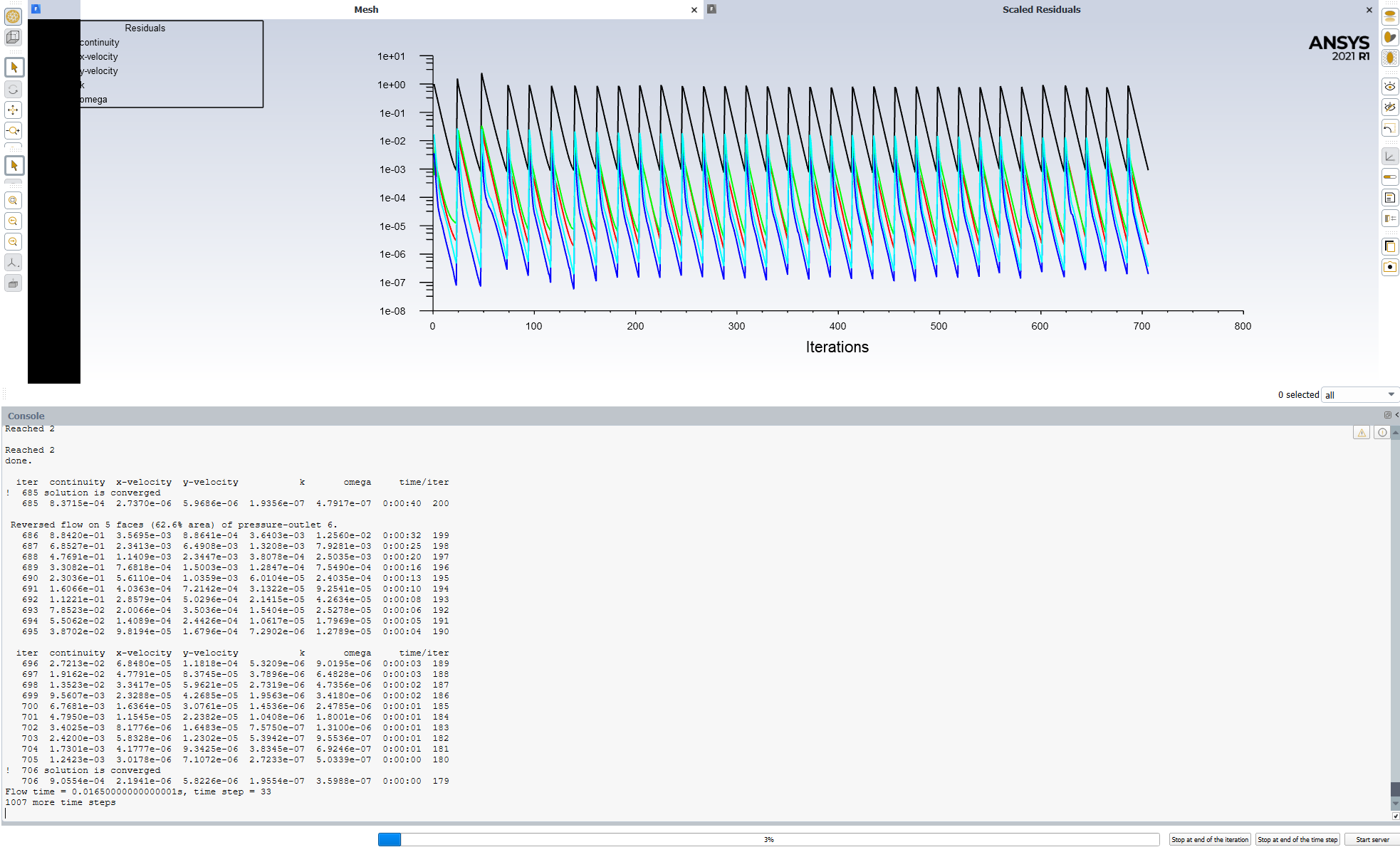

When running my simulation the simulation will start freezing at some point during the calculation. No matter how long I wait, it keeps freezing leaving me with no point than shutting down fluent via the task manager and losing my data.
I've been trying to solve this bug for two weeks but I don't find what seems to be the problem. My setup is as follows: Transient simulation, SST k-omega model and PISO method, multiple udf's (describing wall motion and velocity profile at inlet), outlet as outflow, solving parallel with 6 cores.
When testing the UDF by analysing the dynamic mesh motion it does not give any trouble, so therefore I think the problem does not come from the UDF describing the dynamic wall. The UDF describing the velocity profile is just a simple example from the forum with changed values.
So I tried testing the calculation with different timesteps and meshsize and this resulted in analysis seen in the picture below.
Anyone that knows where the problem is coming from?

October 31, 2022 at 11:27 am
Rob
Forum ModeratorThe solver getting stuck can sometimes mean it's struggling to converge a time step. As you're using dynamic mesh that could be the motion or time step is too high, or that the solver wants to create lots of new cells. If you half the time step how does it behave?

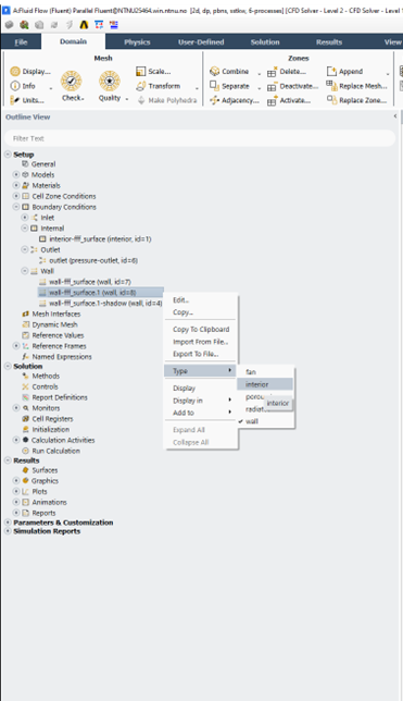

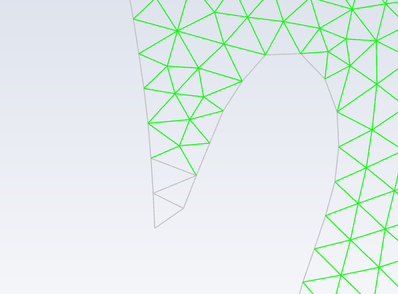

Laurens
SubscriberI think I might just found the issue. In the setup I had to define part of the interior, which was automatically assigned to wall ID by fluent. I now changed the baseline shape of the simulation, making sure that it is automatically assigned correctly. I tested it with a time step size of 0,001 s and 0,005 s, and it works for both.
Is it possible that this was the issue and if so, do you know why this happens? Thanks :)

Rob
Forum ModeratorPass, however, changing topology in Fluent isn't permitted using MDM so it's possible you were breaking something before.
