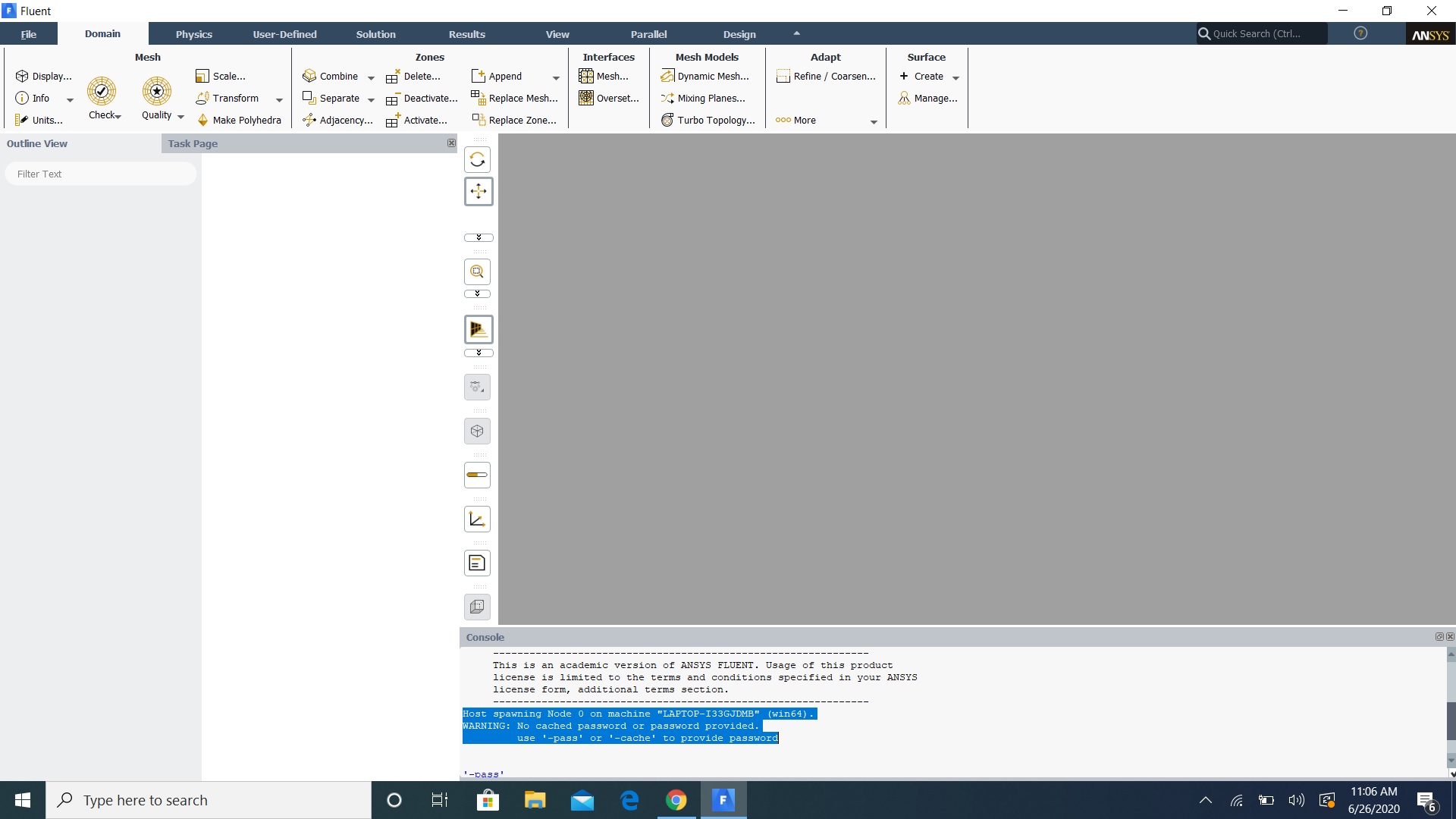

    • dorianrendon
      I am also having a similar problem... my fluent opens, but that's it. I am not able to do anything else.
    • dorianrendon
      The message reads:
      Host spawning Node 0 on machine "LAPTOP-I33GJDMB" (win64).
      WARNING: No cached password or password provided.
      use '-pass' or '-cache' to provide password
      Here is a screen shot
