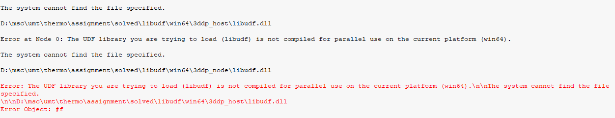

i am trying to solve the tutorial file from ansys: "FLUENT-IC-tut-03_direct-injection"
"Tutorial: Simulate Combustion in Direct Injection Natural Gas Engine Using Non-Premixed Combustion Model"

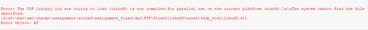

I follow all the steps but when i try to build and load the udf files i receive this error:
May 27, 2021 at 8:50 amRob
Forum ModeratorThe clue is in the second set of text: you're opening a 3d model in the 2d solver.
May 27, 2021 at 9:02 amMay 27, 2021 at 9:22 amRob
Forum ModeratorSo the UDF has not been compiled. Assuming you have the .c file use the included compiler (2020R2 onwards) to avoid all the hassle with the Microsoft compilers.
