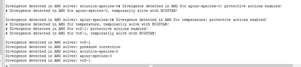

      I am modelling the absorption process by using the Eulerian multiphase model with species transport model along wth energy equation. For mass transfer, i.e. interaction between the phases, species mass transfer model has chosen. Timestep value = 1e-6 has chosen then initialization was done and after that simulation was run and it immediately results in the following error:
      Divergence detected in AMG solver: vof-1
      Divergence detected in AMG solver: pressure correction
      Divergence detected in AMG solver: solution-species-0
      Divergence detected in AMG solver: apour-species-0
      Error at host: floating point exception
      Error at Node 0: floating point exception
      Error at Node 1: floating point exception
      Error at Node 2: floating point exception
      Error at Node 3: floating point exception
      Error: floating point exception
      Error Object: #f
      Calculation complete.
      How to solve this error.

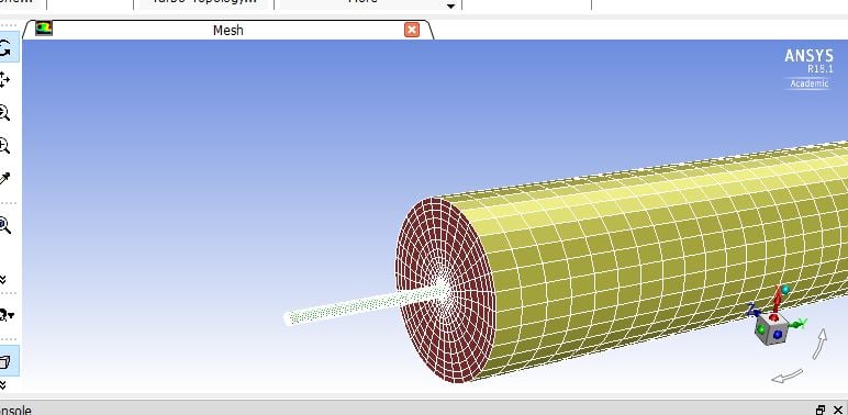

      The geometry is as follows:
      There is a pipe and at the bottom of pipe nozzle is there. Through nozzle gaseous mixture will flow and through the annulus solution mixture will flow. The meshed domain is as shown in below:

      Try to avoid huge cell volume change at the end of the small pipe nozzle. Please use one of the last releases and try again. We ameliorated several things which you are using now.

      For volume cell change, mark cells with cell volume change larger than 2..5: you need to get ride of them.

      I have not said do adaption: I said check the region where the cell volume change is large and remesh accordingly. I also said update to the latest possible release. If then still having issues we can discuss further steps.

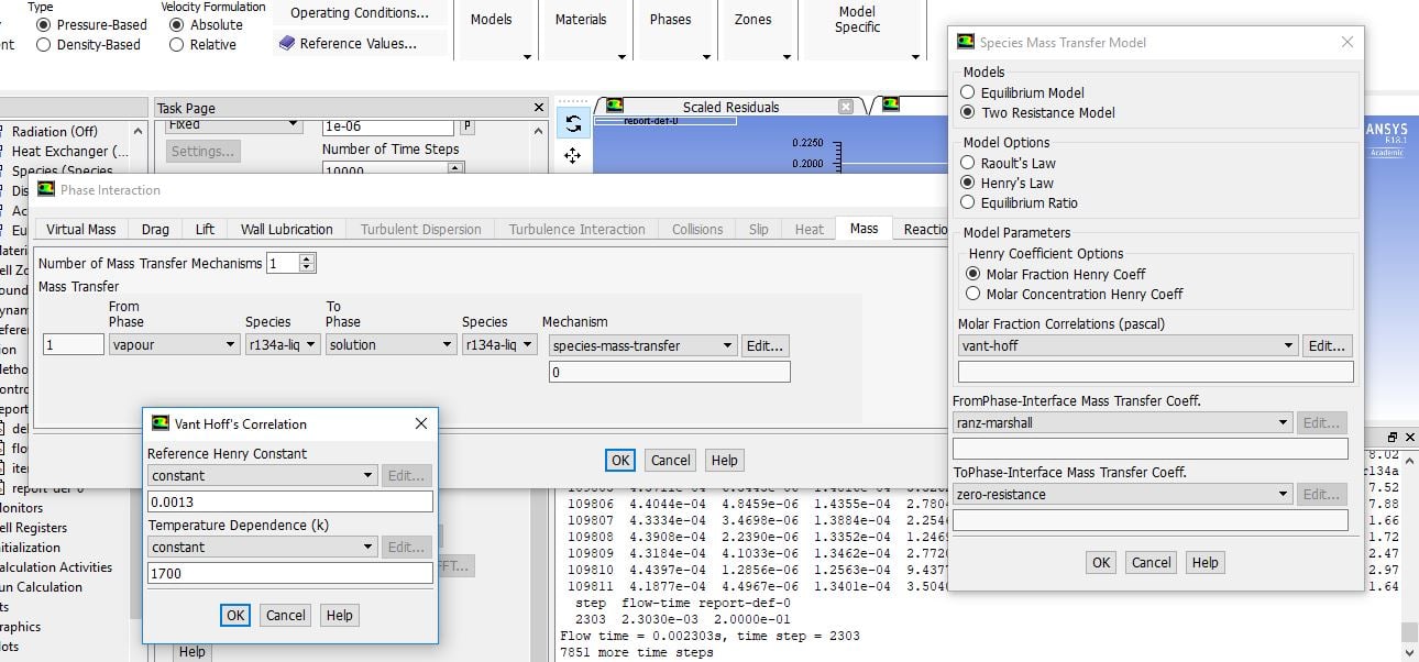

      And the mass transfer is via? Please screenshots of all interaction panels.
    • snr1
    • DrAmine
      Henry's law us for modelling adsorption or dissolution of gas in a ideal solution. Try changing from to phase and use latest release.

      1. Dear sir, according to the theory guide henry law is used for the non-ideal solutions. Here, my application is absorption of gas bubbles in the liquid solution which non-ideal.
      2. I didn't get what do you mean changing from to phase?
      3. Regarding the latest release, my institute currently having 18.1 only.
      4. Will it be possible to model the gas absorption in a liquid solution by using Fluent? If so, which version will be helpful and which models?
    • DrAmine
      1/Check the graph of Henry and Raoult and you will see that is not good for non-ideal solution only when the component mass fraction is small: dilute conditions
      2/You change the phase order in the species mass transfer panel
      3/okay. not good
      4/Yes either with Henry's law or via UDF
