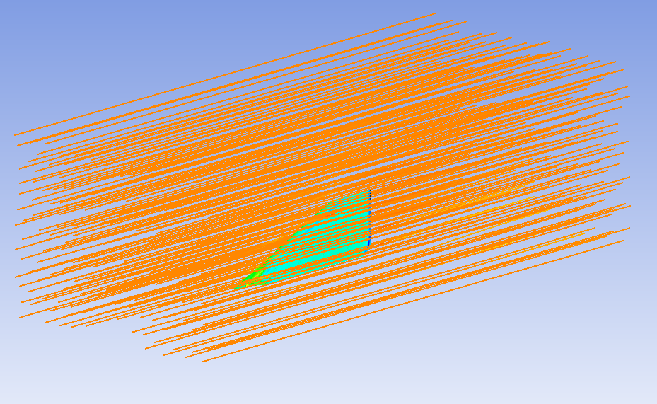

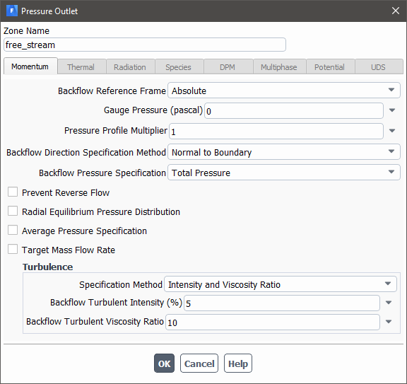

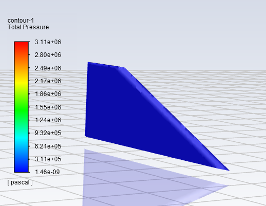

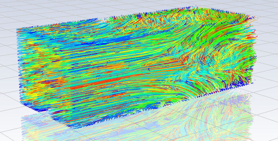

SubscriberHiArray,I understand it's been a while since you responded but I was hoping you might be able to help me here.nAfter doing some work with my two-way FSI simulation, I realized that convergence of the Fluent system was my biggest issue so I have now started to work on that alone.nAfter getting it to solve, I put in a pathline from the inlet and it appears that lots of particles immediately veer off into what should just be a 0 Pa gauge pressure opening, rather than travelling relatively straight through to the outlet. If I start the pathline at the fin wall surface, the same thing happens:the lines immediately shoot towards the nearest opening surface. I plot 400 pathlines, and none of them even come close to going through to the intended outlet. This results in a basically nonexistent pressure profile on my fin geometry.nHere is a screenshot of my pressure-outlet settings:n

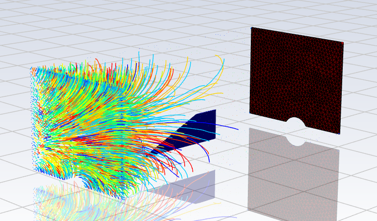

And here is the resulting pathline in Fluent:(the outlet boundary is the surface on the right, and a pressure contour on the fin is included)n
Versus what I see in CFX using the opening boundary condition:n
Have I just set this up incorrectly with the wrong settings for a properly behaving free stream style opening?n
November 11, 2020 at 10:56 am
Rob
Forum ModeratorHave a look at the flow field and pressure (contours) to see what's going on. If you have one inlet and multiple outlets why would the flow prefer one over the other? n -
November 11, 2020 at 5:29 pm
DrAmine
Ansys EmployeePlot velocity vectors at mid plane and add more details about all BCs.n -

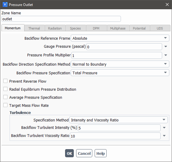

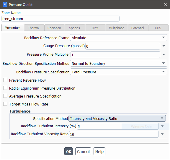

SubscriberHiArray, nI'm not sure what you mean by flow field I already show what the particle pathlines look like coming from the inlet, but the pressure contours on the fin are basically nonexistent, especially compared to CFX. It doesn't make sense to me why the flow would favour one outlet over the other. My only guess is that my settings for the free stream outlet are incorrect.n

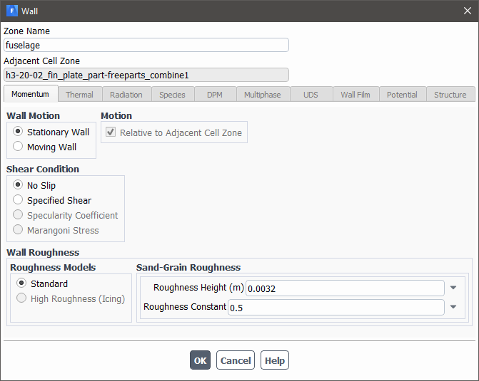

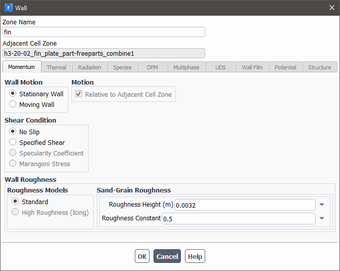

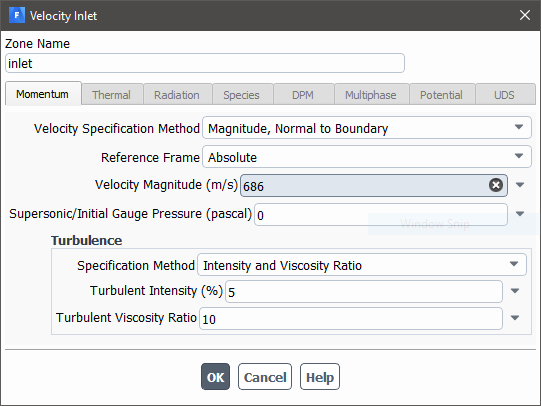

Array, See below for all the boundary condition windows. For more reference, I'm using the pressure-based viscous physics model with default k-epsilon. I don't know what you mean by velocity vectors at mid-plane though. Boundary conditions are inlet, free stream, outlet, fin, and fuselage:n
Please let me know if any of these settings could be what is causing my problems. Once again, I've just tried to recreate the same case as what I have been working with in CFX.n
November 11, 2020 at 7:37 pm
DrAmine
Ansys EmployeeModel settings CFX vs Fluent ? Compressiblity effects? Convergence in Fluent? n -

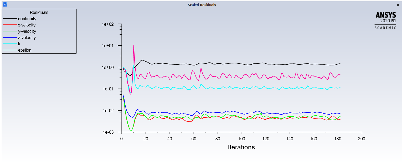

SubscriberI just realized something that could have been causing issues. I did not set a value for number of iterations in the calculation, so it must have only been calculating once. I now set it to 20 and then ran it again at 150, and the results look better but still not great (it could just be that Fluent is more detailed than CFX and these results are more realistic)n
nModel settings CFX vs Fluent ? I can paste screenshots of the setup in CFX if that would help. I'll open it up now and try to summarize. Air as ideal gas, continuous fluid, 1 atm reference pressure, non-buoyant. Heat transfer is by total energy, k-epsilon for turbulence. The inlet follows a supersonic flow regime, 0 Pa relative static pressure, 686 m/s, high intensity turbulence, 2.5 degrees C static temperature, outlet is supersonic as well. The walls are no-slip with 3.2 micron roughness, adiabatic heat transfer. That's basically it for CFX. Let me know if I'm missing any details. nCompressiblity effects? I'm not sure where to check this, the tutorials I have been following never mentioned it.nConvergence in Fluent? I don't know how to check convergence in Fluent alone. I used this same setup with system coupling for two-way FSI and Fluent was not converging, so now I am diving deeper into Fluent. Here is a plot of the residuals though: n
Maybe I just need to run for more iterations? This just becomes a problem for FSI as my computer can only handle so much. It took nearly an hour and a half to run 200 iterations of the coupled FSI system, and I need to increase that already as I want to get more than just one second of real time simulated. n

Forum ModeratorThat solution isn't converged, you're looking for flow residuals below 1e-3 and good mass conservation. Some of this is covered in the tutorials. nLooking at the fin, how much does it move? FSI is good where the flow is affected by the moving geometry, it's less necessary where the two are fairly decoupled. Focus on the flow side of the model and work through the tutorials to get a good flow solution. Then apply that to the FSI problem. nGases are assumed to be compressible above about 0.3M This is a rule of thumb so can be bent somewhat, however 686m/s in air would be over Mach 2, so you'll have shockwaves to contend with too. You definitely need to get the CFD model right before trying FSI under those conditions. n -
November 12, 2020 at 9:42 am
DrAmine
Ansys EmployeeThat solution isn't converged, you're looking for flow residuals below 1e-3 and good mass conservation. Some of this is covered in the tutorials. Looking at the fin, how much does it move? FSI is good where the flow is affected by the moving geometry, it's less necessary where the two are fairly decoupled. Focus on the flow side of the model and work through the tutorials to get a good flow solution. Then apply that to the FSI problem. Gases are assumed to be compressible above about 0.3M This is a rule of thumb so can be bent somewhat, however 686m/s in air would be over Mach 2, so you'll have shockwaves to contend with too. You definitely need to get the CFD model right before trying FSI under those conditions./forum/discussion/comment/97073#Comment_97073
I agree with Rob here. Forget about FSI first. As you have supersonic flows. providing a velocity inlet boundary is lazy as stagnation properties are not fixed. Here the recommendation to provide total properties.n -

Ansys EmployeeIf flow is compressible and that is compressible with your large Mach number a velocity BC is lazy. Total pressure, Total Temperature, Direction of Flow, Static Pressure are required at supersonic inlet!n -

Ansys EmployeeSo basically you did not account for compressibility of flow. Now enable energy equation and try to use pressure inlet boundary.n -

SubscriberArray, I think I found the one you mean. There's some helpful stuff in it that should hopefully help me get a bit further with this. Thanks for the advice.nArray, when you say enable energy equation is this checkbox what you mean? n
I have that activated and energy equation is selected under solution>controls, but I'm unsure what you mean now by using the pressure inlet boundary? If I change the inlet to a pressure inlet then I cannot define the velocity. Do you mean to calculate the dynamic pressure based on the defined velocity?n

Ansys EmployeeYes:again compressible flow (ideal gas EOS to get started) requires pressure inlet or far field. You can for sure use velocity boundary but that is again lazy but can work. n -

Subscriberthank you. I just want to make sure I'm understanding the documentation for a pressure inlet (compressible, supersonic flow) correctly. This is the equation given for calculating the Gauge Total Pressure:n
In this equation, p_s is the Supersonic/Initial Gauge Pressure? Is p_s intended to be calculated with Bernoulli's equation using the operating pressure as the reference, or am I getting this mixed up?n
November 13, 2020 at 7:17 pm
DrAmine
Ansys EmployeeNo using isentropic relation ( what you shared). Ps being an absolute static pressure. n -
November 13, 2020 at 7:27 pm
simonhackett
Subscriber,sorry I think I might be getting confused. So the Supersonic/Initial Gauge Pressure is also calculated with that isentropic relation?n -
November 13, 2020 at 7:30 pm
DrAmine
Ansys EmployeeNo: the relation is to get the link between total and static pressure. You need to know both or you know static and Mach or Total and Mach. That is an input.n -
November 13, 2020 at 7:37 pm
simonhackett
Subscriber,I don't really understand what the Supersonic/Initial Gauge Pressure is calculated based off of then. Really all I know for this are the operating pressure (101325 Pa) and Mach.n -
November 13, 2020 at 7:38 pm
DrAmine
Ansys EmployeeThen you miss an input. n -
November 13, 2020 at 7:46 pm
simonhackett
Subscriber,oh I see. I was under the impression that both fields were required. So then I would input my total pressure, using the isentropic equation, with operating pressure used as reference?n -
November 13, 2020 at 7:50 pm
DrAmine
Ansys EmployeeNo you need to know either one of the pressures. Look You do not know rge static pressure at inlet that is something what you actually need to know if you are supersonic. For that reason you need to live with velocity inlet.n -
November 13, 2020 at 7:56 pm
simonhackett
Subscriber,so what you're saying is that because this problem is theoretical and not based on measurements (of either static or total pressure), I can't use the pressure inlet boundary.n -
November 16, 2020 at 10:22 am
Rob
Forum ModeratorYou can, but you need to know the total pressure. If you look at the NACA airfoil examples (YouTube etc) one of them should run through the calculations. Basically, the data is needed to get the incoming gas density correct. n
