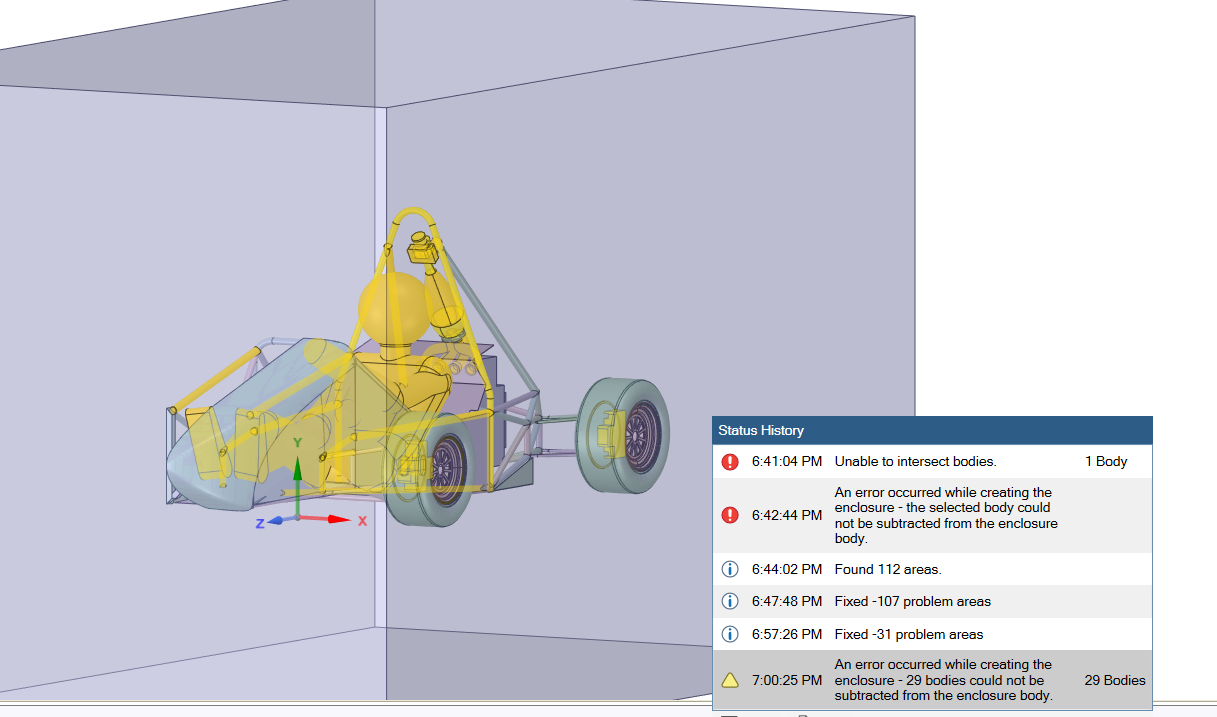

      I've been trying to make an enclosure for my FSAE car assembly for days now, but I keep getting various error messages, such as "couldn't extract body," and so on. I've repaired and prepared the assembly multiple times, but none of them seem to work. Now, when an enclosure is formed, I get this result:Bodies Selection

      enclosure result

      Hey ,
      First of all you need to simplify you cad model to extract the body and run the simulation.Before moving forward, please go through FSAE course attached here.  :Aerodynamics of an FSAE Car | Ansys Innovation Courses
