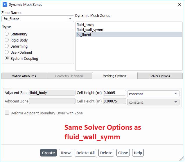

      In the Dynamic Mesh I have the boundary as System Coupling with Cell Height 0.001. I also have the fluid_body as Deforming with Remeshing and Smoothing enabled.

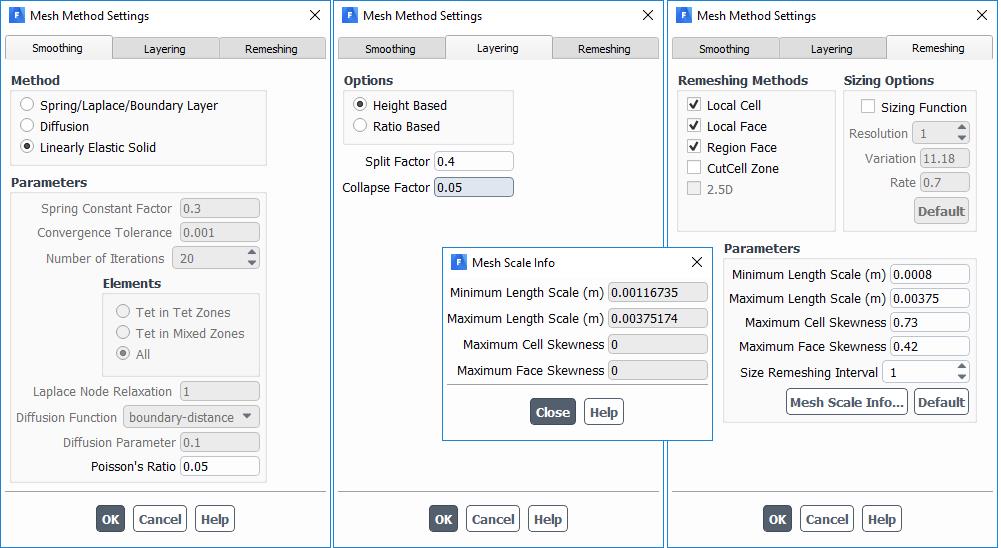

      • Could you please share the remeshing settings under 'Mesh Methods Settings dialog box so we can understand it better? I'm looking for the Parameters you might have used. This might also help us understand the 'switch values' issue you are facing?

      • It is definitely not re-meshing at all.  I see the cell count every time it writes a solution file, and they are always the same. I am defining both local and region methods.  Is this not preferred?  Should I choose one or the other only?  If so, it would be a great feature enhancement for ANSYS to make these choices exclusive to each other.
      • The 'Mesh Methods Settings dialog' is shown below.  Though in another post I was informed that I don't necessarily have to set the interior_fluid_body as a deforming zone because it should be taken care of when I set the fluid_body as a deforming zone.  Is this correct? If so, that might help me to understand why I kept getting those warnings and why the values were switching.

      Update:  I did get this to run for 20 time steps by taking the interior-fluid_body out of the dynamic mesh, but there is still no layering or re-meshing taking place that I can see.  I need to go to 100 time steps and I am afraid this will fail again without those two things.

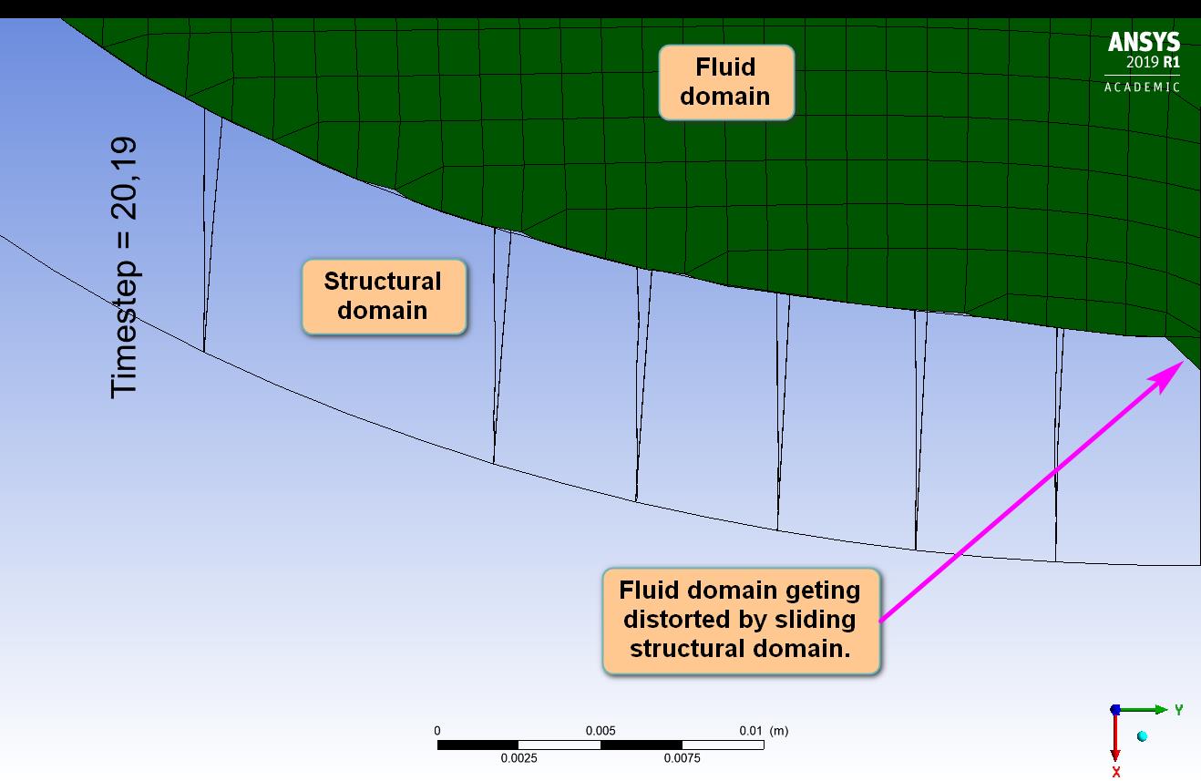

      Also, another concern has appeared.  As the solid zone contracts, which drives the flow, I notice that the corner of the fluid zone is getting distorted.  The solid structural zone is supposed to slide there and the fluid zone should move with it but it looks from the image as if it is penetrating the solid.  This can also be seen in the gif.

      What is going on with that distorted/pinched corner in the fluid domain?  Basically every portion of the boundary between fluid and solid I have set as part of the fsi_fluent zone which is coupled to the structural and so it should deform as needed - I would think.

      Do you have any ideas about the pinched corner where the structural mesh slides, from my last reply?
