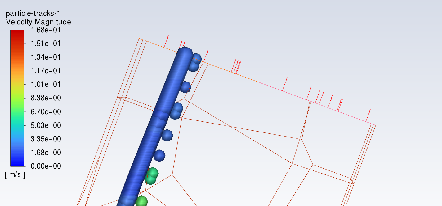

September 14, 2023 at 9:07 am
adrian.sieradzki
SubscriberÂ
Here are my particle tracks near outlet
Decreasing flow rate/increasing particle size leads to the unresponsive behaviour, as can be seen the particle tracks are so close together they are overlapping. I am running this on a PC with RTX4090 so not sure how it could be not strong enough to render out all particlesÂ
Using "track" i.e. only running the DPM does not result in unresponsive behaviour.
September 14, 2023 at 10:39 am
Rob
Forum ModeratorThat looks like a load of parcels following the same track. It may be a result of the angle/slice but the mesh doesn't look overly well resolved either.Â
September 14, 2023 at 11:12 am
adrian.sieradzki
SubscriberNo, I am simulating an effect where particles get foused into narrow streamline based on diameter. That's the point of my experiment. Why would you say mesh doesn't look well resolved? My cells are too large?Â
September 14, 2023 at 11:23 am
Rob
Forum ModeratorCells are large relative to the channel. You need good near wall resolution for the y+ checks, but what is never made clear in academic courses is the need to resolve the rest of the flow too! I'd prefer a much more gradual jump in cell size from the inflation. Plot a contour of velocity on the centre plane with node values off - how does it compare to node values on?Â
DPM particles can only see the wall (for collisions etc) when in the near wall cell so you may be underestimating wall contact.Â
