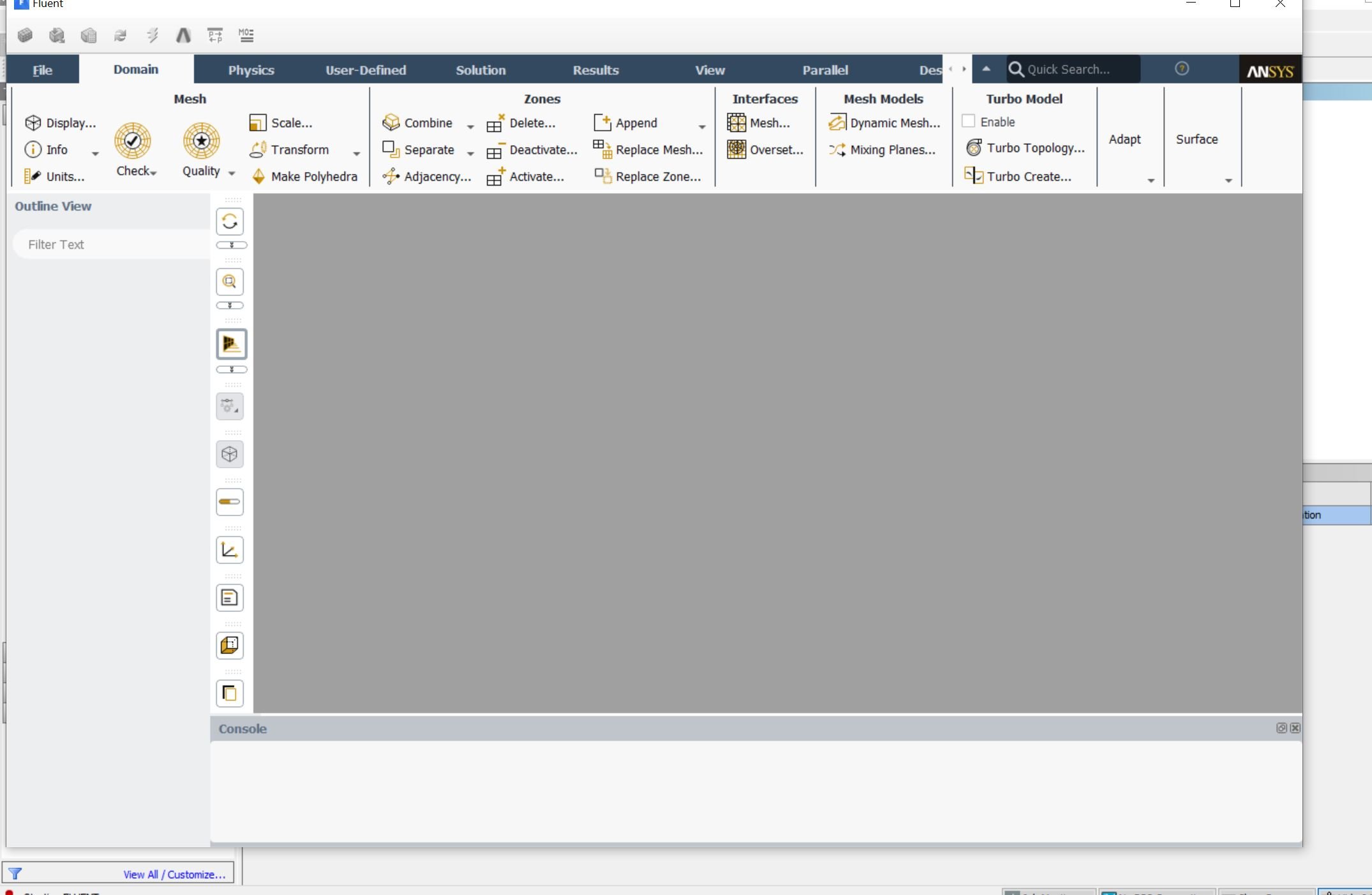

SubscriberHello guys. I'm new to ANSYS products and I'm not sure if I am doing something wrong, but I have installed ANSYS 19 r3 and all apps but fluent seem to work fine. I cannot find any files on fluent including executive. It does appear in the Workbench, But when I open fluent with setup option the program starts, but never loads up, all the tabs seem to respond to mouse movements but NOTHING works or loads and the mouse shows the loading icon.(I get it I must sound stupid here, but i don't know how to better explain) I tried reinstalling several times. Now i installed the 2020 version and it still has the exact same issue. Please, if anyone knows how to solve this issue, help guys!
Eventually fluent closes by itself and workbench gives me a message: "The Fluent application failed to validate the connection"

Ansys EmployeeLet's focus on 2020 R1
Open CMD Prompt and issue the following command
"%awp_root201%fluentntbinwin64fluent.exe" 3d -t0
do you get the same issue ?
If so, try this command
"%awp_root201%fluentntbinwin64fluent.exe" 3d -g -t0
then, take the screenshot of all of the output showing up in the CMD Prompt window , and post it inline here.
Thanks,
Win

Ansys EmployeeThat's actually one of the main Fluent processes that needs to be launched. If this is missing in your machine, something is not installed successfully.
Do you have an install.err file under C:Program FilesANSYS IncANSYS Student ? If so, please post its content here.
If the file doesn't exist, try reinstall ANSYS again, this time make sure you completely remove the C:Program FilesANSYS Inc folder first, and you run setup.exe with 'run as administrator' and that you temporarily disable any security software you have on the machine.

SubscriberI only have install file, i coppied the content of it below. No install.err files and there seems to be no errors there. I have tried reinstalling it several times by now, and i was deleting the folder each time after uninstalling. Is there any way of just downloading the file separately and just copying it in?

April 5, 2020 at 10:49 pm
arman1armament
SubscriberHey win! i had copied the fluent folder from a different device, as you have recommended and I still have the same problems. Also, when i directly run the fl2010.exe, be it in 3d or 2d whatever, it tells me that libansysfluidfactory.dll file was not found. Idk if that might have anything to do with it, but with the remote studying I really need fluent working. Do you, maybe, have any other tip for me? Thank you
April 7, 2020 at 12:20 am
tsiriaks
Ansys EmployeeHmm, can you post the output of theÂ
set
command from CMD Prompt ?
Also, try disabling your Windows Firewall for now just to make sure it's not causing the issue.
