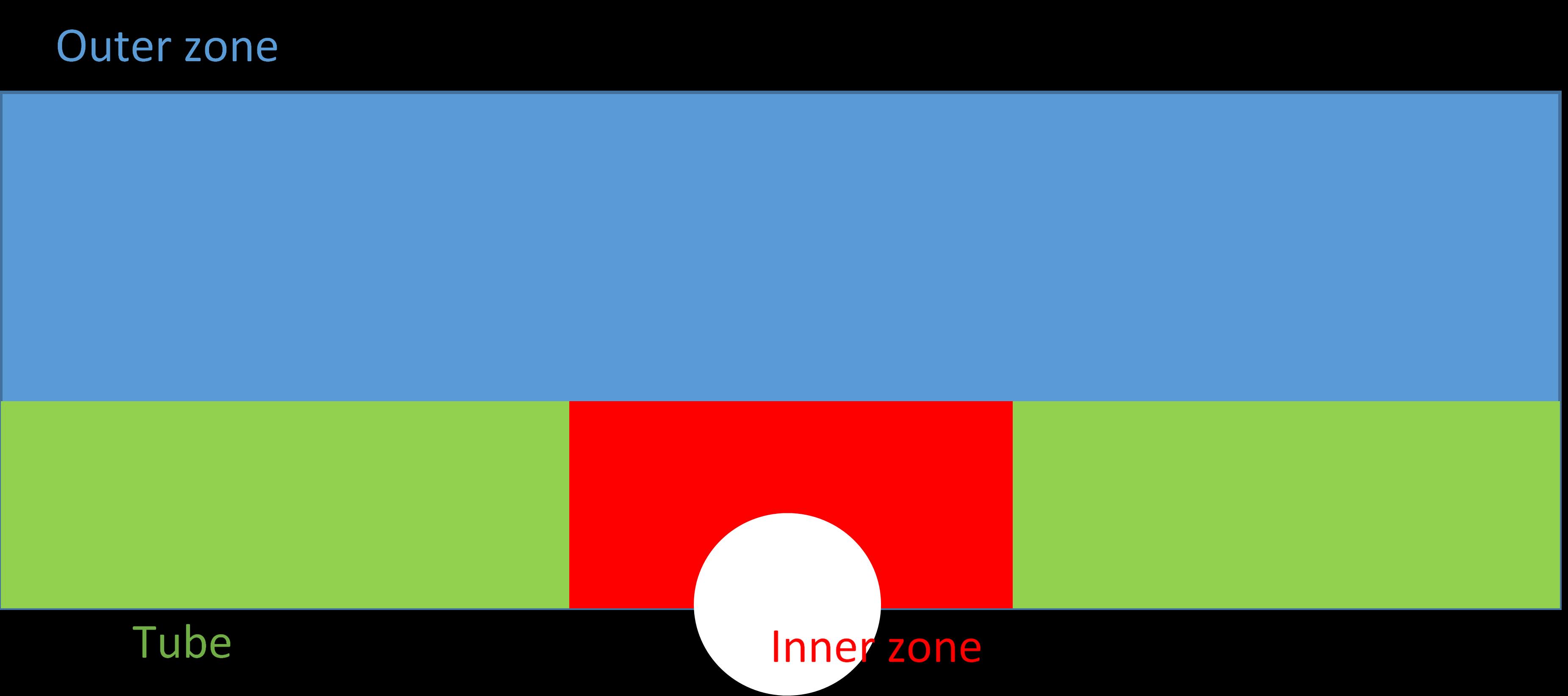

      Just to make sure I understood your suggestion: do you mean a geometry like the one below?
      If that is indeed the case, how do I tell Fluent it should use Layering in the tube layers next to the inner zone? As of now, it doesn't let me choose an adjacent zone to the Inner zone, so I cannnot even set the ideal height for the adjacent layer.
      That's the one, assuming the black strip isn't part of the model, ie the symmetry is black:green contact.
      You move the red zone using whatever method you want. Have a non-conformal interface between red+green & blue. Layering will occur in the green zones. Red moves and is not remeshed. The how isn't something I know much about: can advise, but if you look in Help for IC (in cylinder) examples you'll see the process.

      The black zone is not part of the model, just a background.
      Understood. I will try that by next week and let you know if it solved my issue.
