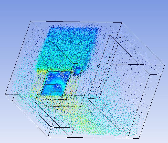

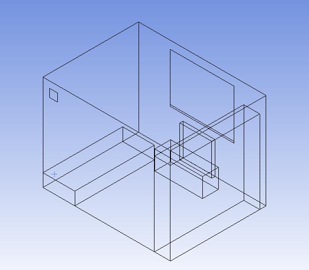

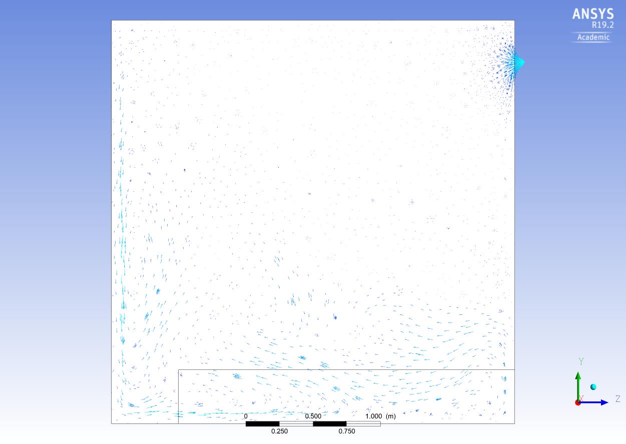

SubscriberHello, I'm trying to create air movement model in room in ANSYS Fluent.
I've created a room and some furniture inside. I've created solid cell zones for furniture, so air can't go throw them. But rezults of calculation show that air easily goes throw them, like the room is empty.Â
You can see it on the screenshoots. In boundary conditions I set up faces of furnitures as "wall". I've watched a lot of video examples and it seems a make everithing correctly, but still have the same problem( What i am missing? I have no idea((

Ansys EmployeeCan you work a step back and check if you do only have one fluid zone? Check in Fluent. Best to create surface zone for each fluid domain and display it as face. Otherwise from this not very clear picture I will say rendering issue. -
