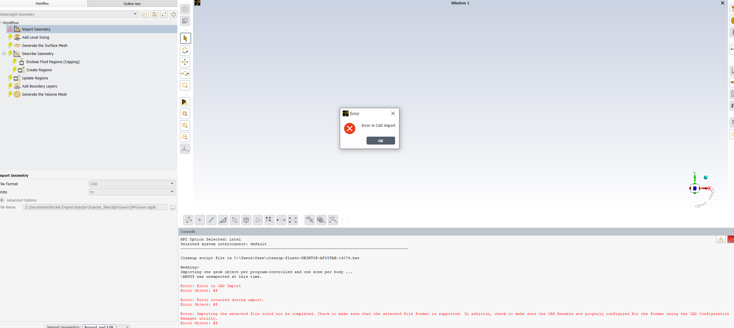

SubscriberSorta getting really frustrated with this software, nothing ever works as it is supposed to... Trying to run a simple fluid flow problem for an injector design but I can't even import ANY geometry. Even if I build it in Design Modeler or SpaceClaim, same results "Error in CAD Import". Yes, so descriptive on telling me why it cannot read a simple file in Fluent but can open the file in any other damn package in ANSYS...

Forum ModeratorAlso, try running from C:\users with no spaces in the path. The Workflow is script based and sometimes failed for paths with spaces and/or mapped drives. It REALLY doesn't like OneDrive....

SubscriberThat is what I did, I said so in the second paragraph of the post. The help section offered no troubleshooting, only gave instructions on how to set it up. Which I followed and it did not work. And there are a bunch of CAD configuration problems on the forum and not a single one with an answer on how to solve this. I've seen this import error as far back as 2017, yet apparently nobody knows why it refuses to work.
Tried deleting the spaces, error message came back saying the specified pathway does not exist. The spaces are critical it appears.

SubscriberSpent an hour trouble-shooting with ANSYS, we found the problem. ANSYS was saved on my Z drives Program Files (x86) folder. IT CANNOT BE SAVED THERE, for whatever reason, the (x86) conflicts with Fluent's CAD import. The solution was to instead create a Program Files folder in the Z drive and install ANSYS there.
