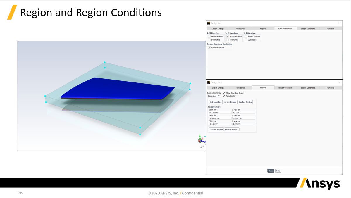

SubscriberHello everyone,
I am quite stuck in the adjoint solver. How can optimize the wing without changing the airfoil chord while doing the 3D wing optimization in the adjoint solver ?
I have already checked the 'design conditions' tab in adjoint solver options. But I am not sure how to use them to get it done.
Thanks in advance.

Ansys EmployeeYou can use Fixed-Walls-Constraint or Rigid-Body depending on your application. You can find more information about Design Conditions here: 43.2. Using the Adjoint Solver (ansys.com)

Ansys EmployeeOne way you can do this is to orient the wing so that the zero angle of attack orientation is aligned with the x-z plane and the only allow y motion when you calculated the design condition. This is illustrated in the slide below. This wouldn't constrain the camber line but then is that desirable?  If the camber needs to be preserved, then all you can really do is try to optimize the thickness distribution about the camber line. This would be challenging in 3D.
September 22, 2023 at 9:02 am
Aras karimi
SubscriberThank you for your answer.
1) Is it possible to constraint the movement of the wing in X and Z directions in other angles of attack or can this be done only in the angle of attack of zero degrees?
2) If I want to keep the camber line during optimization, how can I do this?

SubscriberHi Dear Murari,
I followed your suggestion exactly and constraint the movement of the wing in x and z directions. I used the ’Radial Basis Function' morphing method and considered the size of the adjoint box as its default.
After performing the optimization at the angle of attack 7 degrees using the gradient based optimizer, the optimizer stopped automatically and had optimized the geometry sixty times. According to the figure below, the final geometry has a very deformed TE, which is no longer a wing:
What should I do to solve this problem? Â Are there any other settings I need to apply?
Is there any other way to fix the chord length during optimization?
I used the bounded-by-surface design condition and failed.
I will be really grateful if you help me. Thankyou
