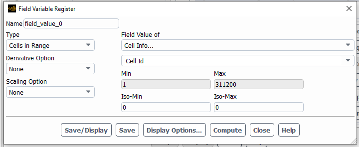

      I was wondering if there was a way to specify which specific cells to adapt. For example, if I do my adaption threshold calculations outside of fluent and I find I need to adapt cell number 101, can I specify in Fluent to adapt only cell #101 either through the GUI/TUI or some sort of UDF?

      You can use the Field Variable register and create a cell register based on cell ID. Here is an image for reference.
      Hope this helps.
