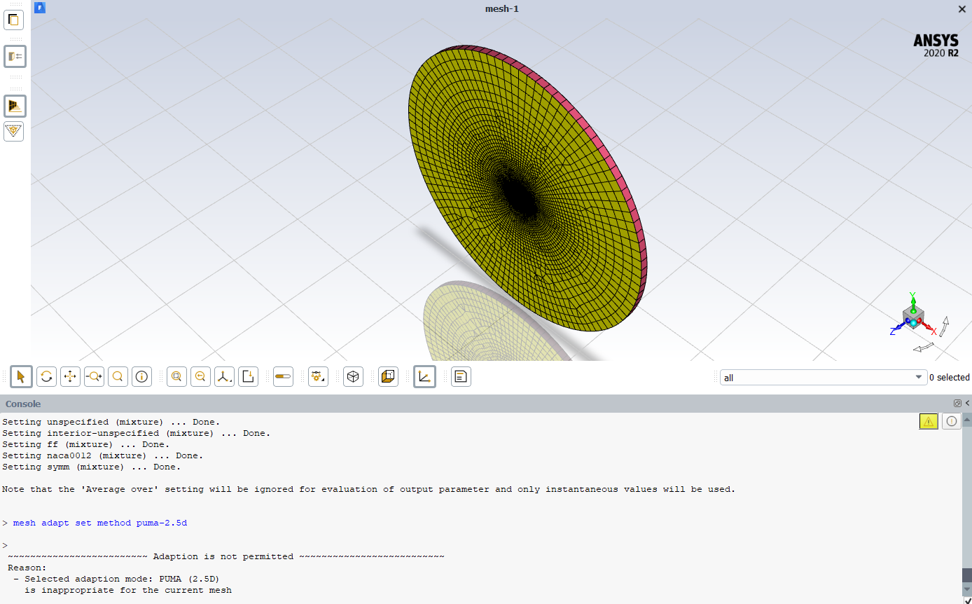

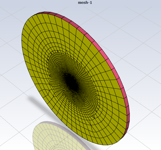

As a follow-up to my earlier question (https://community.ansys.com/?status%2F38737-38737-1658880053%2F), what do you mean by the mesh is revolved but is not 2.5D? It is still a one-cell thick mesh, which is what is specified in the documentation.
If I cannot revolve/rotate the mesh, and have to just extrude (translate), that doen't seem to work either. I tried to just extrude another 2D mesh to make it one cell thick, ie 2.5D, and I get the same error message:
"~~~~~~~~~~~~~~~~~~~~~~~~~ Adaption is not permitted ~~~~~~~~~~~~~~~~~~~~~~~~~~
Reason:
- Selected adaption mode: PUMA (2.5D)
is inappropriate for the current mesh
~~~~~~~~~~~~~~~~~~~~~~~~~~~~~~~~~~~~~~~~~~~~~~~~~~~~~~~~~~~~~~~~~~~~~~~~~Here is an isometric view of my extruded/translated one-cell thick 2.5D mesh:

Forum ModeratorIn the other image it looks like the volume collapses to an axis. What did you extrude, and which Fluent solver are you using? Ie 2d, 3d etc.Â
August 4, 2022 at 3:48 pm
vedama
SubscriberI made a 2D grid which I extruded (rotated for the first case, translated for the second) by one cell. So it's a 3D prism grid but just one cell thick.
I'm using Fluent's 3D solver in parallel

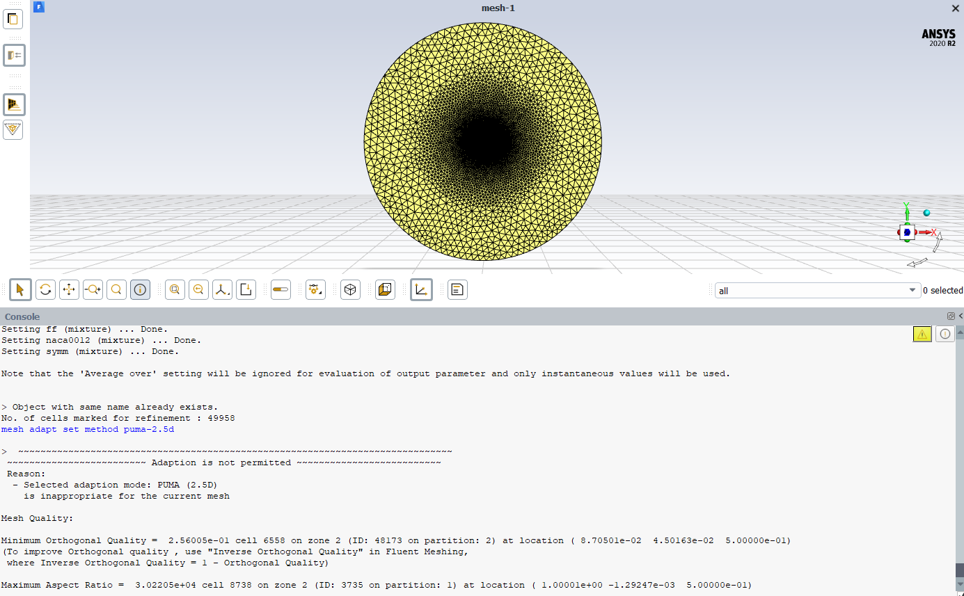

I was using 2D but I ran into a couple of issues. There were these non-physical oscillations present in the solution that I couldn’t explain. I asked about them here (/forum/forums/topic/wild-oscillations-in-cp-and-cf/) but to no reasonable answer. At which point I was told to switch over to PUMA since it is more robust. I also keep getting a notification that hanging node adaption for 2D will be phased out and that I should switch to PUMA 2.5D.
As for mesh quality, it’s a poor mesh and I’ve done this intentionally, to evaluate the improvement in grid + solution after adaption. Does the mesh quality affect why PUMA 2.5D doesn’t work though? This is what I get when I evaluate mesh quality:
Minimum Orthogonal Quality = 5.24949e-01 cell 69 on zone 2 (ID: 37 on partition: 19) at location (-1.86587e-02 1.40334e-01 -1.22467e-03)
Maximum Aspect Ratio = 3.12470e+04 cell 38 on zone 2 (ID: 388 on partition: 5) at location ( 5.54834e-01 7.61255e-02 -6.64337e-04)Â

Forum ModeratorI wonder if the high aspect ratio is causing a problem. When the cell is split the aspect ratio will increase by about a factor of 4, and that's potentially going to mean the cell centre can't be accurately placed in the mesh. Â

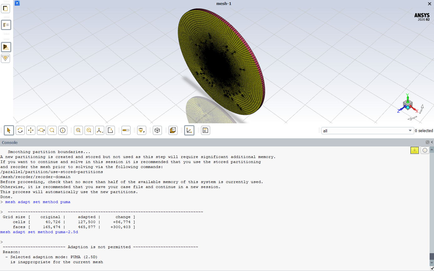

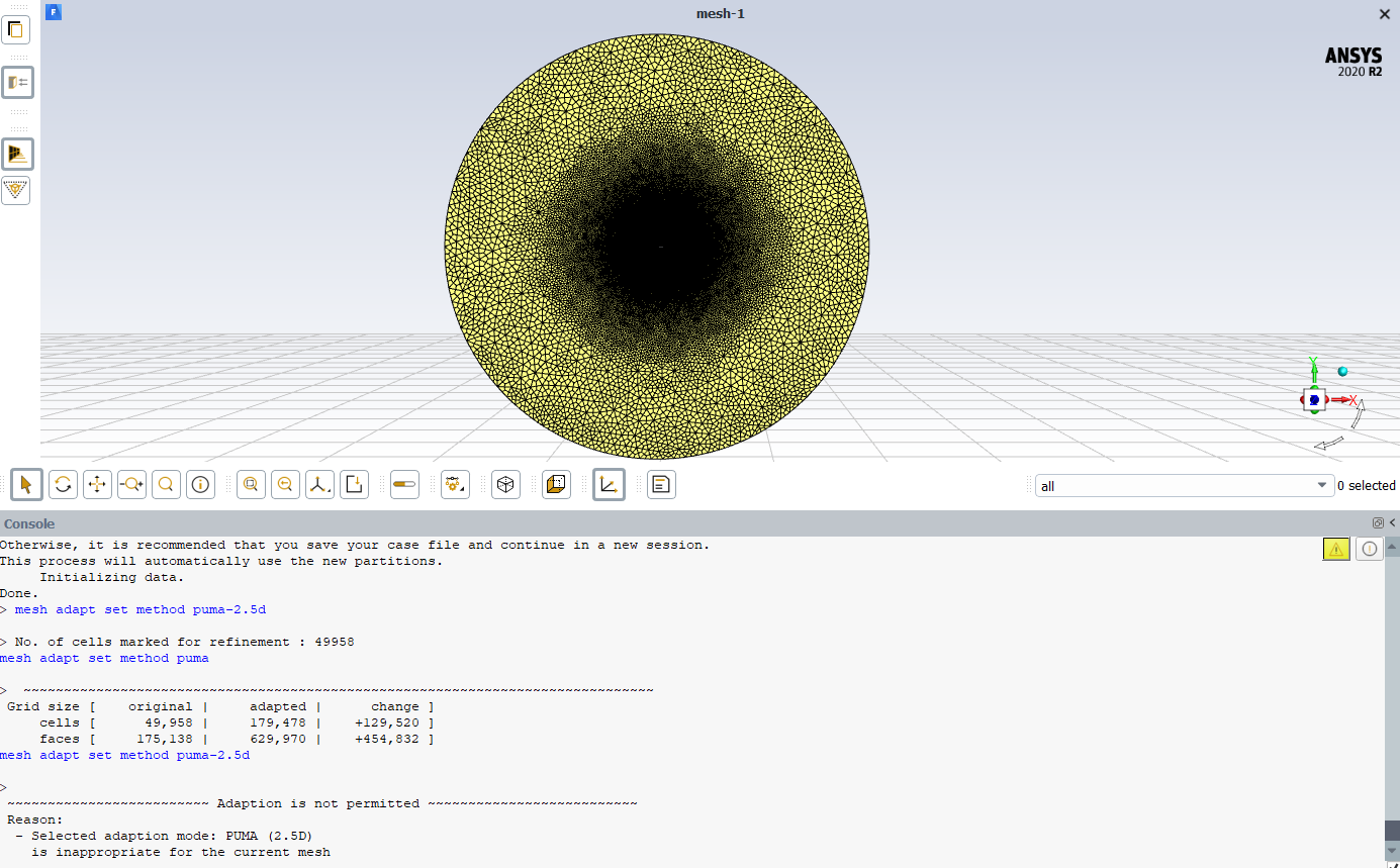

Image 1) I tried a much finer mesh and I get the same error.
Image 2) I converted the domain to polyhedra cells (against Fluent's recommendation) and I get the same error.
Image 3) I made it so there's only tetrahedrals (inviscid, no high aspect ratio boundary layer cells) and I get the same error.
Image 4) I converted tets-only grid to polyhedral cells and I get the same error.
