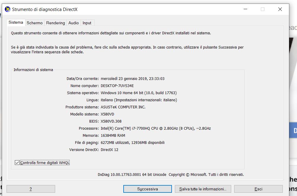

I am writing because Fluent 19.2, installed on my laptop, is not starting at all. Whenever I launch it, either from workbench or standalone, I get for one second the blackscreen shown in the screenshot and then nothing happens (took me 4-5 attempts also to take the picture
). I can successfully launch it from the command prompt as suggested in several posts, such as /forum/forums/topic/fluent-doesnt-start-at-all/.Â
In the above link it is suggested to rearrange the order of the environmental variables, but just in case, no idea how to do it: all I know is how to edit/create them.Â
Thank you very much if you can help me out! (No I won't go for CFX, I need Fluent for the ROM Builder in Workbench. Also, polyhedra meshes are cute)

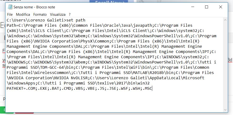

Please open up CMD Prompt, then issue the following command
set path
and post the output of it here.

Ansys Employeeok your Path looks very similar to the original Path in that thread. So, you may have the same issue as that thread. Try rearranging the Path as described in that thread. Here is how to do it , https://www.java.com/en/download/help/path.xml
Make sure you make a copy of the original value before making any change.
If this doesn't help, please resend the output of the 'path'
Thanks,
Win

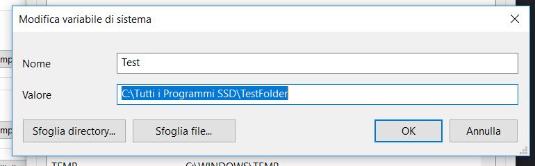

SubscriberYes i am aware of that way to edit the variables but i don't see how it should affect the path "order", actually, in that sort of windows GUI they are just shown in alphabetical order. Some of the variables shown in the set path definitely don't appear in that menu. The gui itself is also really reductive, it just allows me to open the folder/file specified.

Ansys Employeeyou are supposed to 'modify' the Variable named 'Path' , not creating a new Variable.

Ansys Employeeif you look at the 'value' , you will see that it's a list of different directories separated by semi-colon ';'Â , you must moveÂ
C:Windowssystem32;C:Windows;C:Windowssystem32Wbem;C:Windowssystem32WindowsPowerShellv1.0;
to the front of the list.

SubscriberAh i see what you mean, there are some variable names containing multiple addresses, not just one
I will try soon -
