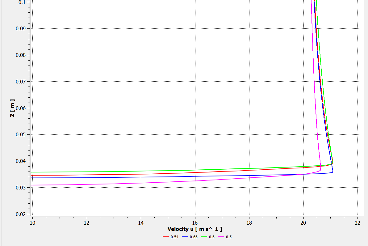

I am still pretty new to ANSYS and the forum so my apologies if this is not the right place to ask. I am simulating flow over an airship and I need to locate where the flow transitions from laminar to turbulent flow. To find the point where it transitions, I am plotting velocity profiles at multiple points over the airship using CFD-Post. The velocity profile chart demonstrates that the flow is transitioning from turbulent to laminar, which I think to be inaccurate. I am using the k-ω SST transition model and the flow is flowing towards the -x direction.

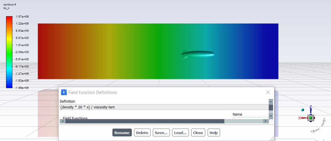

SubscriberHi I tried using Reynolds initially but when I calculated it and displayed the contour I get this. I am showing both the formula I used and the contour. As you can see the Reynolds Number from the start of the flow is negative 10^6. which is confusing.

Forum ModeratorYou're plotting a function of the x-coordinate so Re will vary over the domain by position as well as everything else.

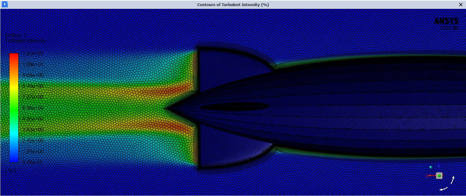

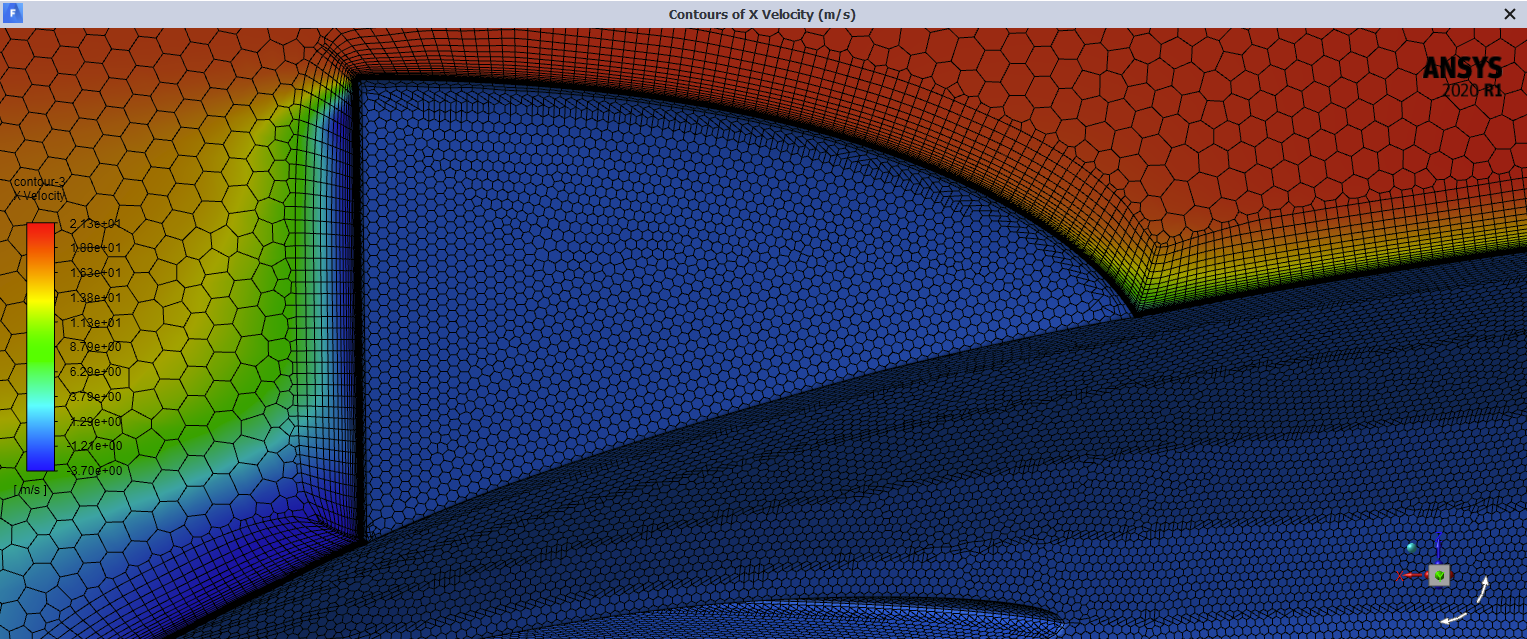

Cell quality is OK. How well resolved is the boundary layer, streamwise on the blimp and flow in the wake region?
April 19, 2022 at 2:19 pmApril 19, 2022 at 4:16 pmRob
Forum ModeratorPossibly. By refined I mean are you picking up the flow gradients. Everyone reads about y+ and religiously applies the "rule" then forgets to refine the far field. The jump from the top layer of inflation to the poly mesh is a little large, but not excessive.
How does the above look with the velocity contour plotted?
If you're looking for when the boundary layer "trips" to turbulence you may need one of the turbulence transition models, and then monitor k and/or epsilon/omega. It's really not my field (I don't do aeroplanes) so you may need to do some reading. Nearest I got was working with some sports scans prior to the swimsuit simulation work https://www.theengineer.co.uk/speedo-uses-ansys-simulation-to-develop-racing-swimwear/

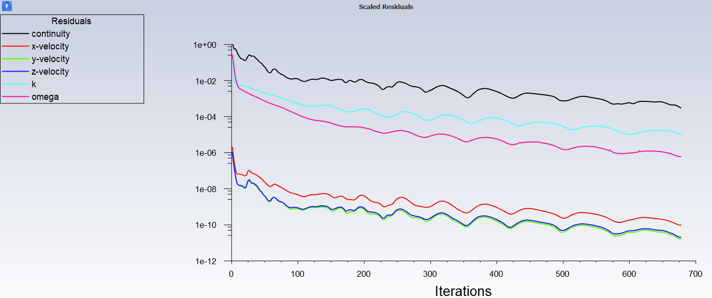

April 20, 2022 at 7:18 pmApril 21, 2022 at 10:54 amRob
Forum ModeratorThe residuals are a function of the total error in the solver, as such they're used to see if the solution has converged, but are otherwise useless. What you're looking for are monitors. If you plot k and w (separately) on the blimp surface does it show anything?
