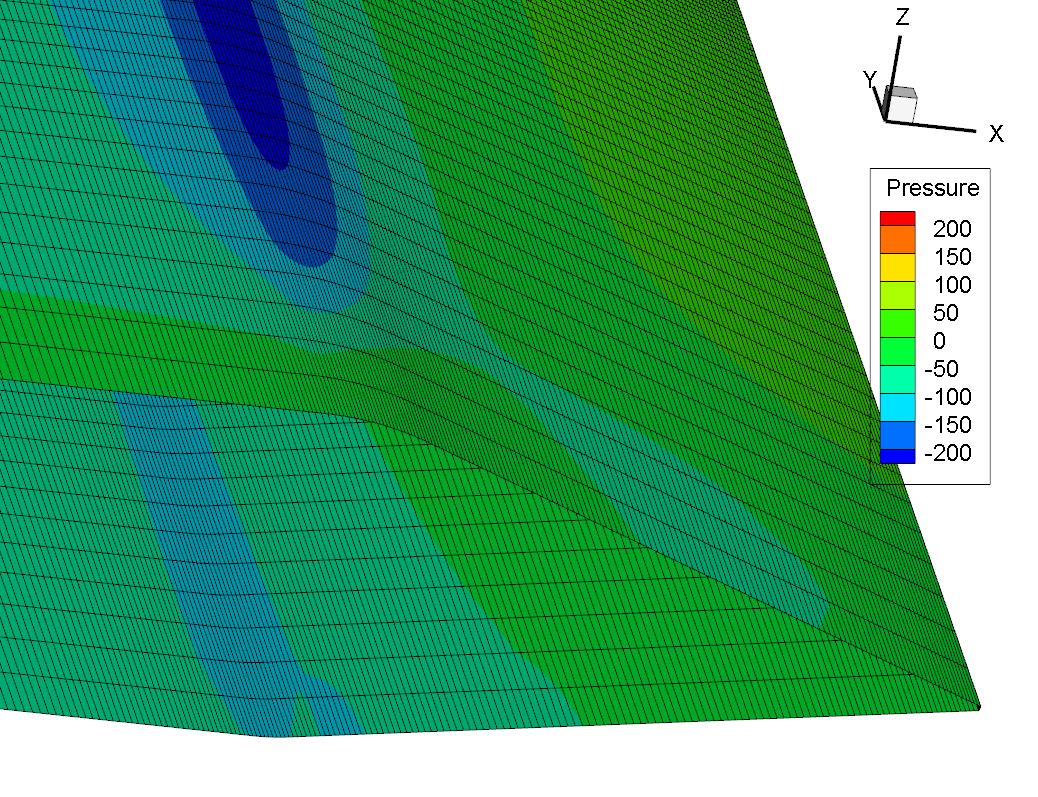

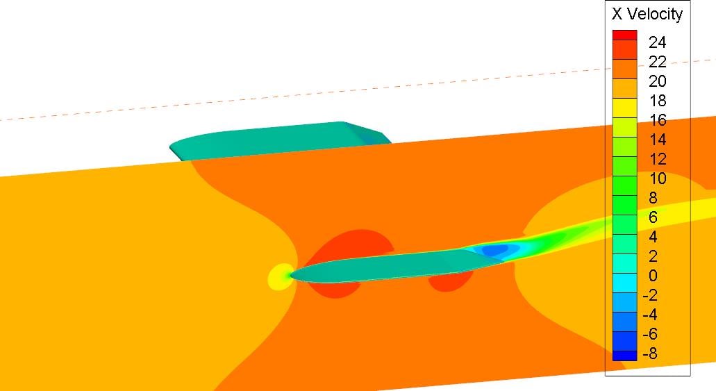

      I want to simulate a wing in a wind tunnel test section. I am using the coupled pressure based solver in Fluent with a pseudo transient time step. The wind tunnel walls are set as free slip walls by specifying a zero shear force at the wall. I know from wind tunnel experiments that the flow does not separate over the flap. However, this is not what happens at the free slip walls in the CFD simulations. The flow stays attached over the flap away from the wall, but at the wall it separates, which makes no sense to me.
      Does someone have an idea why this happens?
      I checked the y+ value at the free slip walls, which I think should be zero. However, the second image shows that it is not zero, although the shear force at the wall really is zero.

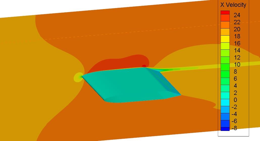

      Can you plot a couple of planes showing the velocity at different wing positions parallel to the wall?  Ie similar to the images above but at different y planes.  Also check your mesh at the wing root.
    • sbolk
      Here are slices parallel to the wall, at 0.5, 0.25, 0.1, and 0.01 span. It seems like the flow separation extends to around 10% of the span.

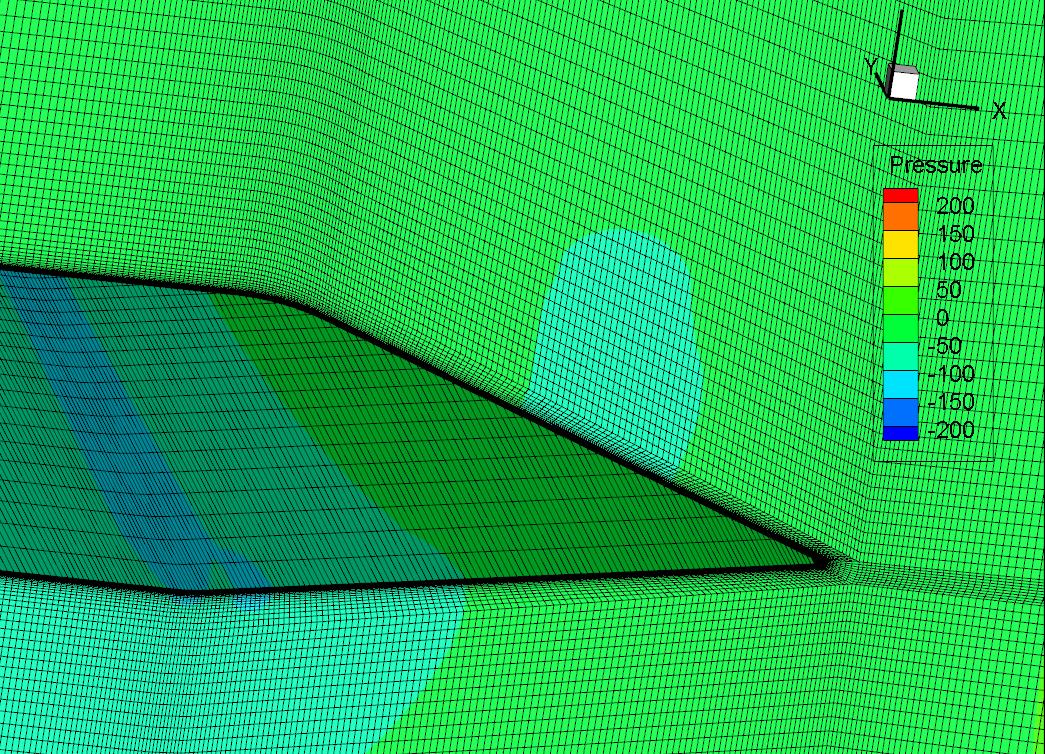

      I don't see any major issues with the mesh. In spanwise direction, it is not so much refined since I shouldn't have a boundary layer at the free slip wall. The first cells at the root have a width of approximately 2.5% of the span. However due to the inflation layer of the wing they are quite thin and have a rather large aspect ratio in the order of 10^3. (Also, the mesh gets finer away from the wall, because later on I will have a propeller in the middle of the wing)

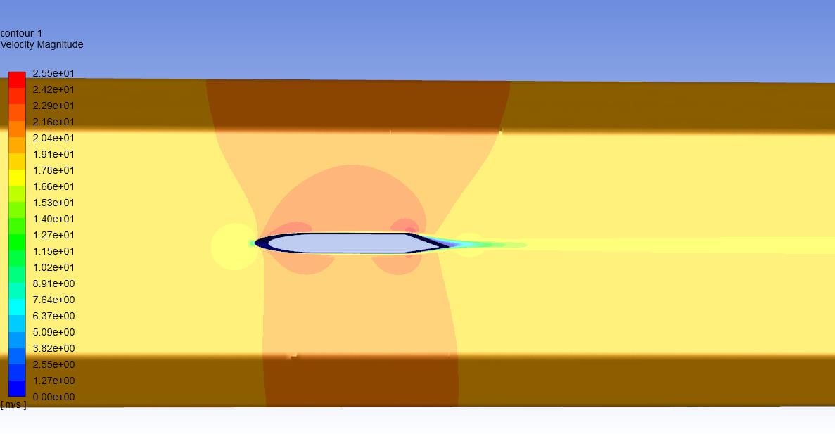

      Like this? This is the velocity magnitude on the wind tunnel walls, looking in the y-direction. The y+ is zero at the wall now.
