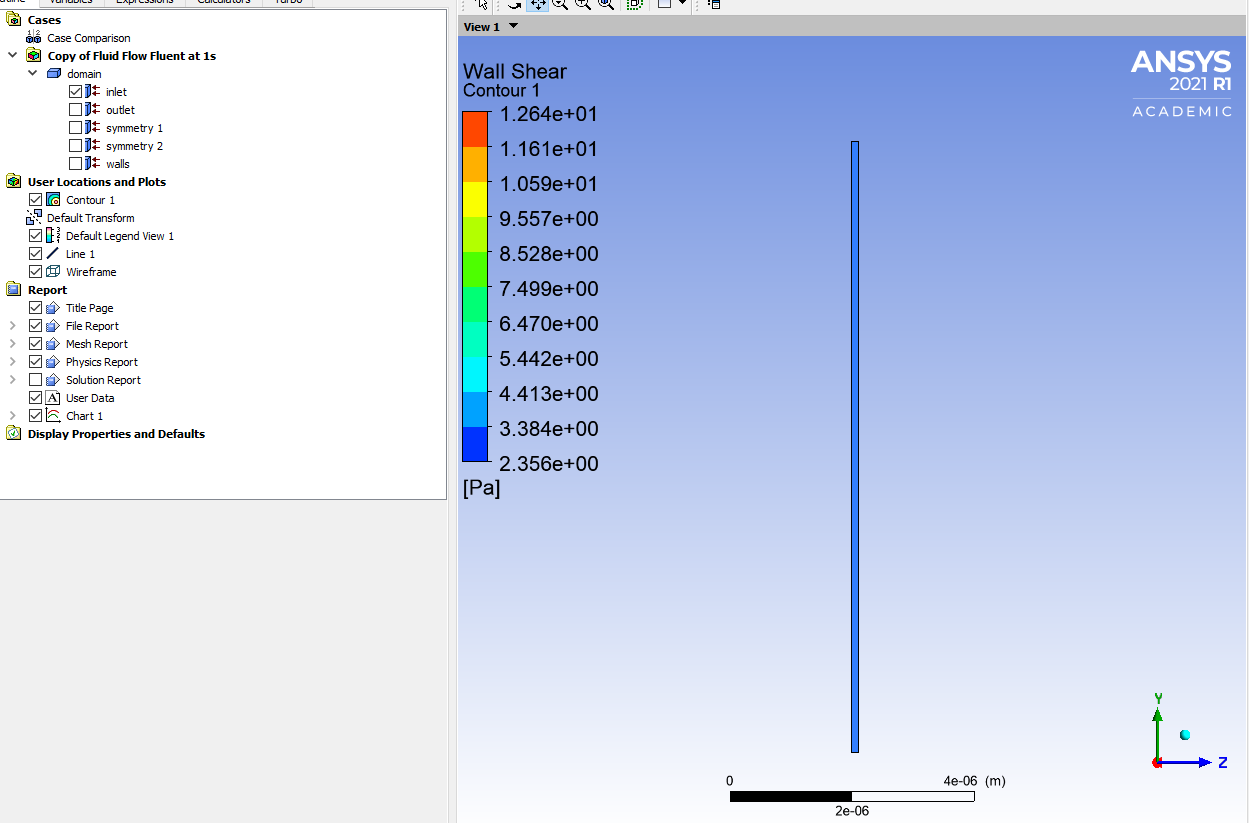

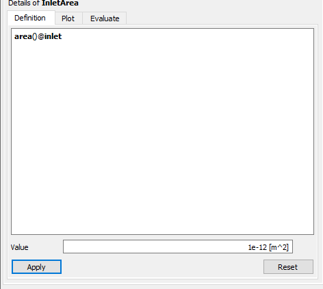

      I made sure I am selecting the right inlet again in fluent and it is displaying the correct dimensions as in image 1. The distance between the walls is 10um and I am using a reference depth of 1500 um so the area should be 1.5e-8 m^2. In cfd-post the same area is displayed as 1e-12 m^2 in image 2. I thought maybe cfd-post didn't pick the reference depth from fluent but if that is the case then the area should have been 1e-5 m^2 with the default 1m depth. I am not sure why, but it seems like there is a thin depth in the y-z plane that cfd-post added which is causing the wrong area (see image 3) but I am sure my geometry is only a rectangle and the analysis type is 2D. Any idea on what is happening?
      • NickFL
        CFD Post is the traditional post-processor for the CFX solver. CFX only allows "pseudo" 2D models (one through cell). Because of that, the 2D Fluent results have to be adapted to be read by the 3D CFD Post and that sometimes leads to these weird artifacts.
        As for the changing reference depth in Fluent from 1 [m], I would be very careful about doing that. In earlier versions, there were known complications that arose when this was changed off the 1 [m]. Unless you have a reason to change it, leave it alone.
