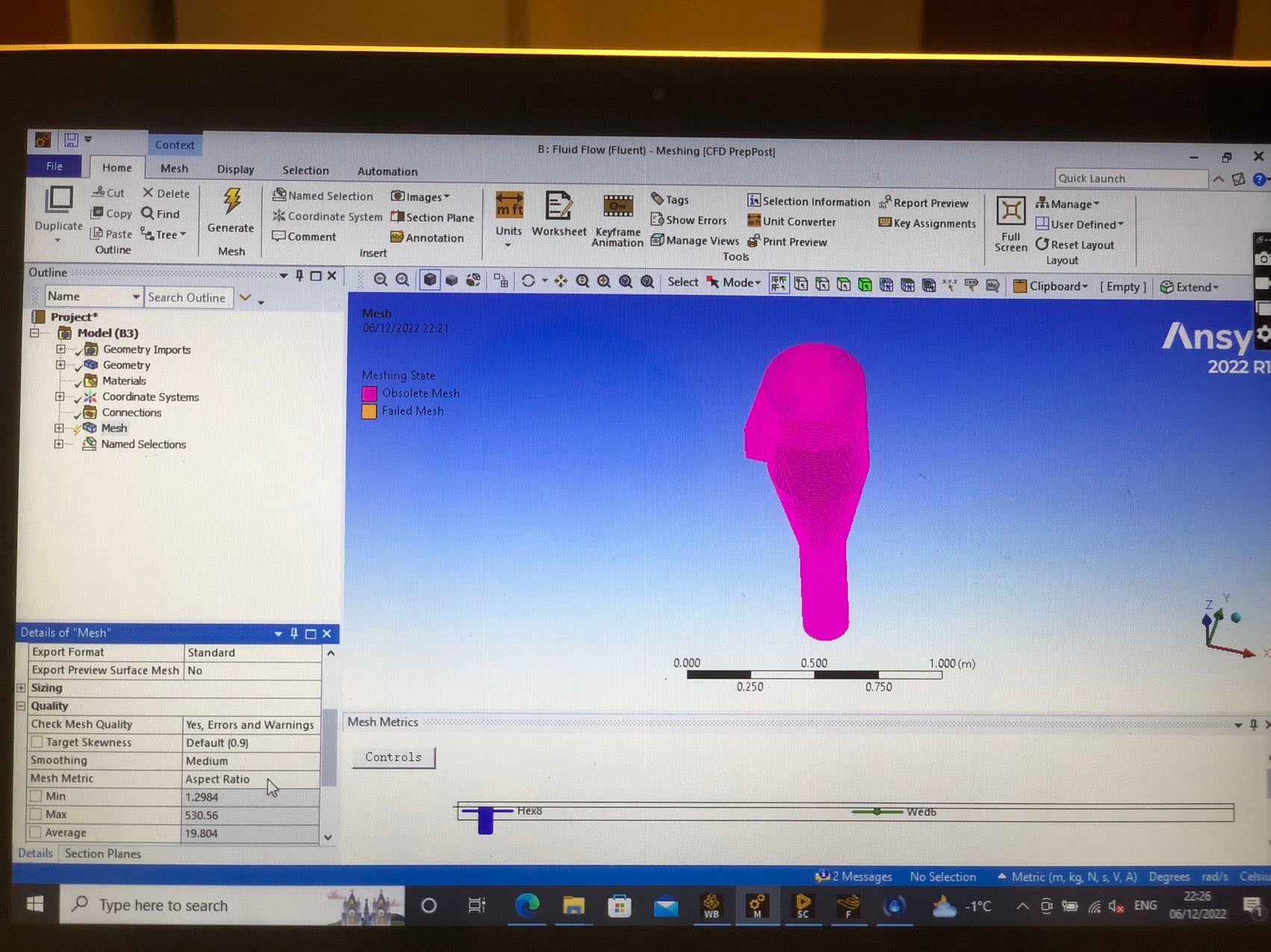

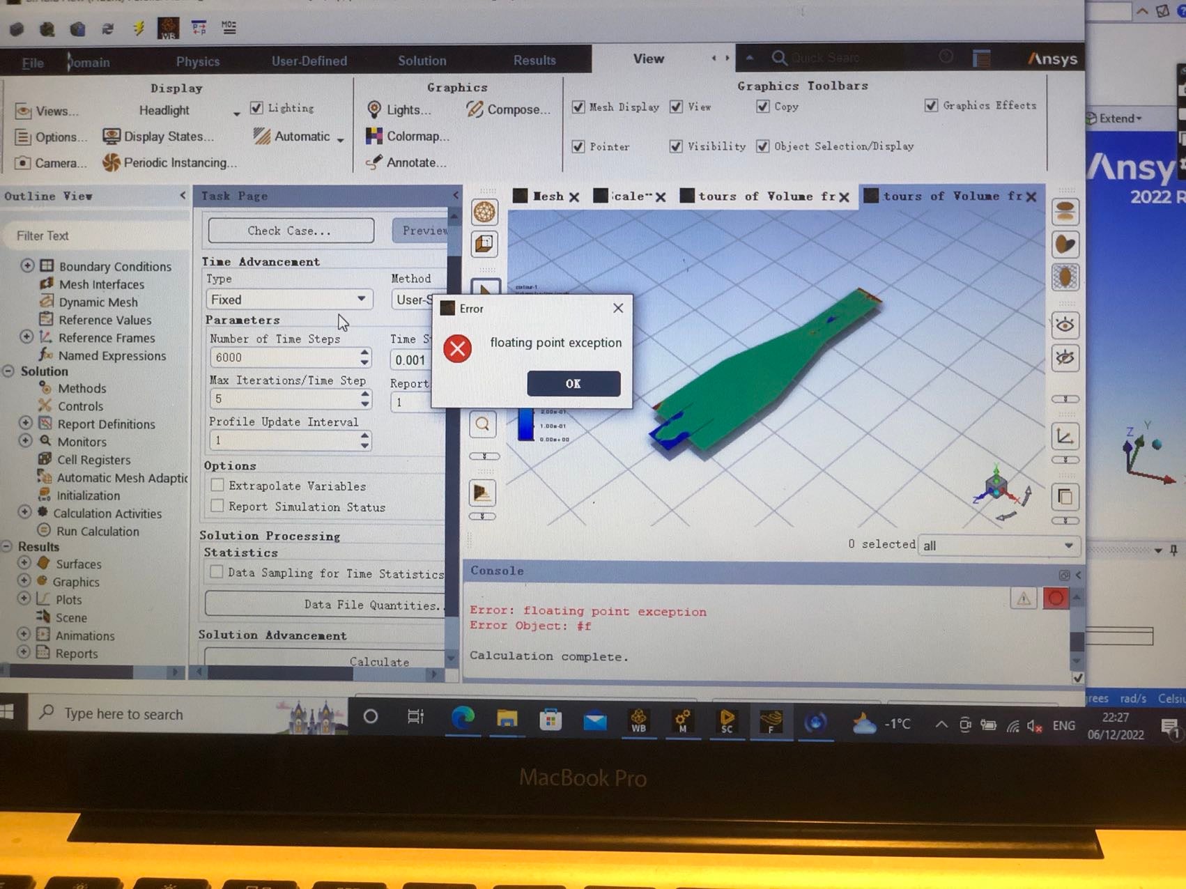

SubscriberHello everyone, excuse me I'm having an «error object... floating point exception » issue with my calculations and I don't know how to fix it.Â
The calculation process goes on for a couple of minutes (about 10) then it stops and I get that message.Â
I'm simulating a fluid flow (oil and gas separation in a cyclone) using ANSYS Fluent.Â
Thanks for answeringÂ
